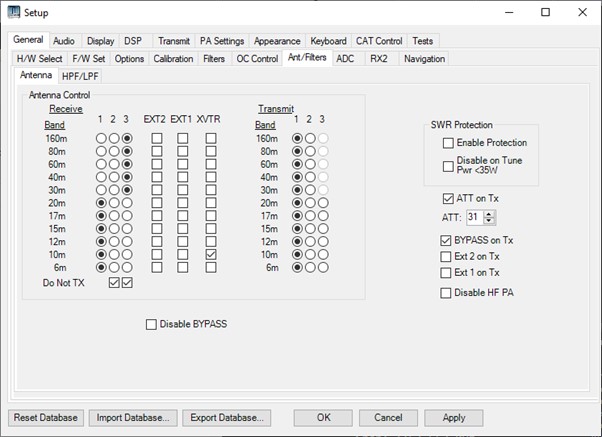

Now I have my 70 MHz Ukrainian Transverter built and boxed. So far RX is not working, but I have TX output. The board is well built, but the main problem is with interfacing since there are no RF connectors attached to the board and the output pins are very small and difficult to make soldered connections.
Questions for ANAN transverter users:
1. What are your settings to avoid 28MHz TX at same time as XVTR TX output. I cannot find the right settings. I have set up XVTR window with 'XVTR RF TX' and 'Disable TX ticked'. Also 'Disable HF PA' ticked under Ant/Filters. But I still have RF out from the main antenna socket as well as from the XVTR TX. Is this a firmware or Thetis bug as I have seen others reporting similar observations?
2. On XVTR RX (I am using separate TX and RX) I have no 70MHz signals but there is some 'noise' from the transverter. Again, would appreciate settings that others have used successfully
3. I have 'Out of Band' in Thetis on 70MHz, not sure why? I think Tony EI7BMB had this problem as well.
I have not done any detailed measurements on the TX quality except to see that I can easily achieve 1-2 W output and that there is a significant 2nd harmonic detectable on 140MHz. I don't have a spectrum analyser, so can't say more than that at this stage. I have a 70MHz linear amp built, and it is possible that the filtering on that will give me a clean enough signal. No IMD measurements yet but looking at CW/datamodes initially (not SSB/FM where IMD is more important)).
Any help/advice welcome.

Re: Ukrainian transverters- anyone tried with ANAN radio?
Hi Dave,
please take a look at my settings:
viewtopic.php?f=36&t=3097&p=7615&hilit=transverter+dl4zbg#p7615
Don't forget the checkbox "XVRT" ! Without this one checked reception is "zero"
"Out of band": change your region settings to "extended"
Volker
HI Volker
Thanks. My settings on XVTR tab are the same as yours. My 200D has slightly different settings on the Ant/Filters page as below but I believe with the same effect as yours.
I am beginning to wonder if the 4m band has any activity! Usually I would al least expect some local FM but all I see are what look like spurious peaks. I also swapped the transverter RX to the main 200D ANT1 input and this gave the same results. So, at this stage I'm not sure if it is the transverter or my settings or just no signals on the band.
Regarding 'extended' I already had this checked.
The main PA TX (which should be disabled) does not give full output, it is about 10% of normal power, so there is a partial effect of the PA disable setting. I can drive the transverter by having an antenna or dummy load connected to the main TX, but this doesn't seem right...
A bit frustrating, but I'll keep going.
Hi Dave !
I had the same issue with my 200D. You must install protocol 2 firmware : Orion_NP_v1.9_pre3metis.rbf. Previous versions did NOT work properly. This last version implements PA disable function correctly. To be downloaded on Github.
73s. Phil FM5GB
Hi Phil
Where did you find the download for Orion_NP_v1.9_pre3metis.rbf? I am on v1.8. I can't see at the usual download location on Github. Is it a special version? Can you send me a copy if you have it?
I have the transverter working well now with just two problems. Firstly the unwanted TX on 28MHz and secondly some 100Hz spurs which appear to come from my 12V PSU.
Not sure where "pre3" is at, but all other versions can be located here: viewtopic.php?f=32&t=3309
Sorry Dave,
the last version of firmware for your 200D is Metis_Orion_NP_v1.9_pre4.rbf which you may download from
Scott's link.
Please tell us it works for your setup.
73s Phil FM5GB
Scott's link.
73s Phil FM5GB
Perfect! Thank you Phil and Scott. Now I have full TX inhibit. I don't know how I missed this firmware update. I've been using v1.8 for a long time.
