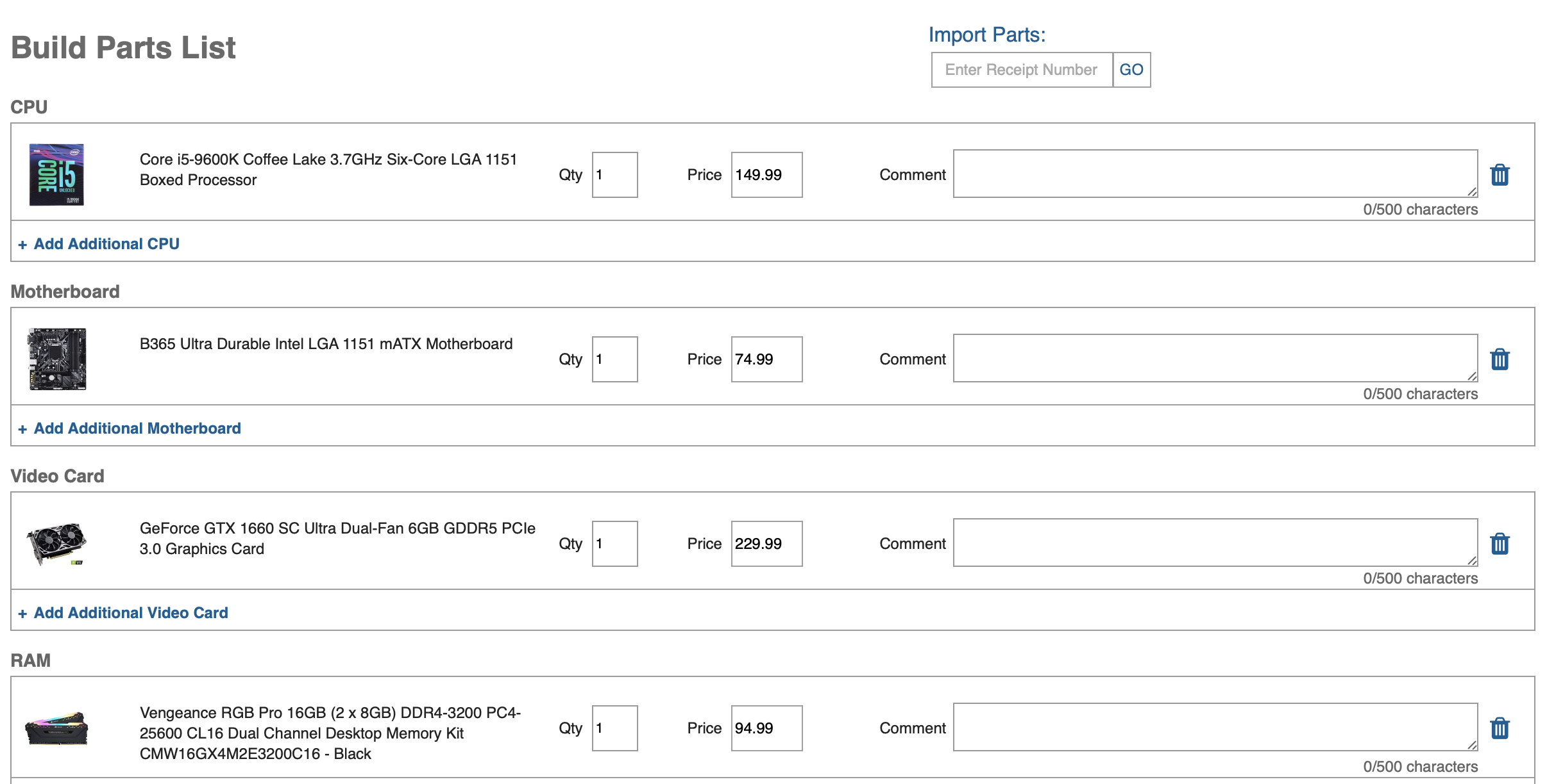

Re: PC Upgrade Feedback
What are your thoughts about this proposed PC upgrade? In particular, I'm wondering about the graphics card as compared to the GTX 1060. And, the motherboard is pretty basic. Do I need a more robust MB? This build is exclusively for the Anan, audio tools, and logging software. Should I go for the i7 processor?
- Build Sheet.png (303.97 KiB) Viewed 34312 times
That graphics card is overkill.
I still recommend an eight core processor for any new build.

Ah yes, I see that now. I misread your previous post and went looking for a 6 core processor. Is there a list posted somewhere of graphics cards that we know will perform well? I keep reading and hearing about the GTX 1060 series. But, that appears to be circa 2016 technology. What are the equivalent models to consider today? What is a CUDA core? Some graphics cards have them and others don't. I hear users on the air talking about the number of cores that they have. But, I don't know what it means in relation to this Anan PC build.
