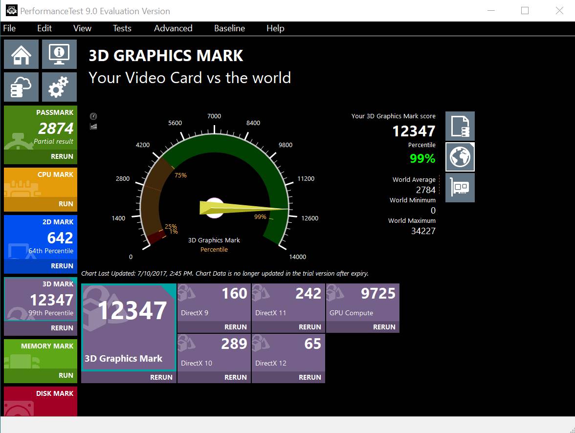

Postby WA0VY » Wed Mar 28, 2018 8:18 pm
My Club3d display port DP 1.4 13 ft. cables arrived about a few hours ago and I have tested them at DP 1.2, 4k @ 60Hz for awhile now. There are no more black screens or artifacts. I then tested them by adding a Tripp Lite P579-006 M/F 6 ft. extension cable at the monitor end and everything continues to work perfectly with 4k @ 60Hz. That's a 19 ft. cable run which can be problematic itself. The Tripp Lite cable is only a DP 1.2 cable and is not rated for 4k resolution. Yet, I'm having no problems whatsoever. As I previously mentioned, the reviews on the Star Tech cables I was using were somewhat icky and many noted black screens, glitches, etc. So, there is a little bit of everything here: the Club cables lived up to their rating; the Tripp Lite extensions exceeded their rating; the Star Tech cables now reside in my electronics recycling bin; and my HPSDR panadapter is no longer jumpy at 60 fps/16 ms update period. It was a cable issue after all.
I thought, just maybe, that my graphics Passmark score would be favorably affected, but NO!
ScreenShot 61.jpg (100.03 KiB) Viewed 56608 times
While those are not awful scores, particularly the 3d score, the card is a GTX 1080ti and is bench marking quite low on the 2d mark and in the ballpark of a regular 1080 on the 3d score, and it always has. So, that's the next issue to solve. As Roseanne Roseannadanna said, "If it isn't one thing, its another!"
73 Brent WA0VY
