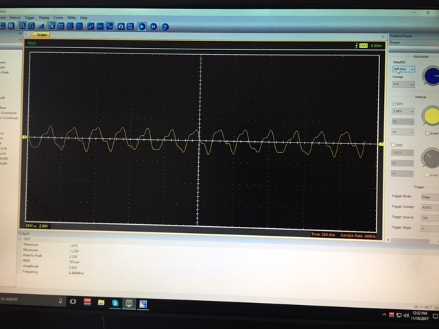

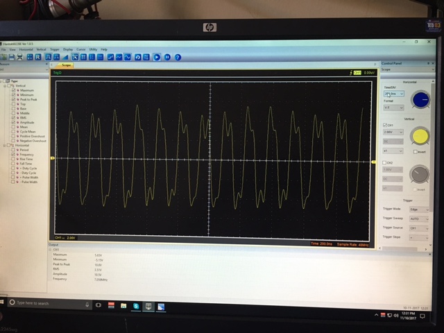

I have measured the signals at 20m and looks as if it is better than 1MHz. Please have a look into my below video post.

It does not look better at 20MHz, your scope is merely undersampling the waveform.

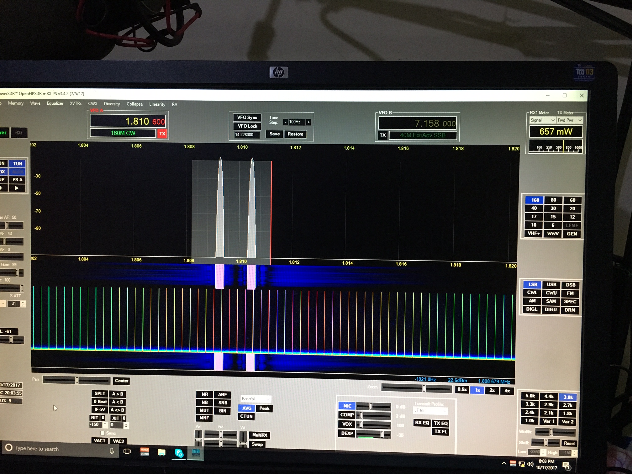

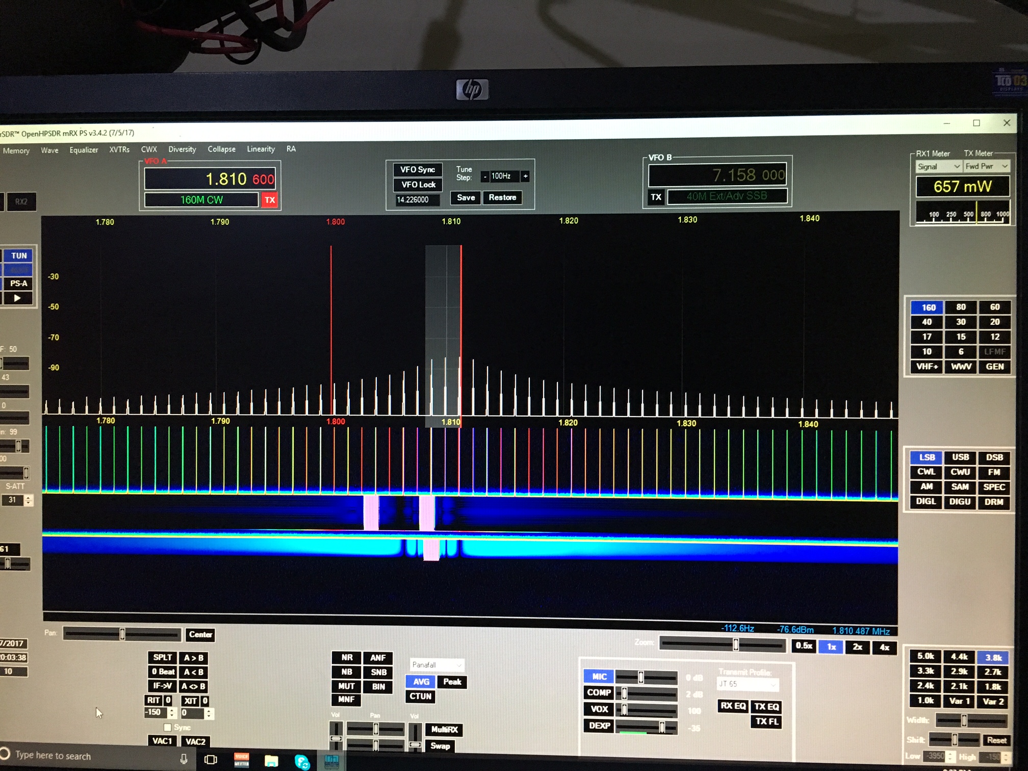

Please have a look at the Two tone test screen shots with and without DUP on.

Still looks broken. Exhausted my ability to figure out what that is, though. Still something to do with the FPGA/DAC.

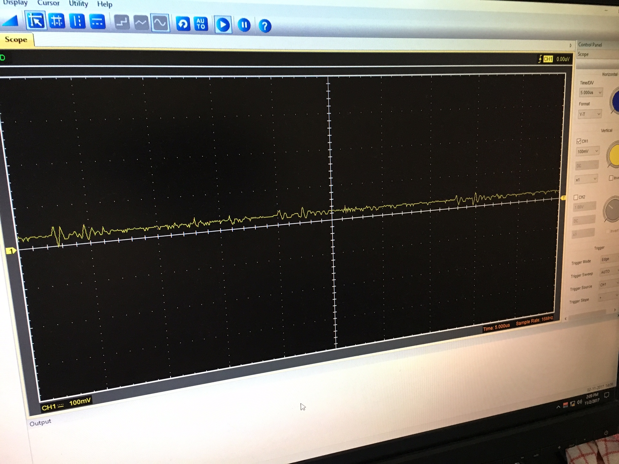

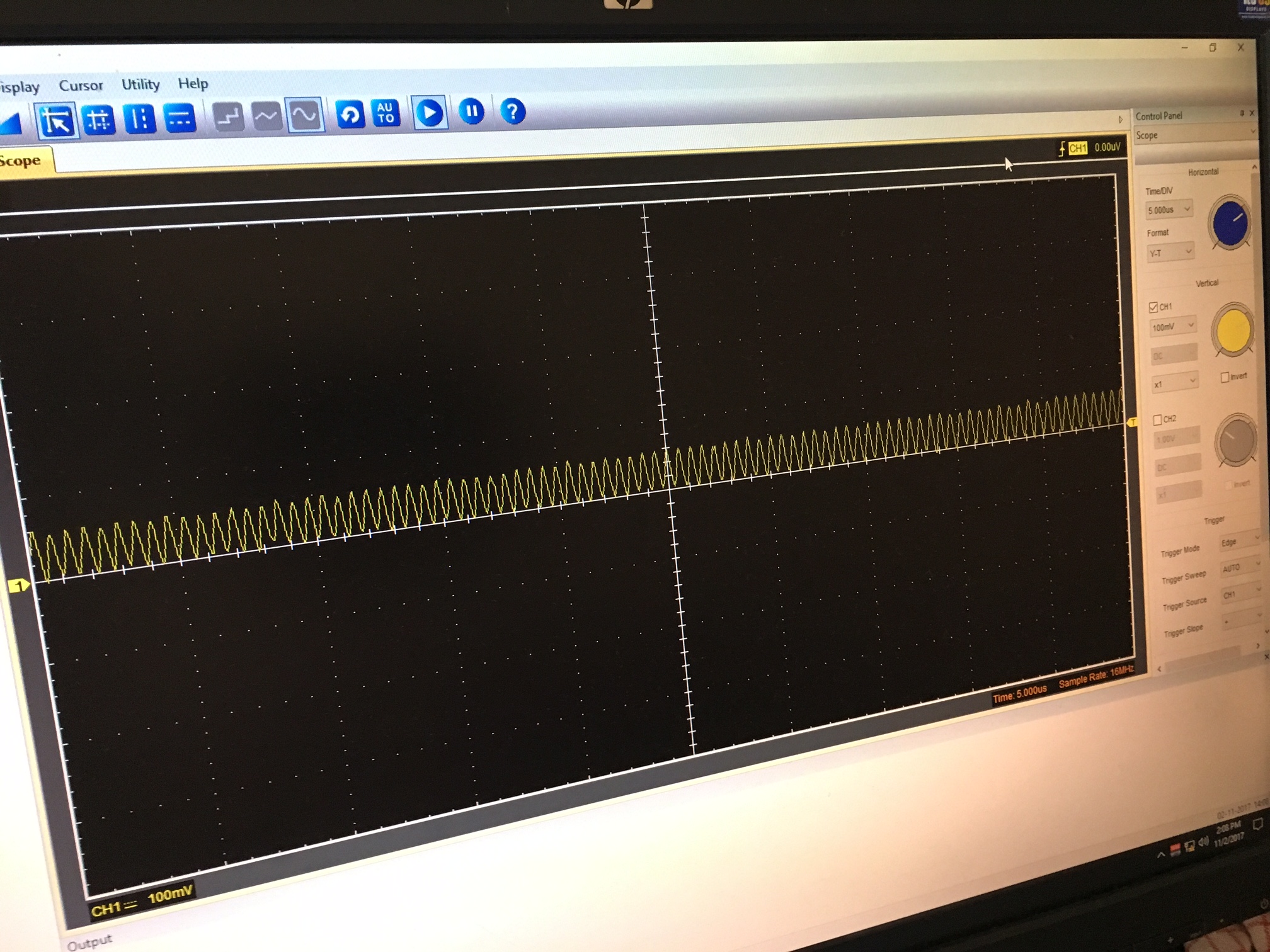

Alsohave a look at the screen shots with
1. Driver PA out with Tine on 40 m Band. PA connected to dummy load. My Driver PA use 2 nos IRF530 Mosfet in Pushpull. As per vendor recommentation Gate bias set at 2.7V. PA powered from 13.8V.
2. PA in signal
3. PA in signal when PA power is disconnected.
So I can see when PA is powered ON , the sine wave loose shape as seen. Is it normal or else some issue with PA ?
2. PA in signal

Why your display looks the way it does and how to adjust it:
https://apache-labs.com/community/viewtopic.php?f=6&t=2545
Your amplifier looks broken to me. I've never built one myself so I am not equipped to debug it. However, if I had to guess, it looks like there is an impedance mismatch on the input, and that you are over driving the hell out of it. What happens if you put a 3 or 6 dB attenuator in between the Hermes and the amp?

As per description given vy vendor this amp is designed to deliver 70W with an input max 5 watts !
So our hermes can over drive it ?

Re: Hermes Homebrew Fault Finding
Prem,
I don't know. It's just a wild guess from looking at the waveform.
I'm sorry that I have no experience with these amplifier kits.
