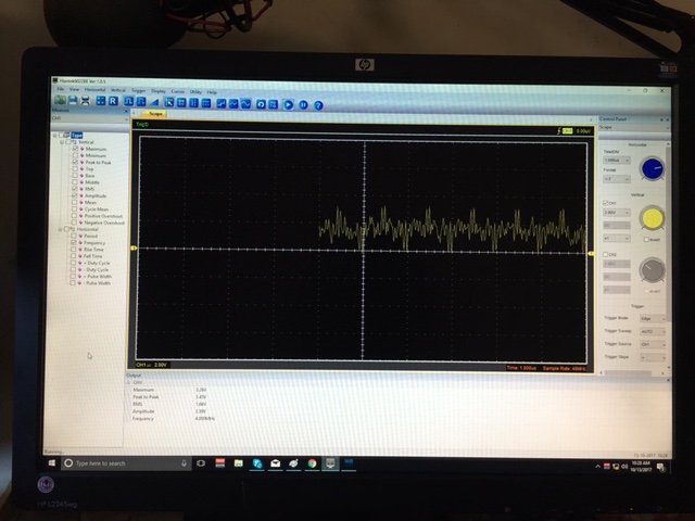

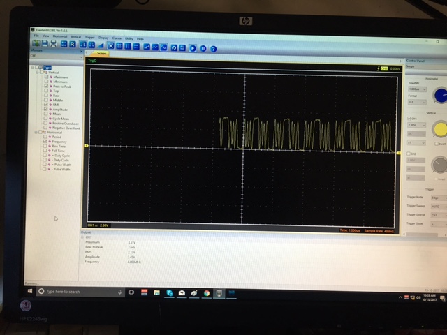

A 20MHz Hantek is plenty fine for looking at your RF output signal. Set PowerSDR to the "Extended" region and you can transmit on any frequency you wish. Set your VFO to 1MHz, use TUN to look at the output. You might also look at Two-Tone as well.
Re: Hermes Homebrew Fault Finding
Please note that the faulty FWD S meter reading disappear when I disable MIC button .in PSDR.
I have sent three short video screen capture for my scope screen. Please review and advise me further.
73s
Prem, A65BK
73s
Prem, A65BK

It is most unfortunate that you did not post the videos here for all to appreciate. You could have used Youtube to publish them.
First, and most important, a mic level of -70dB is completely normal for the output of the CODEC with no microphone plugged in. This degrades a few dB when the 20dB boost setting is active. Since you already reported that MON sounds fine coming out of the radio speaker/headphone jack, this is just more evidence that rules out the CODEC as the source of any problems you may be experiencing. The noise level is fine, and since MON sounds fine, that means both sides of the CODEC are working properly.
It is also unfortunate that you did not embrace my guidance to put the radio region setting to "Extended" and use a 1MHz output. Given the low bandwidth of your scope, it is impossible judge the quality of the sine wave (we hope it's a sine wave) coming out of the Hermes using TUN at 14MHz.
I'd recommend you repeat the experiment at 1MHz. Assuming you have at least a half watt rated dummy load (resistor), adjust your output drive level to 250mW, that should represent approx. 5V peak on the oscilloscope (with the scope input in a high impedance setting, not 50 Ohms). Then adjust your timebase to 100nS per division. This should then show 1 entire RF cycle on the oscilloscope display. With those settings you can judge whether or not the RF output looks reasonably proper in the time domain (is a well-formed sine wave).
If you have an appropriate attenuator or coupler, you can also feed the TX output back into the RX input and, with DUP mode turned on, use the radio itself as a spectrum analyzer to look at the spectral purity of your own TUN transmission. At 250mW, or +24dBm, 60dB of attenuation would be sufficient to knock that signal down to around -36dBm, which is S9+37. A large signal, but well within the capability of the radio.
If the TUN signal looks good in the time and frequency domains then obviously we have to look elsewhere than the DAC or amp for the problem.

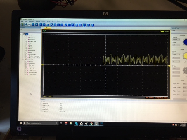

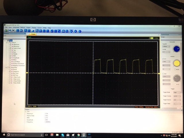

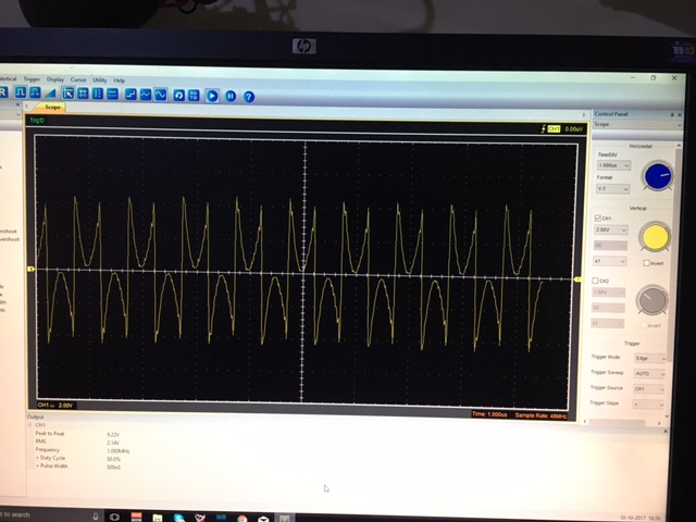

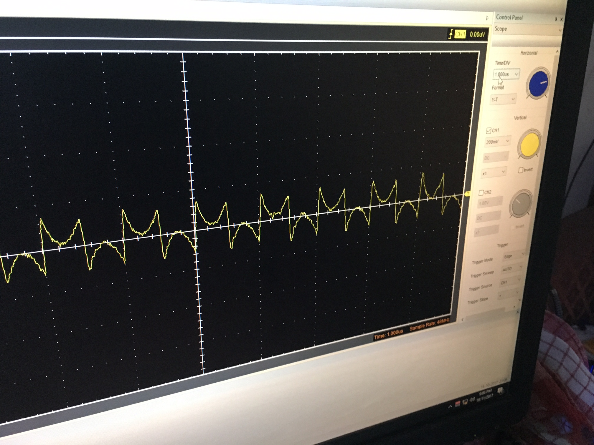

I have repeated the test on 1 Mhz and posting three pics here. This time I did not do any video. I am really disappointed to see my waveform. I don't know If I ado anything wrong way !!

- Two tone .JPG (838.24 KiB) Viewed 36422 times
- Tune .JPG (96.15 KiB) Viewed 36422 times
- Mox without Mic plugged .JPG (862.58 KiB) Viewed 36422 times

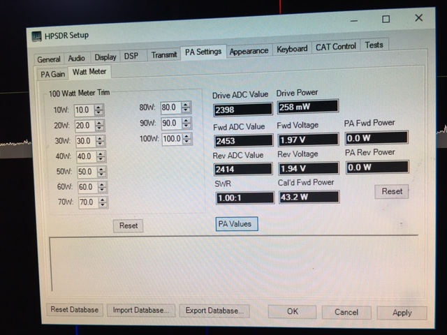

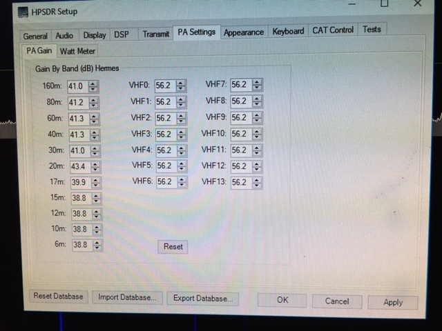

I am posting Pic to show my PA gain settings .
Please note that even though the Mic S meter reading is ok without Mic, I can see FWD Power S meter reading which vary from 0 to say 250mW , when I move MIC gain or Drive slider !!

- 20 m band.JPG (88.45 KiB) Viewed 36413 times
- Wattmeter].JPG (114.16 KiB) Viewed 36422 times
- PA setting .JPG (119.29 KiB) Viewed 36422 times

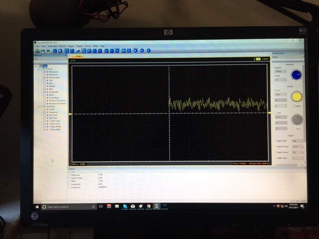

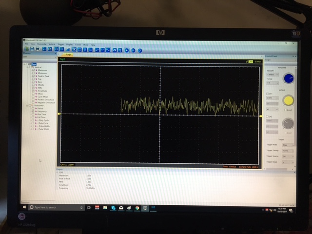

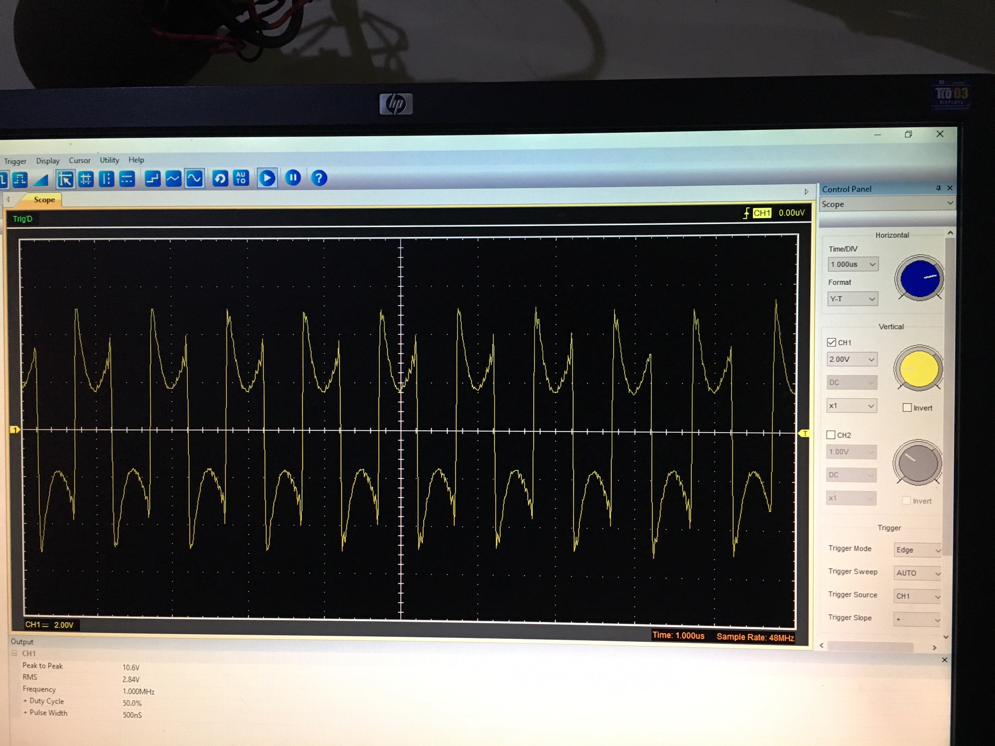

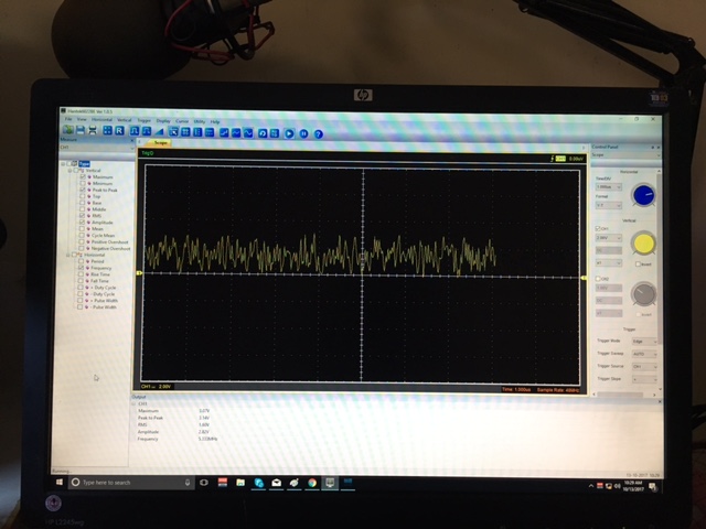

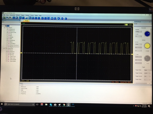

Well, Prem, as they said in Apollo 13, "Houston, we have a problem!" I pretty much thought this would be the case, and look how easy and handy that scope was to find it to be true.
We don't care about two-tone or about MOX or CODECs or any of that stuff anymore until you can find the problem that is causing that non-sine wave output when you invoke TUN.
The next debug step is to take a look with the scope right at the analog output of the DAC, or as close as you can get to it. The easiest place is probably at the input to the RLP-40 low pass filter, Pin 2 of FL1 if I'm using the correct schematic. This is on the output side of the DAC output transformer and will be easier to probe then the differential outputs of the DAC. Again, use TUN at 250mW. If the waveform still looks the same at the input to the first LPF, then you've got it narrowed down to the DAC or transformer. If the waveform doesn't look the same at that point in the circuit (same shape, not same amplitude) post what it does look like.
However, assuming it still looks the same, the next debug step after that is to reduce your drive level down to just a few milliwatts. If the shape you see there persists with TUN, and I think it will, then I'm guessing you somehow soldered it together in a way that's got a couple of DAC data bits swapped or shorted, either at the FPGA pins or at the DAC pins, or both. If the waveform doesn't persist then post what it does look like when you drop the drive level.
If you continue to get the results I think you are going to, you will likely need to do a close inspection of your soldering of the DAC data lines at both the FPGA and DAC pins under high magnification, and perhaps the DAC output transformer as well.

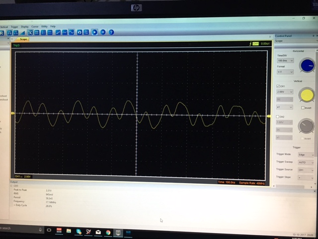

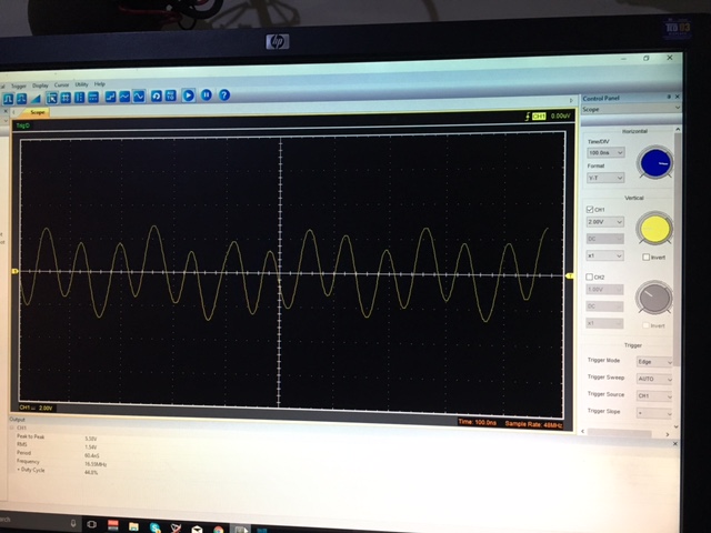

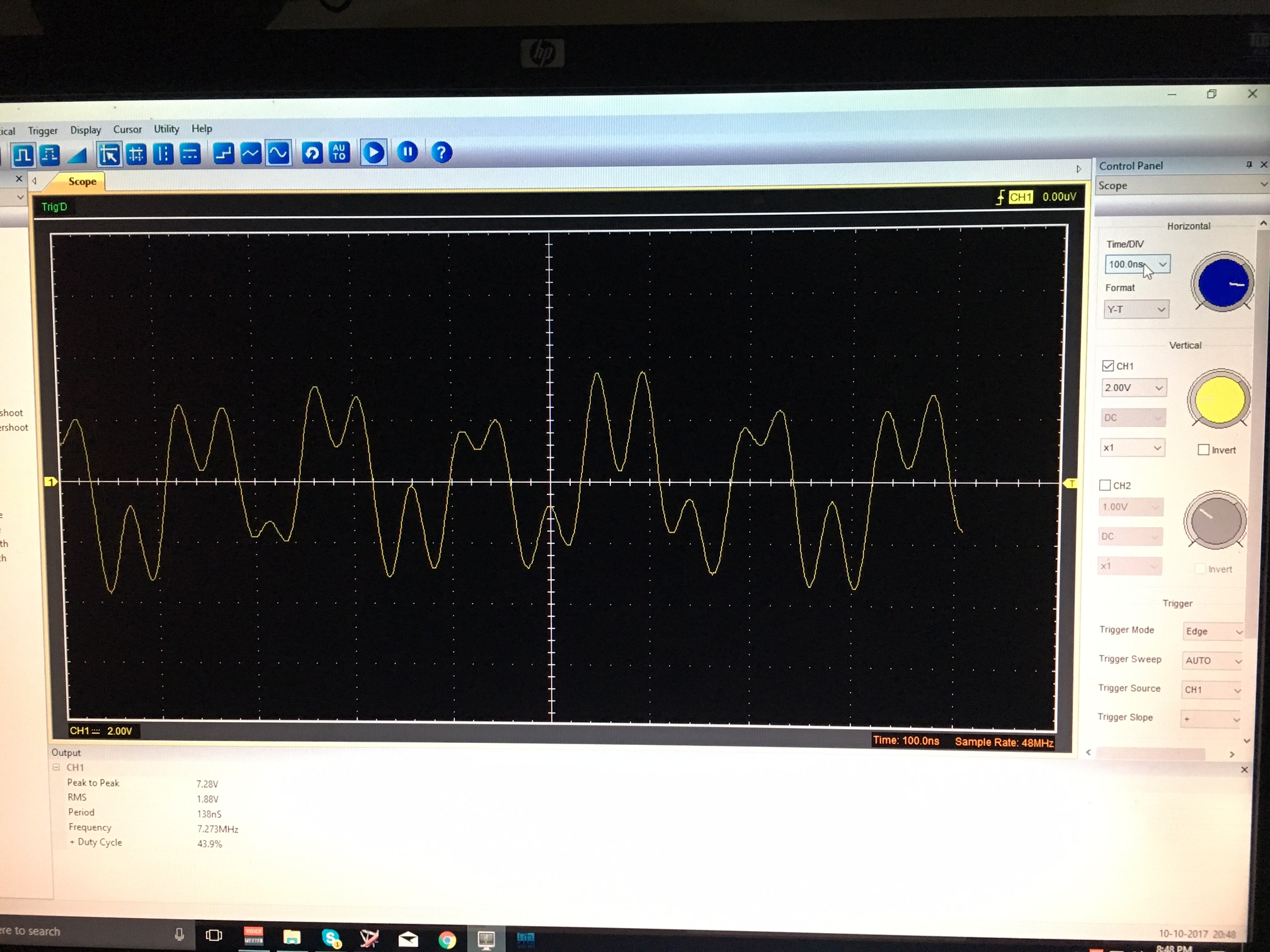

Please have a look at the waveform when I go to 20 m band and higher. It is almost sine . At hands below 40m this ugly waveform comes.
Please consider this pic also.
Also please tell me the capacitor value , grounded from both "+" input points of Am in IC - U7.
In my sketch it is C129 & C228 with value 47pF. Is this value critical. I think I have used 33pF instead of 47pF !!! Any serious issue ? I have marked as some confusion on this value in my sketch while assembling. Dont remember what exactly happened that time !
Possibly the MTO/parts list which I was following had different value for these Cap !! ??
Now during a detailed check in RF stage, I noticed the C33 (100nF) was wrongly fixed with 22ohm resistor. I replaced it. But no change in results !!
73s,
Prem
- 40 m Band .JPG (836.85 KiB) Viewed 36412 times
- 20m band 2.JPG (89.49 KiB) Viewed 36412 times
- 20 m band.JPG (88.45 KiB) Viewed 36412 times

Prem,
I don't know which revision of the Hermes board you have, nor which version of the Hermes schematic and BOM go with it. My only reference is here. I recommend you follow the documentation you have precisely.
The scope photos you have posted are not at all relevant. Your 20MHz scope will not give a good representation of such high freq's. At any rate, all of them show essentially the same problem.
I suggested some debugging steps in my previous post. If you could work with those it would be most helpful. If we see the same incorrect waveform at the output of the DAC transformer then we know that whatever mistakes you may have made in the RF section are not the root cause of the main problem.

Please have a look at test result @ 1 Mhz Tune, measured at R7 terminal , which is signal out from DAC.
So it is not at all Sine, almost same signal which we saw at final Ant out point !
I have physically inspected for any bridge between DAC out pins. Could not see anything strange. Can I get the DAC IC Pin voltages to verify ?
The signal from FPGA (14 nos) can measure some square wave on scope ?
Please advise further please.
73s
Prem, A65BK.
Prem,
All of the voltages on the DAC pins are straightforward and available from the schematic. They are either 3.3 or GND, "SLEEP" is floating. REFIO is an analog voltage that varies with the RF drive setting, I don't know what the range is. On the digital inputs they are whatever is coming out of the FPGA, i.e. 3.3 or GND.
Did you try lowering drive and seeing if the waveform stayed the same, but simply varied in amplitude? I think that is what will happen.
I'm grasping at straws now. I think I've reached the limit of what I can debug. We know it has something to do with the DAC and/or the FPGA connections to the DAC.
Are all of the connections on T1 correct?
Or, possibly...you have a 16-bit Hermes board, right? Did you by chance load the 14-bit firmware by accident (really grasping at straws)?
I did further test on DAC signal with my scope.
At 1 MHz even with drive as low as 30 mW (FWD PWR S meter), I get the same non-Sine waveform from DAC out.
Then I monitored signal on DAC IC Pin 1 to Pin- 14. The pictures are as attached.
Only on pin-1 I get a square wave at 1 MHz.
On all other pins the waveform seen are different ! Also the frequency read was not 1 MHz !
On Pin-2 freq was above 3 MHz and other pins its was even higher values !!
What is the expected result ? All pins 1 to 14 to show same square wave at 1 MHz ??
Please advise further.
73s
Prem, A65BK
73s
Prem, A65BK
- DAC Pin-3 .JPG (93.03 KiB) Viewed 37041 times
- DAC Pin-2 .JPG (92.85 KiB) Viewed 37041 times
- DAC Pin-1 .JPG (89.08 KiB) Viewed 37041 times
Sending more Pin wave forms.
Rds,
Prem
Rds,
Prem
- DAC Pin-6 .JPG (83.02 KiB) Viewed 37040 times
- DAC Pin-5 .JPG (91.78 KiB) Viewed 37040 times
- DAC Pin-4 .JPG (92.38 KiB) Viewed 37040 times
Pin-12, 13 & 14 signals
Rds, Prem
Rds, Prem
- DAC Pin-14.JPG (89.16 KiB) Viewed 37039 times
- DAC Pin-13.JPG (89.41 KiB) Viewed 37039 times
- DAC Pin-12.JPG (89.1 KiB) Viewed 37039 times

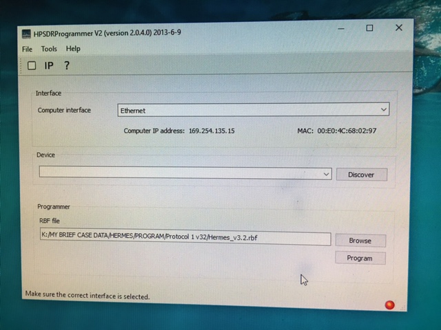

Also I tried to reload v3.2 Firmware rbf file using programmer software. Please see the pic arrached. After errasing previous V3.2, it completed programming upto 100%. But at last it showed error as seen in Pic " Make sure the correct interface is selected " !!
Later if I click the "Discover" button, it will show V3.2 !
Anything wrong here in my Firmware upload ?
Your board is a 16-bit Hermes. It is defined as such by the use of the 16-bit ADC, and the larger FPGA.
You video shows correct loading of the firmware using bootloader.
Your scope measurements are mostly not worth anything because the DAC runs at 125MHz and your 20MHz scope cannot keep up with that data rate on the data input lines.
At 1MHz, Pin 1 should be a 1MHz square wave. Pin 2 should be a 2MHz square wave. And so on.
Understand, Prem, that I am now "grasping at straws". This is an English expression that means to guess randomly at or pursue any apparent option, due to a lack of clear choices or information. Any further help I give may or may not be actual help! So if I lead you down some wrong path at this point, my apologies, but I have exhausted what I can definitively do on this problem. As long as you understand that, then....
