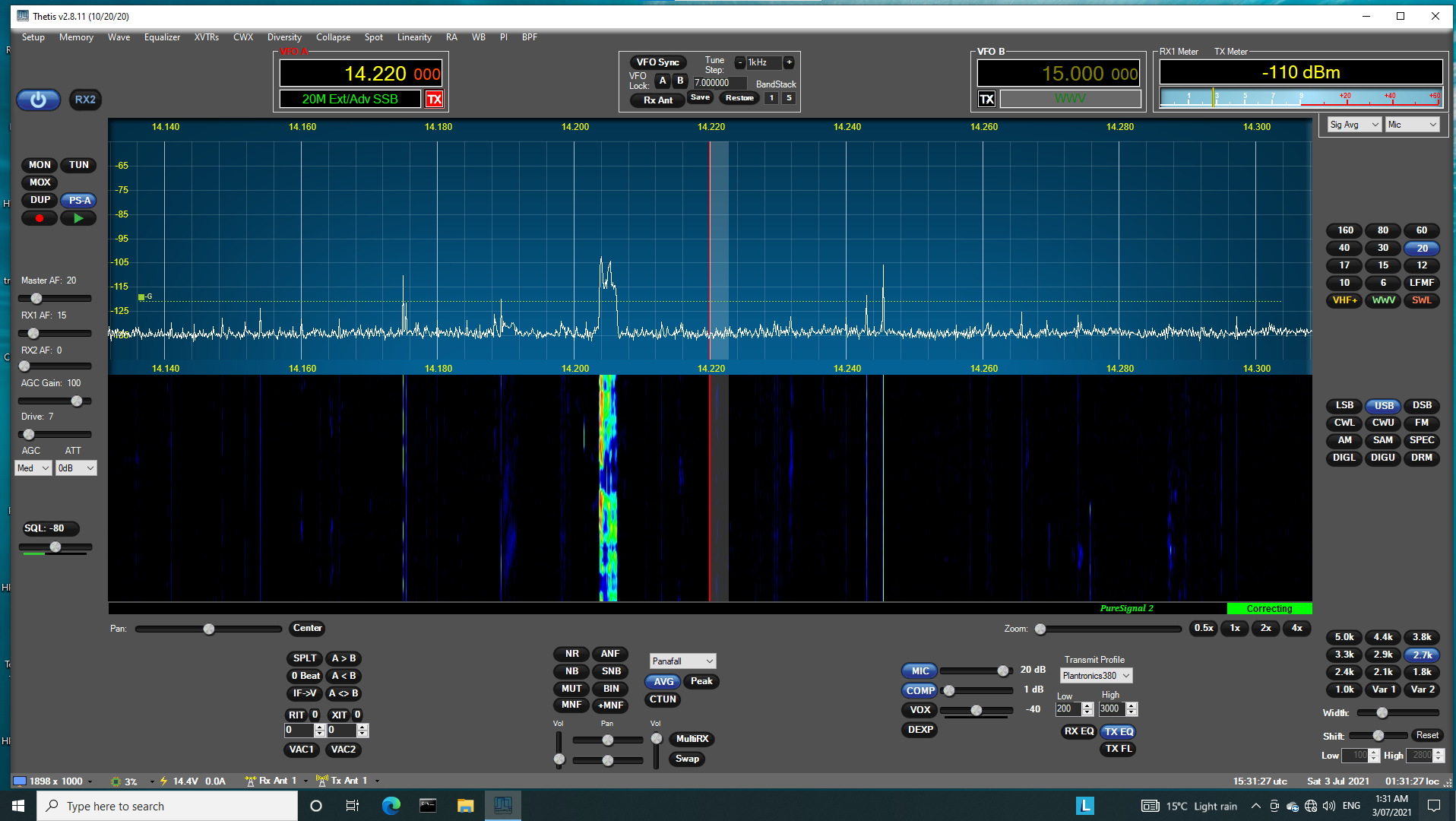

Attached are screen shots showing the difference between the LCD and LED monitors tried so far.
In addition to the HP and Dell monitors mentioned I tried friends LG29UM67-P and Samsung SE790C , these are similar or verse than the Dell shown in the screen shot.
Clamp on ferrite's have not helped.
Andrew

AndrewK wrote:Ruben, thanks for the model number.
Andrew
Hello Andrew,
Wow big difference between the top and bottom monitor. Were these shots made close together? I pick up a good bit of noise on 20 meters also. That is the only band I see these lines on. I have seen shots of others on 20 meters and all of them contain those noise lines on 20 meters. The on you have there is the first I have seen without them.
Re: Monitor Recommendations
Hi Ruben, screen shots were taken close together, 20m and 10m seem to be the most affected.
So far between my self and a friend have tried 6 LED monitors all have the problem on 20m, this is why I ask for specific models that are clean otherwise buying anything is pure pot luck and most likely will be disappointed.

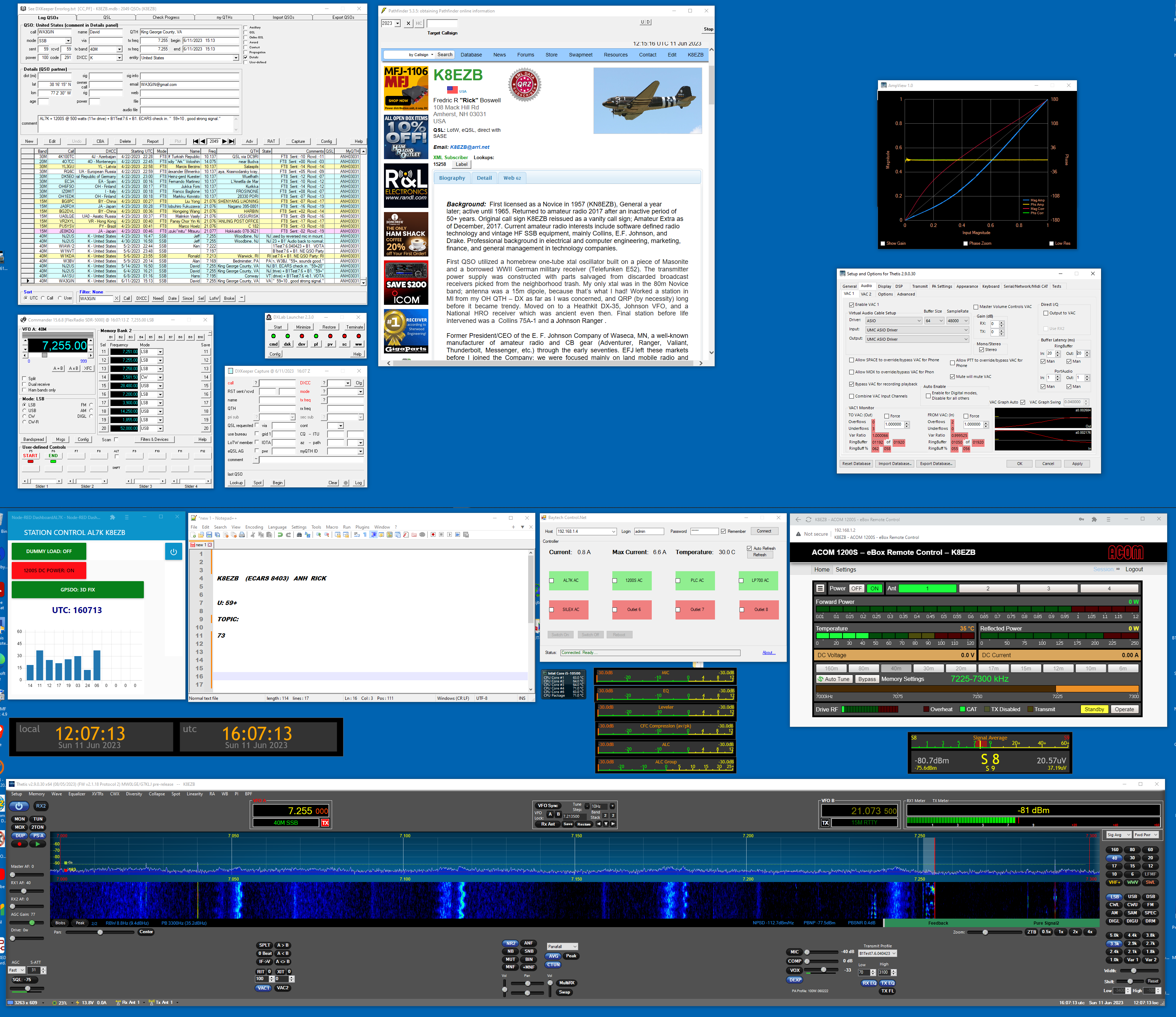

I am using two LG 34WN80C-B 34 in. curved "Ultra Wide" (21:9 aspect ratio) hi res monitors (3440x1440) stacked vertically and treated by Win10 as a single screen. These provide lots of screen real estate and use DP connections to an Asus/Intel i5 10500 processor with Intel onboard UHD 630 graphics (2xDP, 1xHDMI, 1x VGA). Still working through optimum screen layouts. The image below shows the current layout. The upper half is used for logging and other apps which are useful but not directly related to station control; the lower half is used for the main transceiver window and four station control related apps which support remote operation. A bit busy at present but will do some work to simplify this in the fullness of time.
Rick
K8EZB
