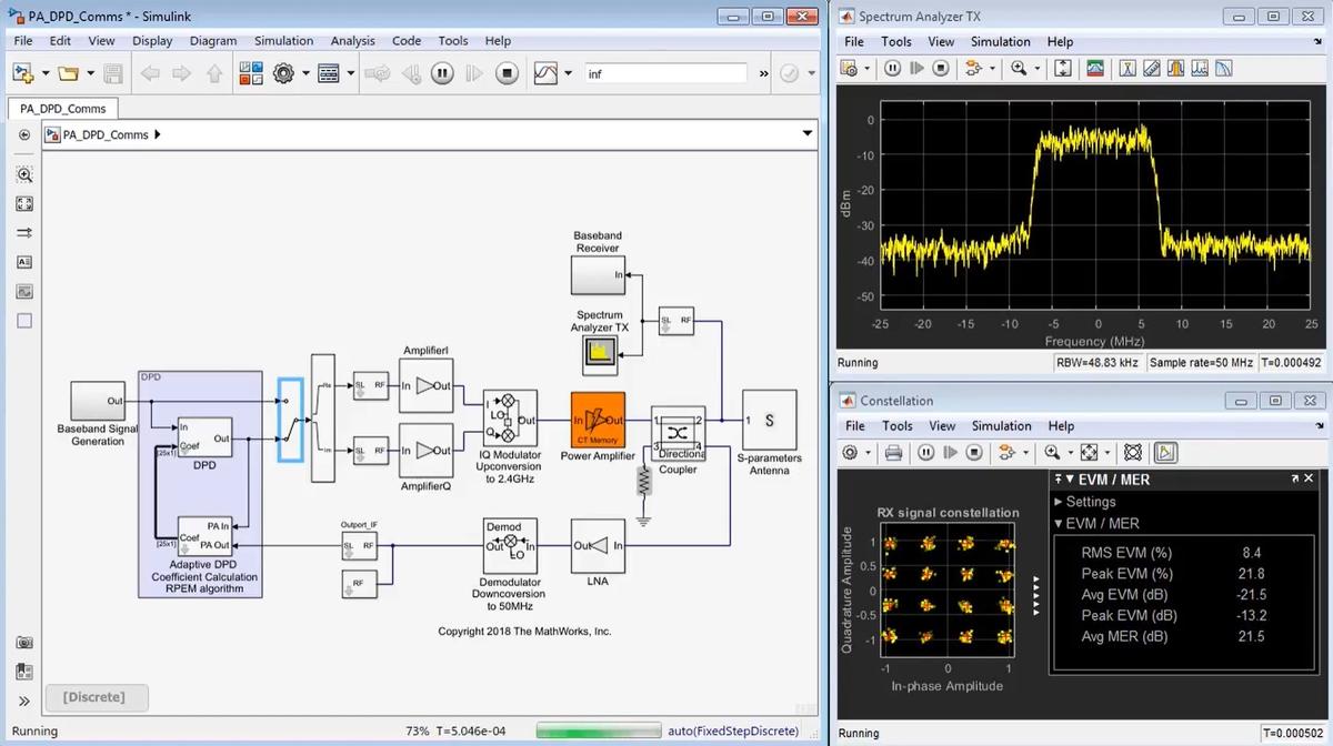

I Found a good introduction video - Power Amplifier Modeling and DPD Design with MATLAB - https://www.youtube.com/watch?v=eo21QWO4VDU - showing the concept which I would like to utilize with tools like Matlab - regarding APD design.
The good thing here is that you can investigate existing APD models and modify them within the simulation - to try to achieve optimal results for your design criteria.
Once happy, can then produce HDL code for FPGA to realize this in H/W

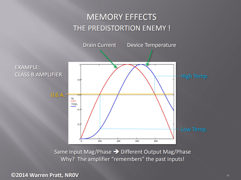

Not sure if many Anan transceiver owners have seen Warren Pratts presentation on Pure Signal?
Here is a link for those who are interested; -
http://www.n3sh.org/Tech%20Section/PureSignal_final_selection.pdf
The most significant aspect of his presentation (in relation to pure signal shortcommings) is discussed on Page(s) 22-24 – where he discusses Memory Effects in his slides.
Page 24 is shown below
Unless you are familiar with the adaptive predistortion process Warren Pratt has implemented, the above slide might not mean much to you.
What is “Memory Effects” you might ask?
Well in the PureSignal.pdf document from the GitHub link above – on page 3 there is reference being made to Memory Effects – I copied this text below to highlight what is exactly referred to by Memory Effects – and more importantly how we can mitigate these effects in the type of amplifiers we use and their configurations.
Here is the specific extract; -
The current PureSignal algorithm does not attempt to dynamically compensate for “memory effects.”
Memory Effects are phenomena whereby the amplifier gain and phase are not only a function of the current input signal, they are also a function of past input signals.
The amplifier “remembers” signals that went through in the past. These effects can be thermal or bias / power‐supply related.
For example, suppose that a strong signal over a period of some milliseconds heated the active devices of the amplifier thereby changing their gain and other characteristics.
Then the amplifier “remembers” those characteristics until it cools back down even though a weaker signal may pass through in the meantime.
So, for the same weak signal level, the amplifier characteristic is different depending upon whether it is hot or cooler, depending upon the preceding signals.
A similar situation exists with bias and supply voltages. Suppose a strong signal momentarily causes a slight drop in power supply voltage.
If the supply does not recover instantaneously (which it typically will not) the amplifiers gain will have been changed for a subsequent weak signal.
Amplifiers with weak memory effects will be more effectively corrected than those with strong memory effects.
Among solid‐state amplifiers, current experience suggests that LDMOS amplifiers using higher voltage (~50V) supplies produce the best results.
In any particular amplifier design, factors that can minimize memory effects include: • High‐voltage / low‐current designs to minimize power supply droop.
• “Stiff” power sources to minimize voltage “sag.” (The poor voltage regulation of some amplifiers has proven challenging in some cases.)
• Lower capacitance devices (such as LDMOS).
• Excellent heat‐sinking in solid state designs, probably including a copper heat‐spreader. As you would suspect from this list, 13.8V FET amplifiers can be challenging to correct.
However, stiff power supplies and good cooling can go a very long way.
THE AMOUNT OF IMD CORRECTION YOU ACHIEVE WILL DEPEND UPON THE MEMORY EFFECTS OF YOUR AMPLIFIER AND THE QUALITY OF YOUR FEEDBACK SIGNAL
