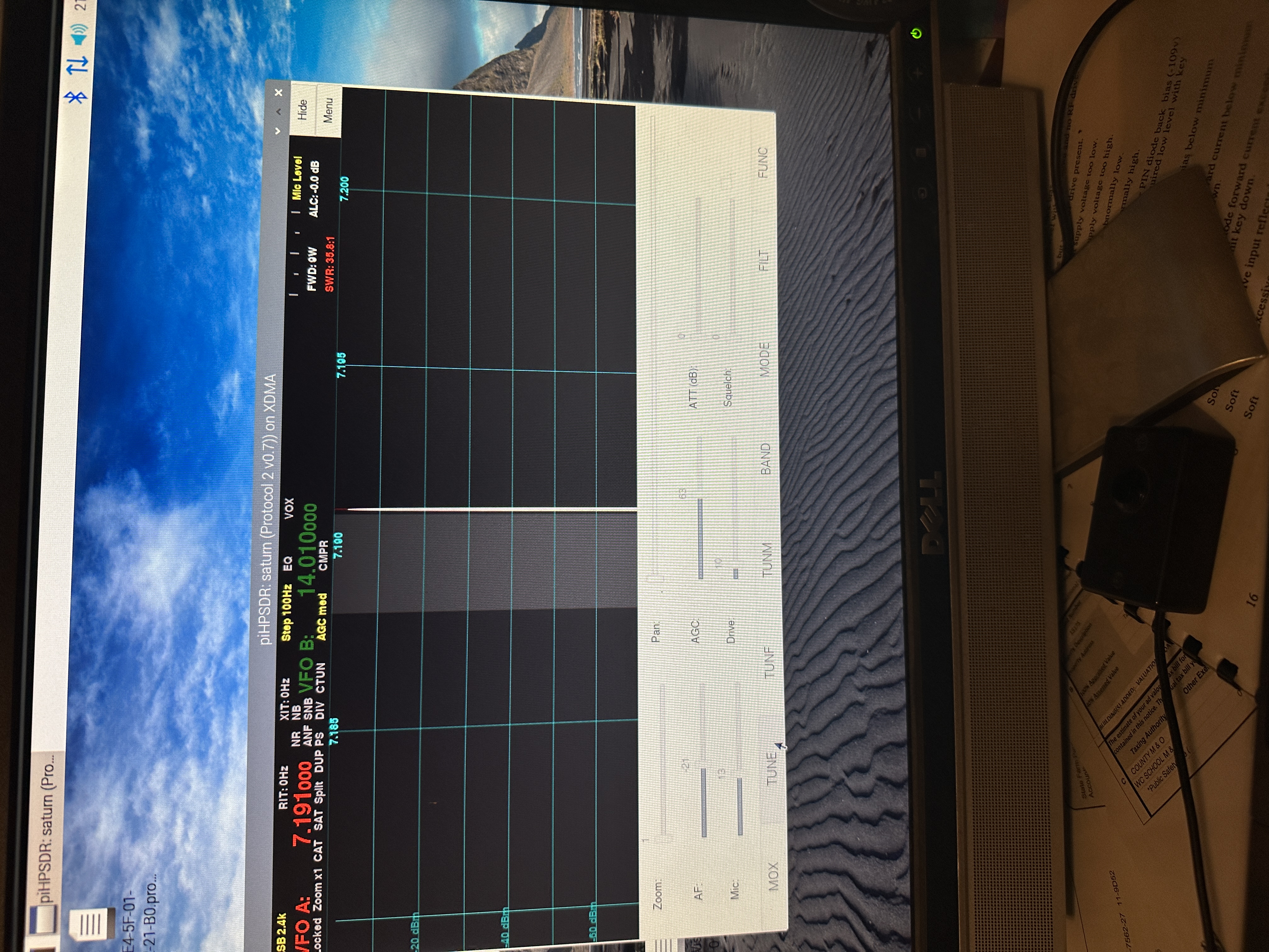

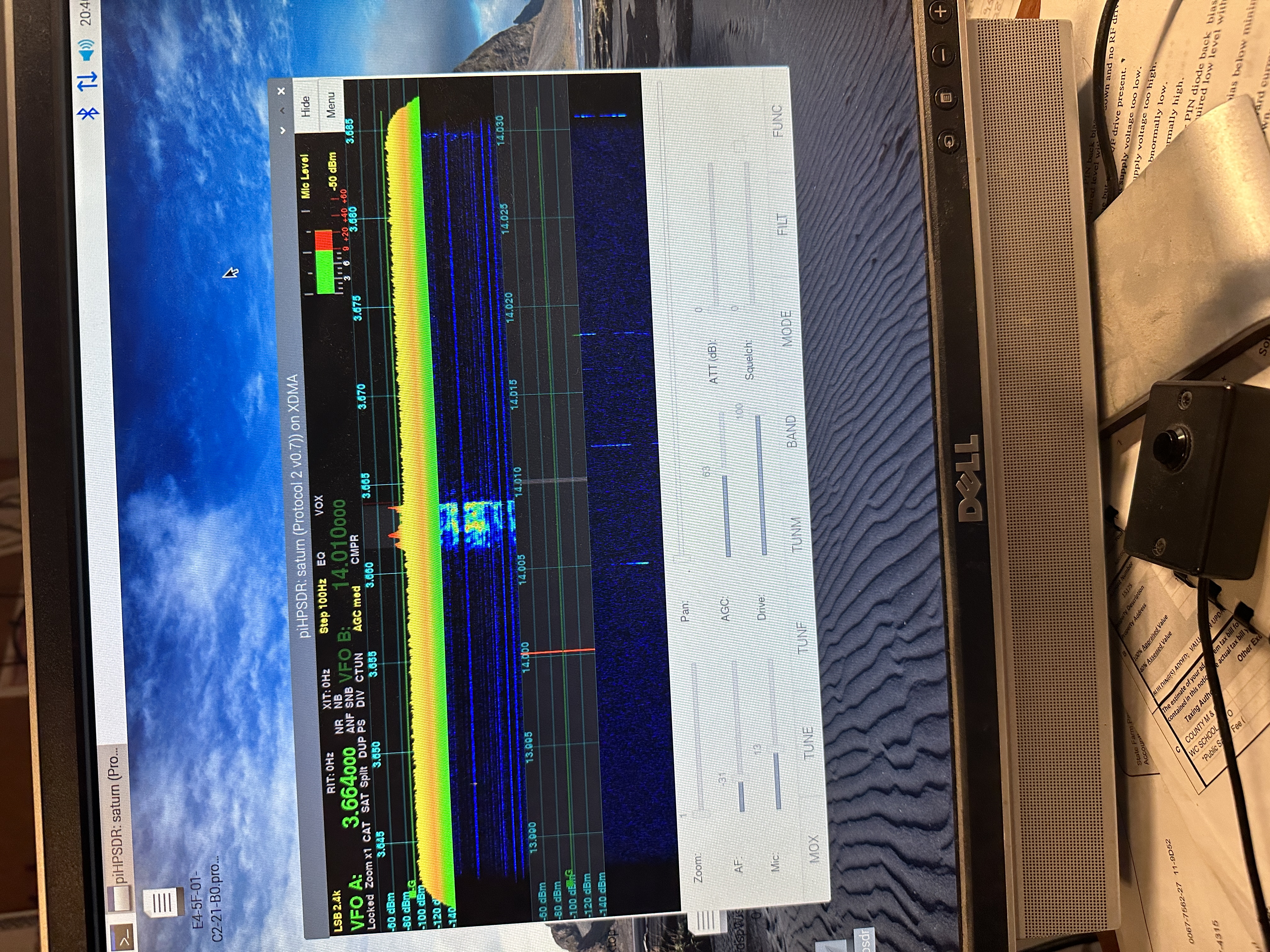

Well, here we go again, after getting very frustrated with the G2 trying to use thetis I hooked up monitor and stuff to try on PI, got the p2app killed got pihpsdr up and running for about 30 minutes, couldn't get but about 40 watts though, but hey I got to talk on it. Turned on this morning done same process and again all day no receive using PI, and when no receive SWR is sky high, almost like there is no antenna connected. I'm just about feed up with this mess. Any more ideas.

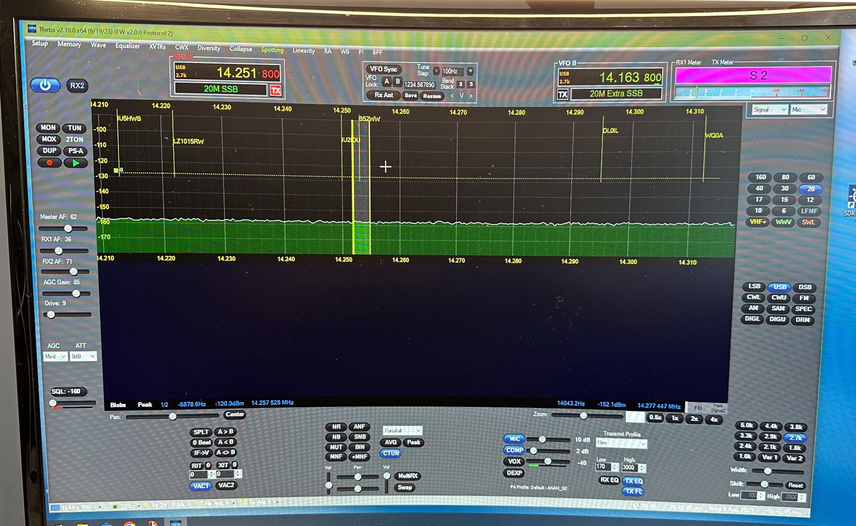

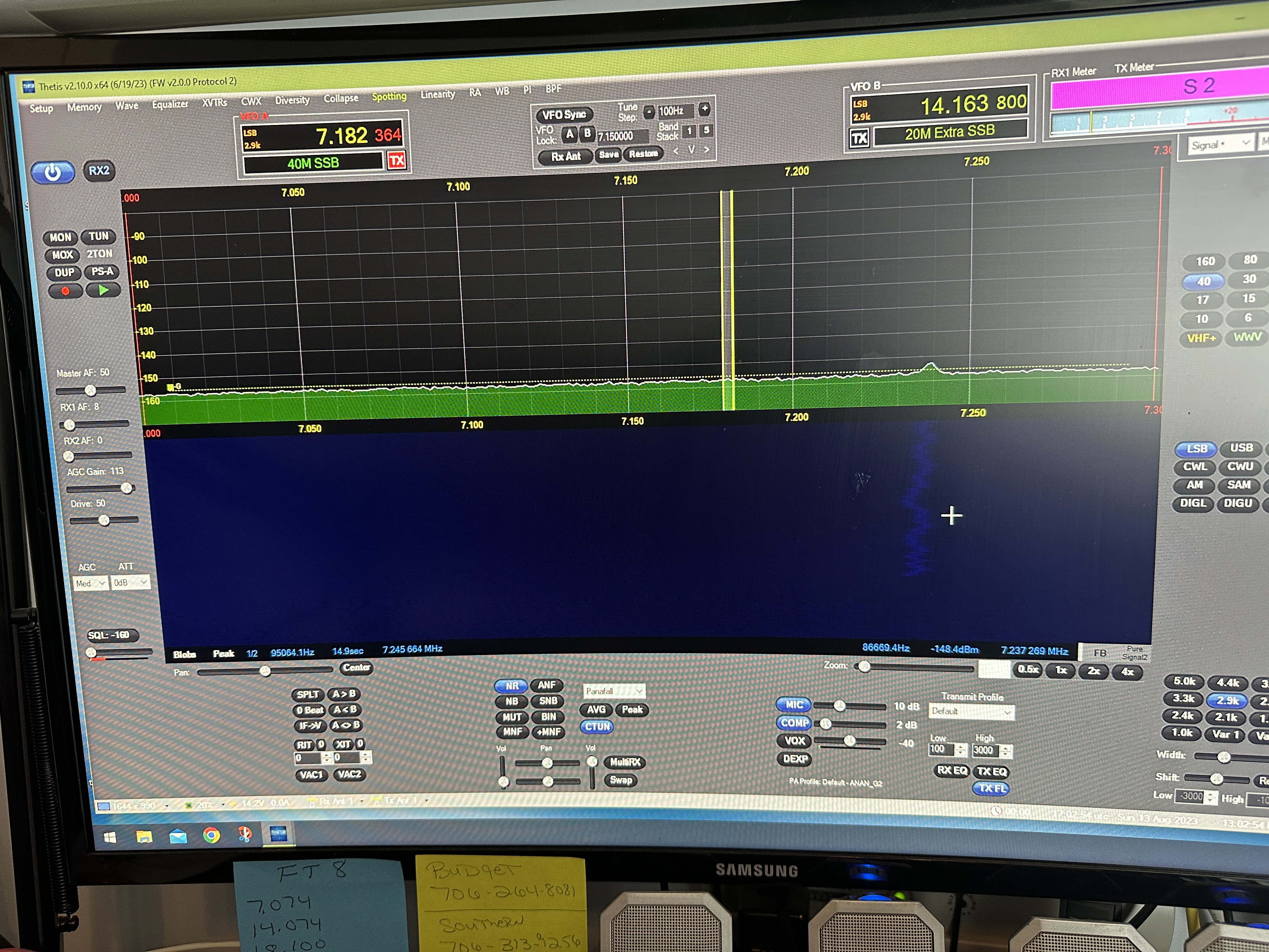

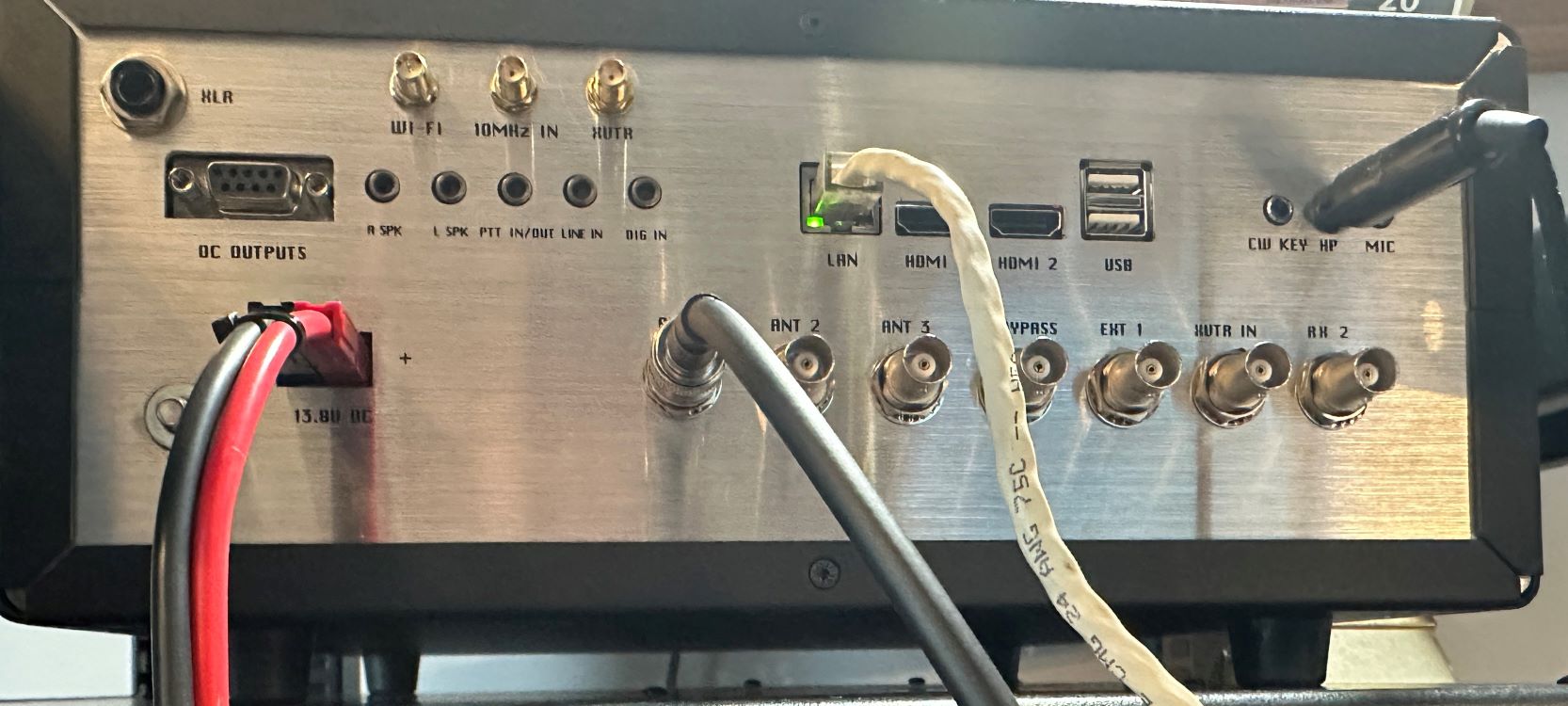

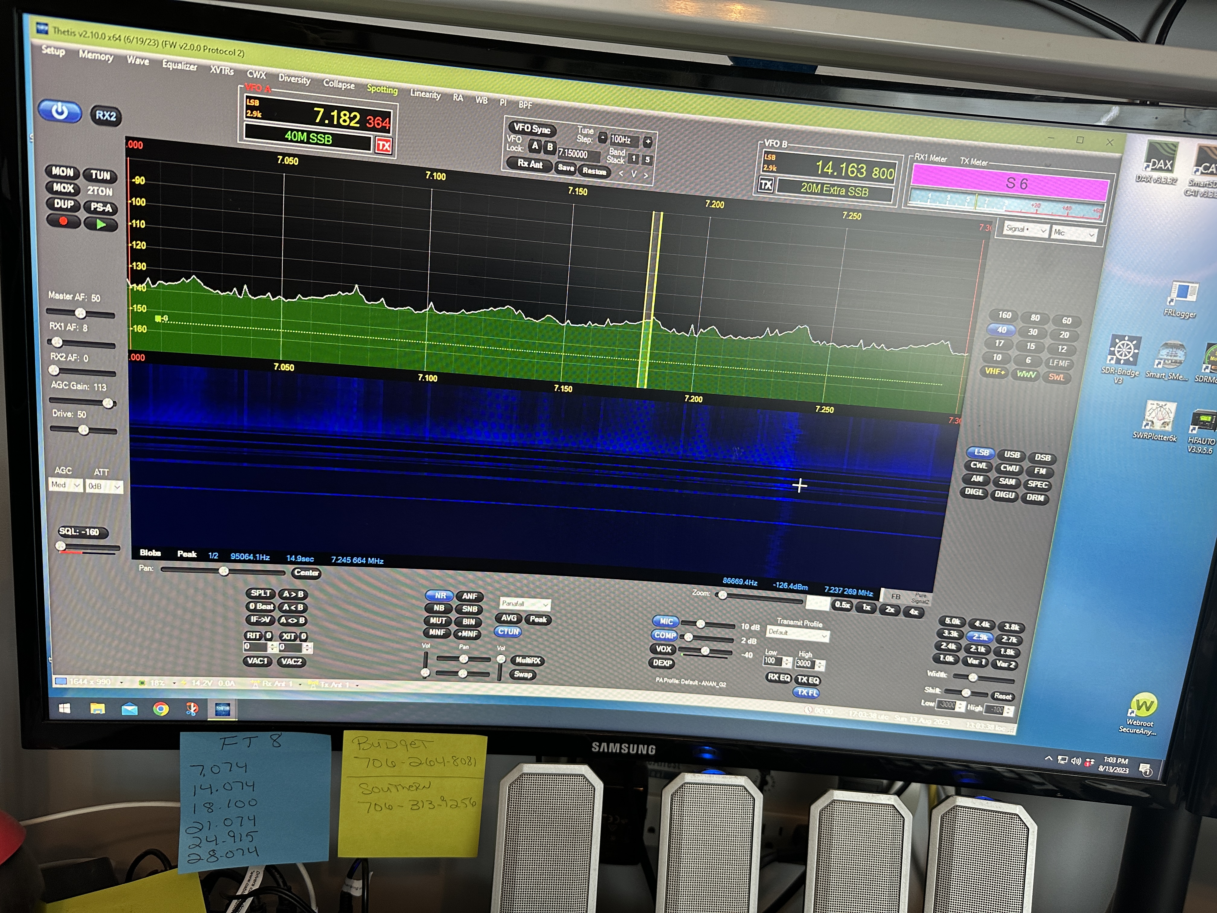

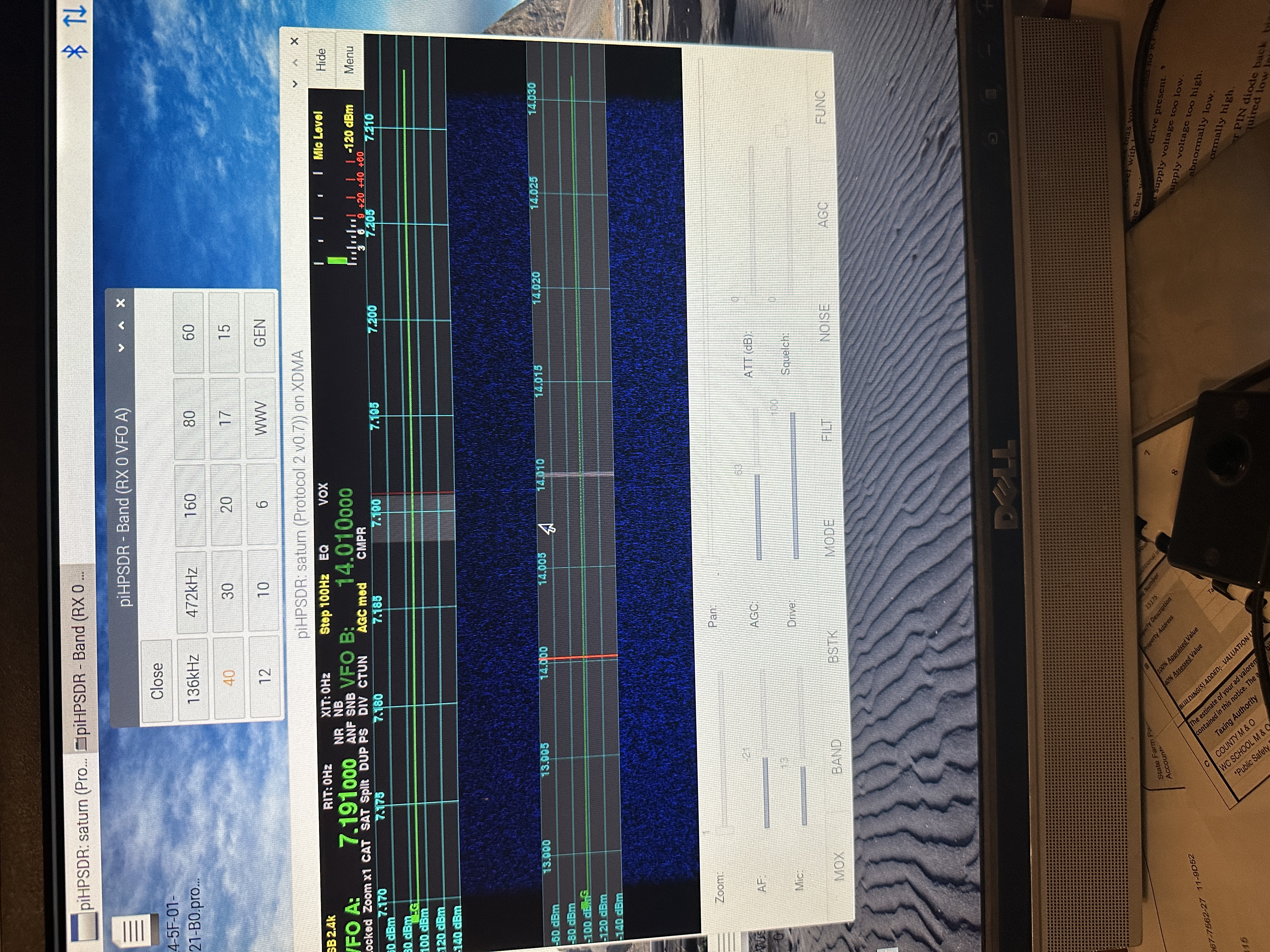

ok, turned on G2 when i got home after church, receive came up, gave me hope, then went away after about a couple minutes to blank screen again, see attached pics,
done steps as you requested and took pics so yall wouldn't think i m crazy
ok, disable transmit, done.
checked adc selections and clicked reset button,
not receiving, see pic
don't have a signal generator, but did disconnect antenna, used phillips screwdriver and touched center on ant 1, see pic, receive did increase. so i understand what you say about receive should be working, but its not, does same thing on PIHPSDR (see pic). also see pic of PI in transmit and shows in top right corner swr !
so still seems to me something is dead, im seeing no receive and high swr, indicative of no antenna to me. sorry for big pictures. bottom shows receiving in PI the other night.
thanks again for contacting me, im trying to stay calm, but starting to wear thin, have radio for about 3 weeks and getting to use it maybe 20 or so minutes.
Richard

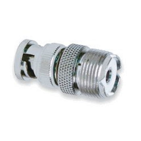

Do you have another BNC to 239 adapter that you can try? Maybe, just moving the existing cable a bit would let you know if it is intermittent.
Just a thought that occurred to me.
Maybe an adapter like this one.

Not using an adapter now. Bought a bnc to 259 jumper, did try adapter first though, 5 of them
Richard - KI4P
Re: G2 - No Receive
Ok, I have had problems using BNC to 239 jumpers before. That is why I mentioned it. I hope you are able to get the problem figured out.

Hi Richard,
Thanks for those tests, I would suggest selecting and using the ANT2 or ANT3 port for both Rx and Tx and see if you are still seeing the intermittent receive/High SWR.
Do you have another antenna which does not use the same coax that you can test the rig with on Rx? maybe just a long wire on AM to see if that gets you reception when the primary antenna is not working.
Tony
