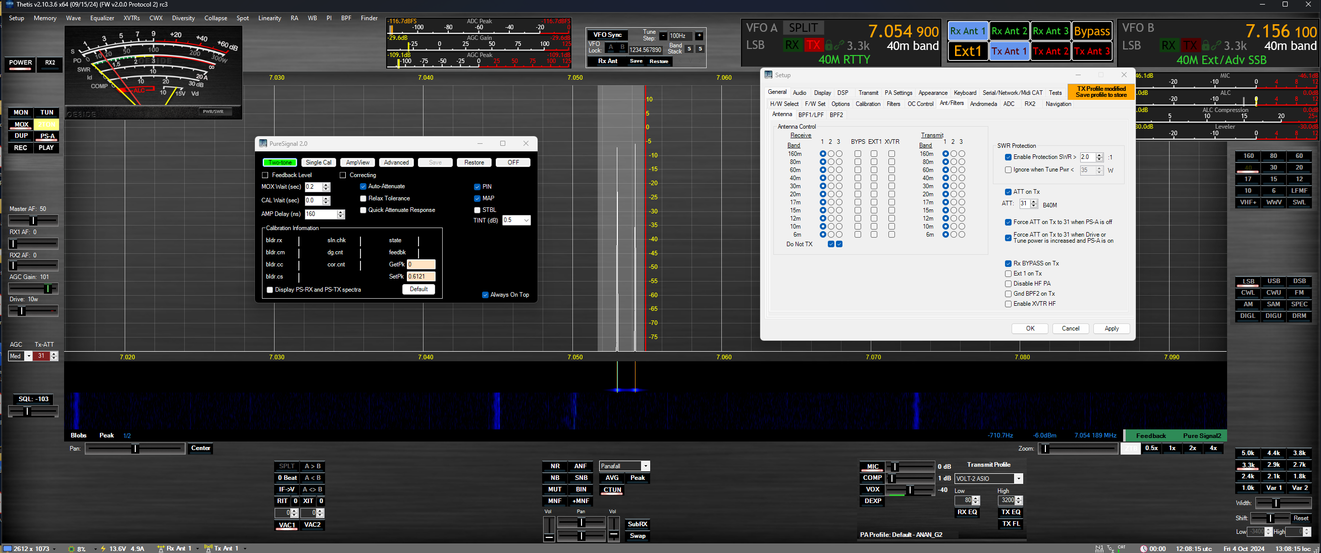

Pure signal is not working with Thetis but is working with Pihpsdr.

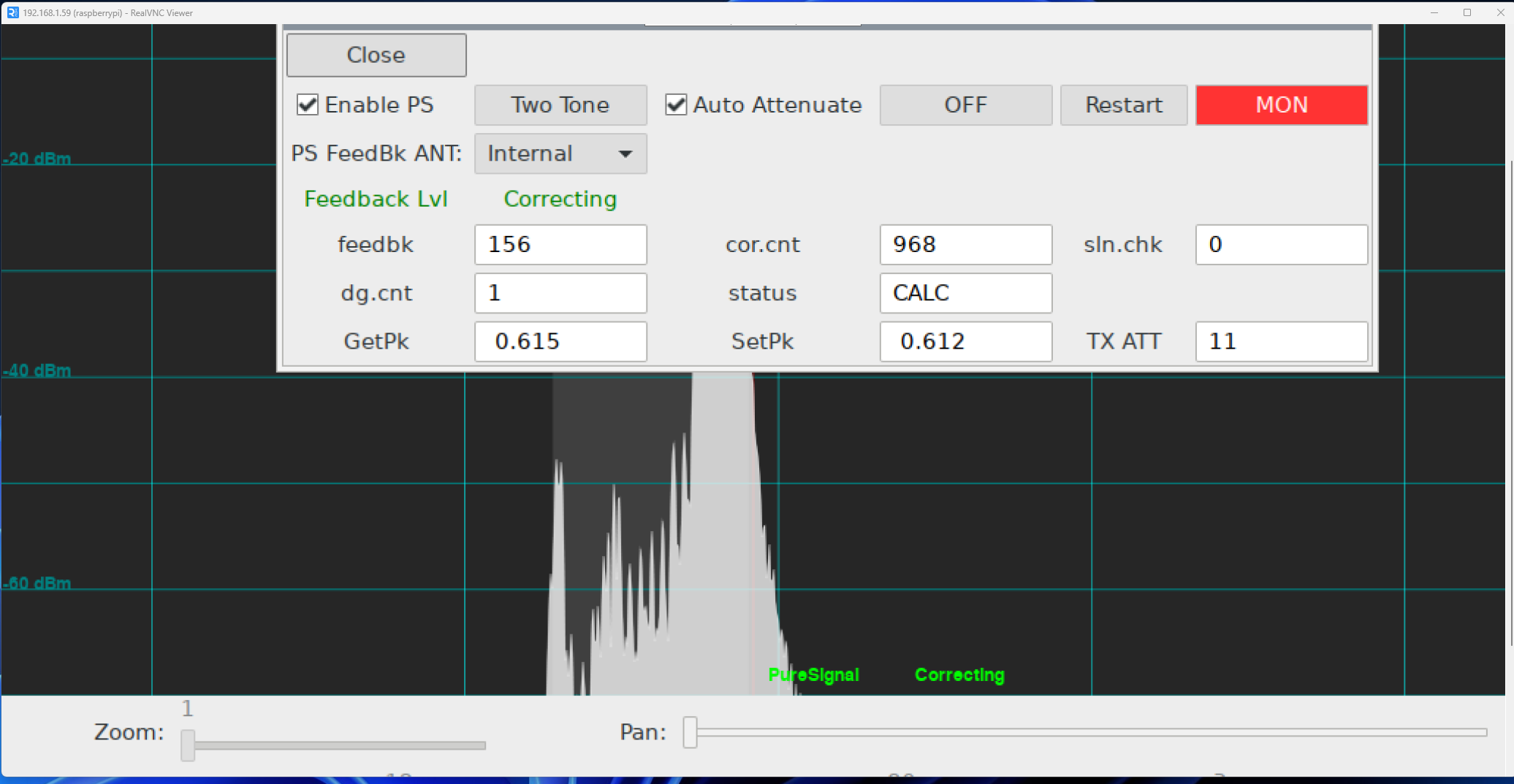

I didn't do any firmware updates recently and only updated Thetis to current release candidate 3. I have rolled back to earlier versions of Thetis to test, and same result.
G2 ps not working.png (802.14 KiB) Viewed 3037 times

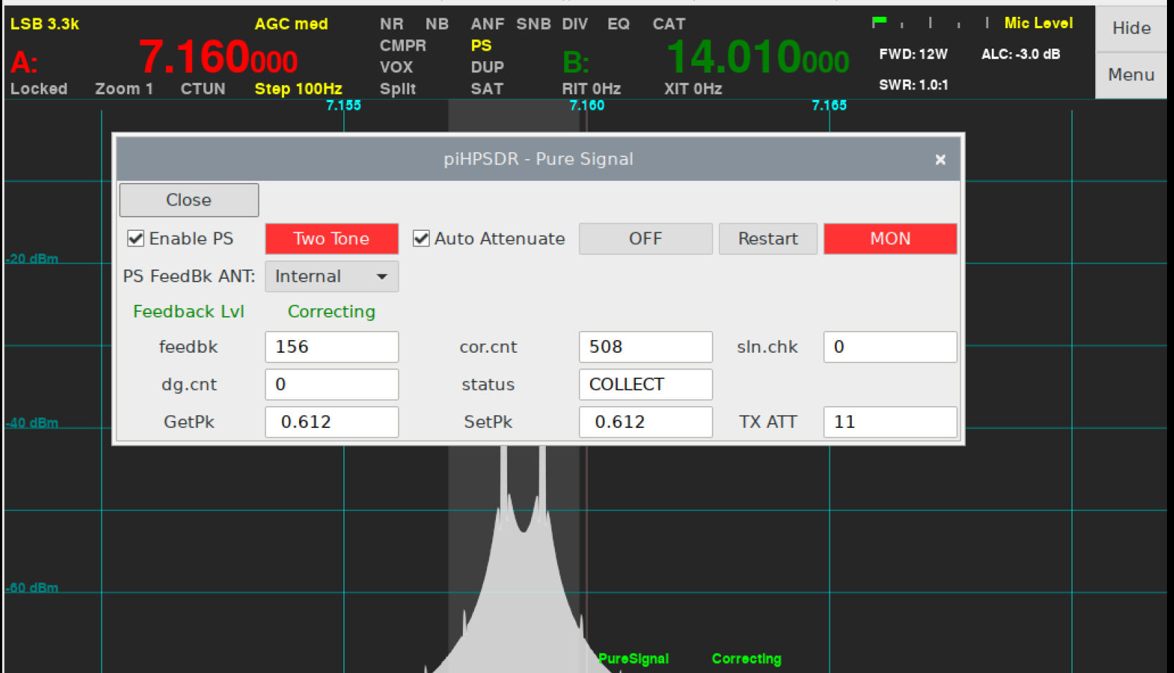

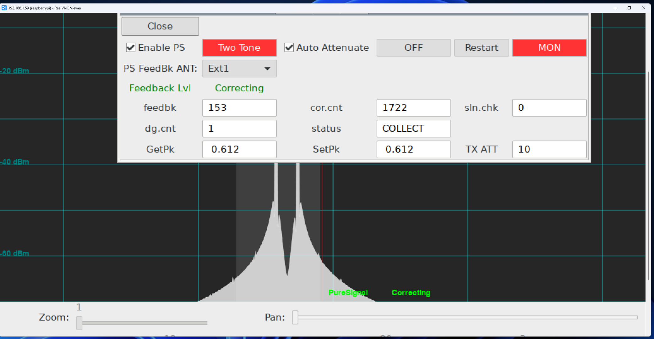

Seems to be working perfect with Pihpdsr with external coupler and also working without coupler.
correcting during normal audio input.png (214.59 KiB) Viewed 3037 times

Postby K1LSB » Sat Oct 05, 2024 12:52 am
Not sure whether this is relevant but your DUP button isn't activated, maybe it should be toggled On.

Postby echo_india » Sat Oct 05, 2024 10:07 am
Reinstalled Thetis again, and now PS is working. A bit if a mystery.
