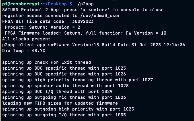

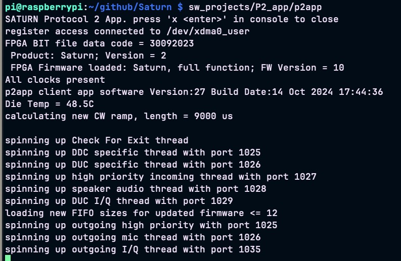

Ok, done that, still seems to show version 10 though?
Here is the original before I updated
I did the flashwriter and chose the correct file, shutdown etc.
Any ideas why it did not update?
Re: G2 Software and Firmware Updates
No sorry, worked for me. Are you sure you loaded the v17.bin file? Also full shutdown?

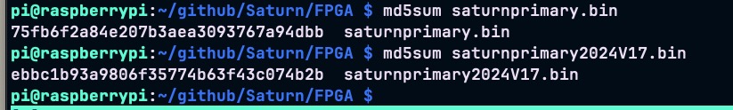

Ahh, no, I followed the instrucitons at the start of this thread.
click open file
navigate to the file ~/github/Saturn/FPGA
select file saturnprimary.bin
makes sure the Primary radio button is selected
click Program
I saw the recent date/time on the file and assumed that was it. Howevber there is a 2024V17.bin file, so I will try that, that wil be the issue.
