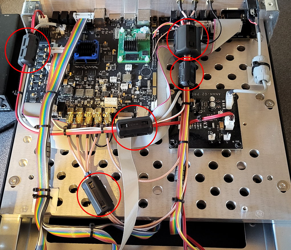

Hello guys.
Sorry for the delai to come back to all of you but Fedex have lost my first ferrites #31 package i have order 2 week ago .
Now i receive some to day and after i put some on those place you can see on the pictures and the distorted audio problem i had on 15M band was solved .
One ferrite you can see on the right side on the picture was a little too big on diameter . So just to big sure i have add another small one i had from amazon with the right diameter to be sure . All other are #31 from DX Engineering .
Even though this modification was at my expense, I really hope that Apache Labs will be more attentive to their own product, especially for the price that many had to pay.
Personally I find it unacceptable that Apache Labs sent a SDR transceiver of more than $ 4300 USD with an old version of Firmware, but also of PiHPSDR and in addition a serious conception flaw that apparently no one has seen.
Mega thanks to Richard Koch N6MUD for have solving this problem .
73's Michel VE2XK FN08XJ

Someone on facebook claimed, that 17m is distorted after this fix. I verified that, and confirm the problem, if using more than 20-25W.
Issue was fixed on 15m with ferrites, but now 17m is distorted. Any ideas?

grolaf wrote:Someone on facebook claimed, that 17m is distorted after this fix. I verified that, and confirm the problem, if using more than 20-25W.
Ugh, yep I noticed now 17M now has the problem. I am not sure how to fix this. I will ping Doug and see if he has any ideas.
