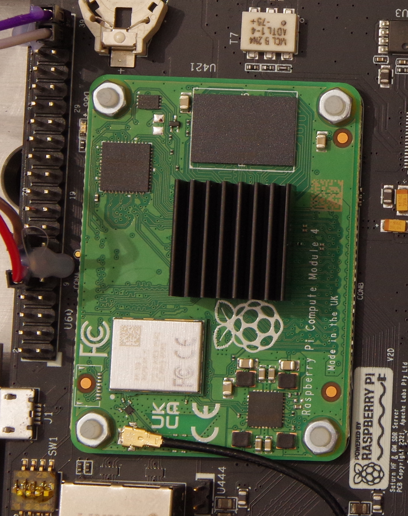

Laurance, are the Compute modules interchangeable by the user? Or will it require a trip to someone to remove and replace the CM4? I have looked at many photos of the G2 interior and none are clear enough to see how easy a module can or cannot be, to replace if needed.

I haven't see a factory-made G2: but it is a plug and socket onto the Saturn DSP board. There may be (hopefully are! screws to secure it, in which case the Saturn board itself may need to be unscrewed. All while wearing an anti-static wrist strap. But I'd expect most users could do that.

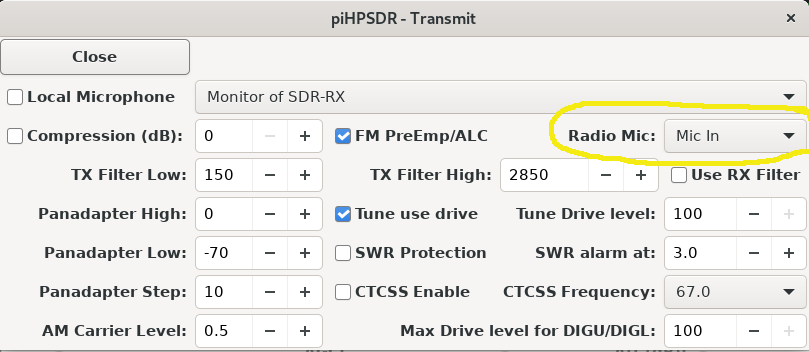

Can you check and make sure that on your G2's native pihpsdr that
in the TX menu, Radio Mic is set to Mic In ?

ct1iqi wrote:@truckercm4_saturn.jpg
Thank you Martin. A friend that has a G2 sent me some photos. But, it was difficult to tell what connections there were to the main board. I could see the four standoffs at the corners. But, the CM4 module is so close to the main board that I can't tell what kind of connections are used. I am assuming it's some sort of a pin and socket connection.
If that is the case, then upgrades to a newer module would be something that I might be able to do without making too big of a mess!

@Trucker: See
https://datasheets.raspberrypi.com/cm4i ... asheet.pdf
That is a motherboard for experimenting with a CM4. Its just two miniature connectors, very similar to the system used by eMMC memory modules. Just more pins.

@n1gp
Tnx for hints. no luck with setting mic in. Just total silence during tx. E.g. two-tone tx works fine. Also removed .props, to no avail.

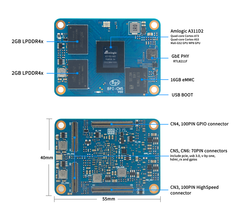

Found a photo of the new CM5 Pi. The connectors on the underside of the module seem to be different as there is a third connector that the CM4 doesn't seem to have.

There are several interesting alternative choices available on the market as a more powerful, pin-compatible CM4 replacement. There would be some risk in getting everything to compile and run on different hardware and different kernels, though.
