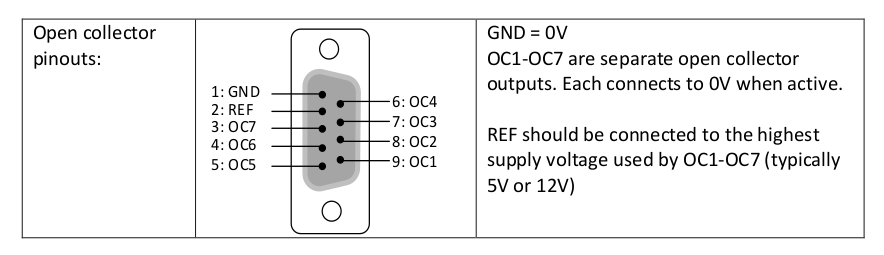

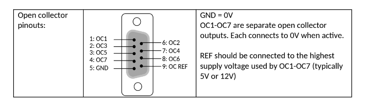

It was recently discovered that the Open Collector outputs were not as previously
documented. This only affects the G2.
Old pin assignment:
New pin assignment:
Updated G2 Manual:
https://apache-labs.com/download_file.php?downloads_id=1023

So I need to figure out and re-map the pin assignments in Thetis Or make a new cable?
I see even the darn Ground pin is different!
Just want to make sure i understand.
n1gp
Posts: 203
Re: G2 Updated files and simplified update procedure
Postby n1gp » Sun Feb 02, 2025 8:38 am
I would probably re-make my cable.
Wow :roll:
Rick--if you would please make a separate, dedicated post in the G2 forum that describes this then I will make sure it becomes a tacked/sticky post for everyone to easily reference.
Has this been reflected in the G2 documentation?

Good thing I didn't blow up my amp! :oops:
