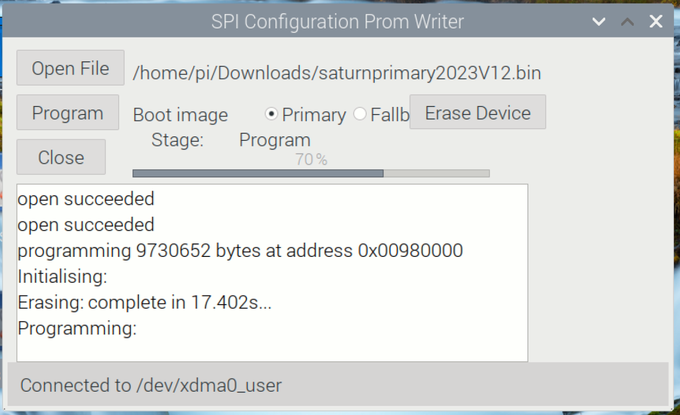

1. can you capture the text from the status window on the flashwriter app?
2. make sure that the V10 image hasn't accidentally been renamed V12

Postby ke3vg » Tue Mar 19, 2024 8:12 pm
Hi Laurence,
I have added the screenshot of Flashwriter.
thank you,
Mukesh
Screenshot 2024-03-19 160815.png (278.57 KiB) Viewed 29089 times
laurencebarker
Posts: 304
Re: G2 Software and Firmware Updates
Postby laurencebarker » Tue Mar 19, 2024 9:11 pm
and it completes successfully?
and you fully powered off the hardware then back on?
I've just programmed mine from the file in github and it reports version = 12, as expected

Postby ke3vg » Tue Mar 19, 2024 9:16 pm
yes, it is completely successful, it writes, reads and verification and completed successfully. Not sure why it does not pick up the new firmware after the bootup. After the upgrade the G2 is shutdown, power is removed for 30 seconds and restart. So far, I have updated 10 times with same results.

There isn't anything wrong with the image file on github. I downloaded it and reprogrammed from it yesterday. If you were to download the Vivado and recompile from source, you'd only get to the same image minus a lot of thickness of hair.
have you downloaded Saturnprimaryv12.bin again (to make sure it wasn't a V10 version renamed) and programmed from that?
I don't see how a hardware fault could happen with all of these symptoms. Flashwriter is reporting that it has programmed the file: it reads back every byte. The FPGA has successfully configured from that data: just one byte in error would stop it loading. This only makes sense if the V12 image i being written in to it time after time.
Laurence Barker G8NJJ

Postby K5WC » Wed Mar 20, 2024 12:16 pm
ke3vg wrote:Laurence,
that is a last solution. Is it worth to download the image file and rebuild it from scratch? I know it would not solve the actual FPGA reprogramming problem, but it may solve any other issues which may blocking the actual FW writing?
The message I receives after each flesh writer operation is that it has successfully completed each step and verification is successful, so all SW steps are completed without any issues. Do you think it is a hardware issue?
I would appreciate any insight here.
regards,
Mukesh
Have you tried flashing V11 to see if it will load and say V11? I was a couple updates behind and tried to go to 12 and had trouble. Loaded V11 and checked it was reporting that it was saying V11 then did it again and was successful. No idea why, I did nothing different than the first two attempts.

Postby Roger GT » Wed Mar 20, 2024 5:30 pm
I downloaded the saturnprimary2023V12.bin again from github and reinstalled it. Then I checked the P2app and piHPSDR for newer files. They are both up to date. My G2 with display and piHPSDR still does not transmit with V12. So I went back to V11. Now it transmits again. It is still noticeable that all encoders, switches and the VFO knob do not respond. The display is not locked. I am not using Tetis!
Vy 73 Roger DL2YDP
