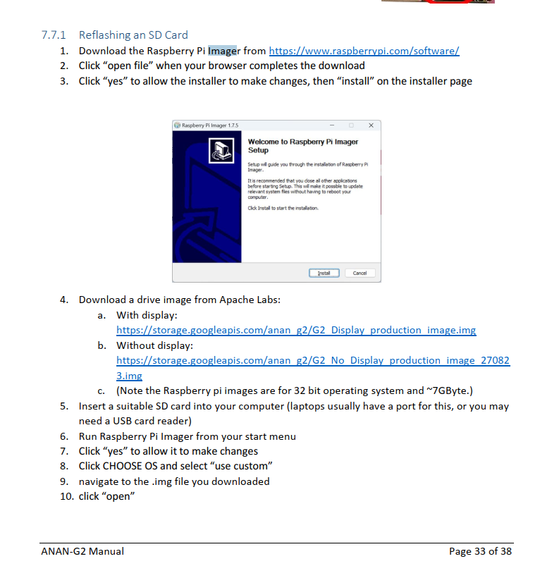

Re: G2 Software and Firmware Updates
4. Download a drive image from Apache Labs:
a. With display:
https://storage.googleapis.com/anan_g2/ ... _image.img
b. Without display:
https://storage.googleapis.com/anan_g2/ ... mage_27082
Both links do not work!
This XML file does not appear to have any style information associated with it. The document tree is shown below.
<Error>
<Code>UserProjectAccountProblem</Code>
<Message>The project to be billed is associated with a closed billing account.</Message>
<Details>The billing account for the owning project is disabled in state closed</Details>
</Error>
a. With display:
b. Without display:
<Error>
</Error>
Vy 73 Roger DL2YDP

Anyone have an image of the SD card for the G2 with display.?
I foolishly also did an update to the Pi, and now all screens are Black, as I read above happening to others.
Have Apache Labs not paid teir google storage account? Why isn't such important data files as these available from their website?
Radio is a door stop without software.
Tony VK4PA

coaxjim wrote:Anyone have an image of the SD card for the G2 with display.?
Tony VK4PA
Thanks to Abhi at Apache Labs.
For sending me a link to download the display G2 SD Card Image file.
Others who accidently trash their cards may be helped.
https://www.dropbox.com/scl/fi/6s7a4p34 ... clsuf&dl=0
All the best
Tony VK4PA
K5WC wrote: Thanks Tony for the link, did it get you back up and going?
73 John
Thanks for the link Toni. I will test the image immediately. Stay tuned.
Vy 73 Roger DL2YDP
The image works. I have successfully flashed it onto a µSD card. The G2 is working and I just need to do the updates.
Vy 73 Roger DL2YDP
Anyone looking for the G2 no display SD card image it can be found here https://cacelense.pt/G2/G2_No_Display_p ... 021223.zip
VK8BN
VK8BN
So I need a display to do the flash it seems? Or is there some switch to run from terminal?
Thaanks
Thaanks
- Screenshot 2024-11-01 at 16.28.44.jpg (98.04 KiB) Viewed 19770 times
g6phf wrote:So I need a display to do the flash it seems? Or is there some switch to run from terminal?
Thaanks
Did you check this thread and instructions?
https://community.apache-labs.com/viewtopic.php?f=48&t=4772
