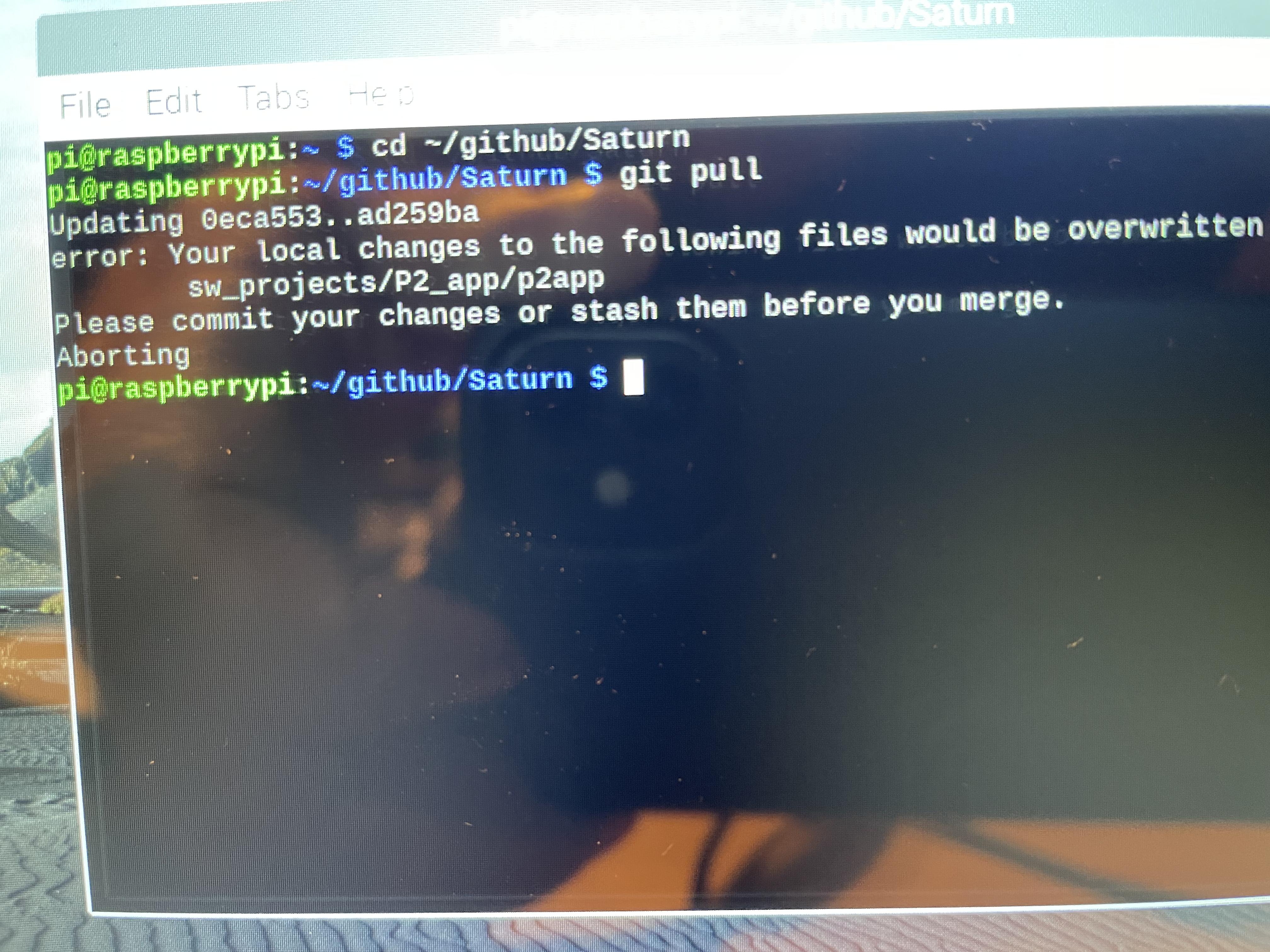

I just tried to update my G2 Software and Firmware.
I was able to update P2_app and audiotest following these steps.
When I tried the gitpull in the pihpsdr directory I received a message that my email address and name were not set up but the error message said to add them by using git config --global email address and user name. After executing these steps I ran git pull again.
This time I received a lot of Merge conflict messages. zoompan.c, xvrtr_menu.c, waterfall.c, vox_menu.c, vox.c, vfo_menu.c, etc, etc, etc,
After all the merge conflict messages there is an instruction to fix conflicts and then commit the result.
If I try running git pull again there is a message that says Pulling is not possible because you have unmerged files.
There are two hints. Fix them up in the work tree, and then use 'git add/rm <file>'
as appropriate to mark resolution and make a commit.
Not sure if deleting the files in the github/pihpsdr directory and rerunning the git pull would work as I don't want to mess up anything further...
George / W7GES

OK, we'll have to check how that folder was created in the repository that Apache labs provided. I've just been given access to it, so I can create a new SD card and experience the same set of files you have.
I suspect it will need to wait until Rick returns (I think this week) to know how to proceed.

It looks like libgpiod-dev may not have been installed in this release.
I have tried to recreate this using the Apache-Labs image and these steps work for me:
(change to your email and name) (only needs to be done once)
git config --global user.email "test@youremail.com"
git config --global user.name "name lastname"
cd ~/github/pihpsdr
sudo apt-get install libgpiod-dev
git reset --hard origin/saturn
git pull
make clean
make -j9
-Rick / N1GP

I followed Rick's steps.
When I tried to install libgpiod-dev a message said it was already installed and not updated
I ran git reset --hard origin/saturn
git pull gave me a message nothing to pull
ran the make clean and make -j9 and install was completed.
I ran the flashwriter
Restarted the G2 and now the pihpsdr Build date is 2023-08-22, Build version is 2.0DL1YCF, WDSP version is 1.23
FPGA BIT file data code = 23082023
Product: Saturn; Version =2
FPGA firmware loaded: Saturn prototype, full function; FW version = 8
p2app client app software Version:13 Build Date: 23 Aug 2023 18:20:36
I updated Thetis also and now line in (L) works with my N1MM / Presonus Studio 192 configuration.
XLR / TRS Balanced mic input works as well.
Thank You!!
George / W7GES

Make clean removes files created in the build process. The merge issues suggest there are files in the folder that aren't the same as was in the git repository. normally there is a hidden file ".gitignore" that tells git to ignore build files but it's possible that isn't ignoring everything.
doing make clean first then git pull might have a different result?

yesterday my piHPSDR update was succesfull, but git pull of Saturn FW/p2app failes due to this attached error. Any idea?
TNX

I suspect you have done a git pull, built the code (creating a new p2app executable) then done a git pull again.
delete p2app executable and re-do git pull

laurencebarker wrote:I suspect you have done a git pull, built the code (creating a new p2app executable) then done a git pull again.
Thanks from me Laurence, realized I had same error as Volker, I just renamed it and everything fell into place.
Thanks again for you help!
Richard

Hi Volker,
In this case you can perform a 'git stash' before the 'git pull' to save your current directory.
Use git stash when you want to record the current state of the working directory and the index, but want to go back to a clean working directory. The command saves your local modifications away and reverts the working directory to match the HEAD commit.
73 Bernhard , DL1OF

Right now, my screen looks like your screen save of the error.
Please clarify what you mean by "I just renamed it and everything fell into place". What did you rename?
Tnx Torrey N9PY
Re: G2 Software and Firmware Updates 27 Aug 2023
I just went into the folder that had the p2app executable in it and renamed that one file. And gitpull didn't see it and got the new file
Richard - KI4P
