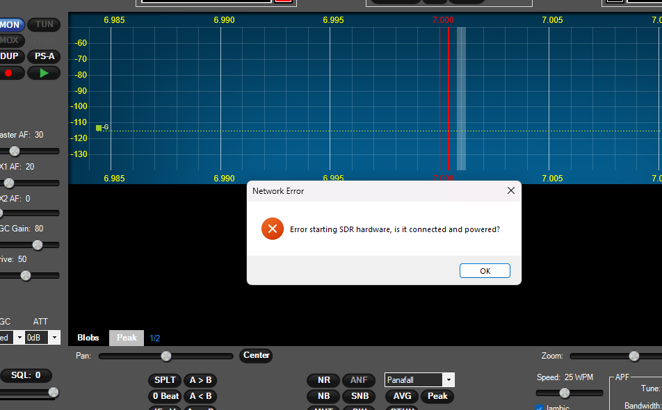

Oh boy no joy for me. I must of glitched something. After update radio can't be found. Is there a way to revert to the older P2APP?

Re: G2 Updated files and simplified update procedure
"Error starting SDR hardware, is it connected & powered" implies that p2app isn't running after power up. This shouldn't have been changed by the update process.
I'm assuming that you have a radio with no display on the front and it used to autostart p2app after power up. (If you have a display, you need to run p2app manually and there should be desktop icons for that)
Firstly please check whether the p2app executable actually got created in the correct location:
ls ~/github/Saturn/sw_projects/P2_app/p2*
(that should list 3 files; p2app,c, p2app.o and p2app with no file extension - that last one is the executable)
Next see what the autostart file contains:
cat /etc/xdg/lxsession/LXDE-pi/autostart
(That should dump a file with 4 lines, as per the Saturn manual section 4.6; the content depends on whether you have a front panel display)
va7qi wrote:Did you do a complete shutdown of the radio after updating software?
By complete I mean holding the Power button down for 10 seconds AFTER Linux has been shut down.
73 de VA7QI, ....Erik.
Yes I did

I'm having the same issue as the others here with Thetis does not seeing the radio.
My radio has been down for 3 days now.
I have the early G2 no screen with the CM4 without the microSD installed.
F/W V19 installed.
When I try to perform the update it seems to complete without error but if I try to run the p2app I get the message "Invalid desktop entry file"
Not sure what to do, Not very knowledgeable with Linux.
But I can follow direction, If someone can post the exact steps IN ORDER and line by line so I can be sure it's not something I'm doing incorrectly.

- Posts: 304
if you have no display, how are you running p2app: is it set to autostart, or do you plug in a display and keyboard, or log in remotely?
"invalid desktop entry file" probably means that the desktop "shortcut" file can't find the p2app executable itself. It is a very small file that essentially points to the program you want to run.
please try the following:
cd ~/github/Saturn/sw_projects/P2_app
ls
(it is case sensitive)
and see if there is a file "p2app" there with no file extension. Its creation date should be the date you did the update. There should be a lot of C source code files (*.c, *.h) and object files (*.o)
for development work I run p2app from a command line:
./p2app
does that work?
ls
./p2app
does that work?

"if you have no display, how are you running p2app: is it set to autostart, or do you plug in a display and keyboard, or log in remotely?"
I have a keyboard, mouse & monitor connected to get into the G2.
I ran these commands:
ls
And don't see the P2app without the extension.
I see:
p2app.c
p2app.o
My G2 is from the first batch and has the RaPi with the onboard memory currently my SD card slot is EMPTY!
Could this have something to do with it?
Just a Note: I have run these updates before and other than a "Permissions" issue they worked before, But for some reason this one doesn't work for me?
ls
I see:
p2app.c
p2app.o
- Posts: 304
If you don't have p2app (no extension) then I suspect its compile failed. I know someone else who is compiling p2app on a slightly different system from mine, and what my system reports as "warning" results in an "error" on his, and we are slowly working through those issues (his compile stops at the 1st error, and I can clear the issues up to that error), then he has to compile again and it snags a few files down the list).
Please try the following to see if we can make some progress by manually compiling:
cd ~/github/Saturn
git pull
cd sw_projects/P2_app
make clean
make
Can you then copy out all the messages from the window please? I'm particularly looking for reported errors. If there are some, we will resolve them.
cd ~/github/Saturn
git pull
make clean
make

- Posts: 304
by the way - having on-board memory vs SD card will not be behind this. Having a displace vs no display is very unlikely to be be involved. What system updates have been performed could be involved, and what OS you have could be involved (mine is 64 bit but many others are 32 bit).
But the change that's made a difference must be recent. The new script simply carries out the same steps that used to be manual operations so it at least shouldn't be responsible.

gcc -c -o g2panel.o -Wall -Wextra -Wno-unused-function -g -D_GNU_SOURCE -D GIT_DATE='"30 Jan 2025 19:56:29"' g2panel.c
g2panel.c:33:10: fatal error: gpiod.h: No such file or directory
#include <gpiod.h>
compilation terminated.
make: *** [Makefile:24: g2panel.o] Error 1
Try doing:
sudo apt install libgpiod-dev
and rebuild
and rebuild
That worked!
Thank You Richard.
Here is what i typed to fix my specific issue:
1. sudo apt install libgpiod-dev
waited to complete
2. cd ~
3. ./github/Saturn/scripts/update-G2.sh
Waited to complete
4.Then restarted.
Thank You Richard.
waited to complete
2. cd ~
Waited to complete
4.Then restarted.

Discovered NEW Issues with update....
Now the OC control output is now incorrect, For example when i am on 40m my amp now goes to 160M, Thetis shows the correct Pin State? Worked perfect before the update.
After the update Still cannot open pihpsdr app. (File not found)
