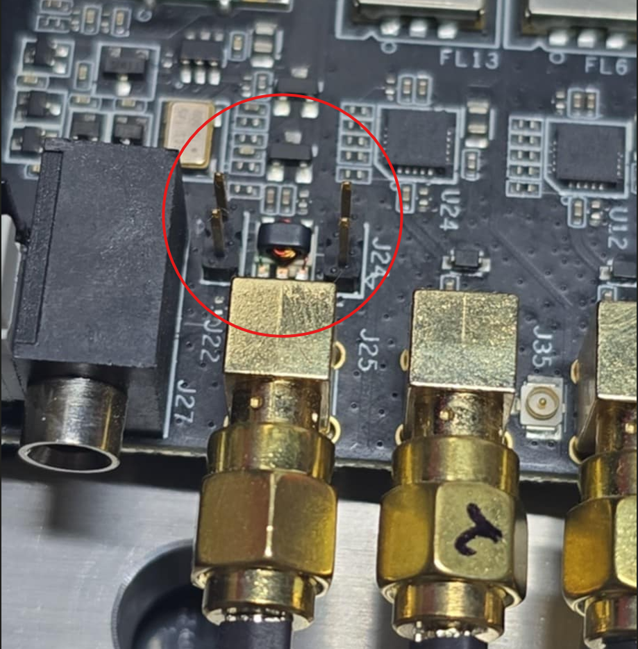

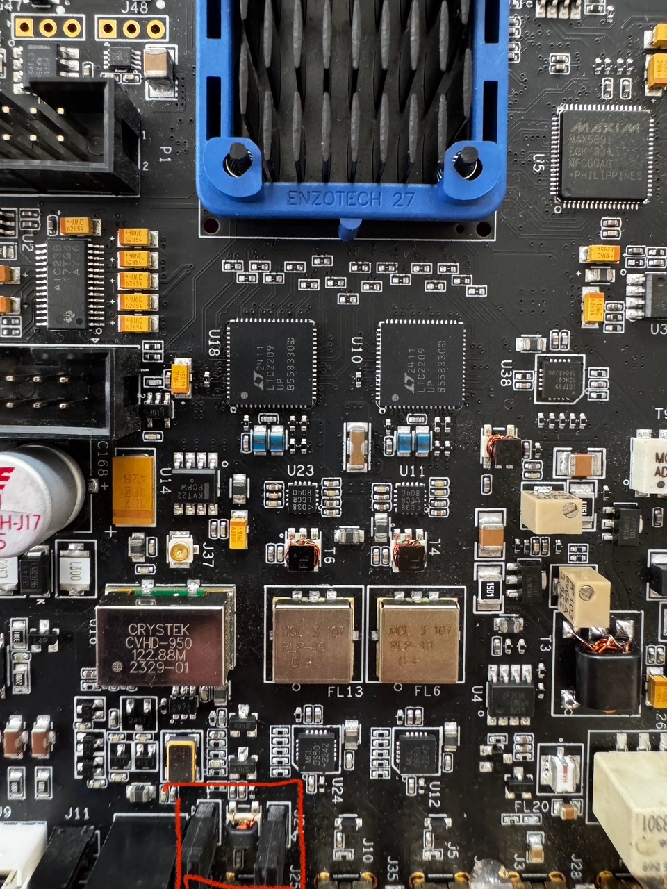

Distorted audio on 15 & 17 M from radiated RF inside my G2 Ultra near the 10 Mhz reference input finaly FIXED and hopefully for ever.
I wish that's the factory had fix this problem before selling it , not just to prevent drama by many user of G2 radio but especially to save alot of money by unnecessary high cost of ferrites to buy .
I wish Apache Labs had more transparence about this problem .
Thanks to Tony to have let me know :
«The fix to this issue is adding two jumpers to the 10Mhz Input circuitry on the Saturn card, the input as shipped is floating hence is picking up RF, please place a jumper on J22 and J24. Attached picture of the Saturn card with the jumpers marked.»

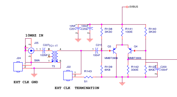

Below is a snippet of the Saturn schematic. This is the exact same 10 MHz external input circuit that has existed since the Hermes.
Rather than placing the jumpers as described, I wonder if it would be enough to place a 50 Ohm terminator on the 10 MHz external input connector?
Re: Distorted audio on 15 M and then on 17M finaly FIXED
w-u-2-o wrote:Interesting! Thank you for posting this!
placing a cheap 50 Ohm terminator (1,50$) fixed it on my G2 black face, so no need to open it. Very nice, thanks a lot.

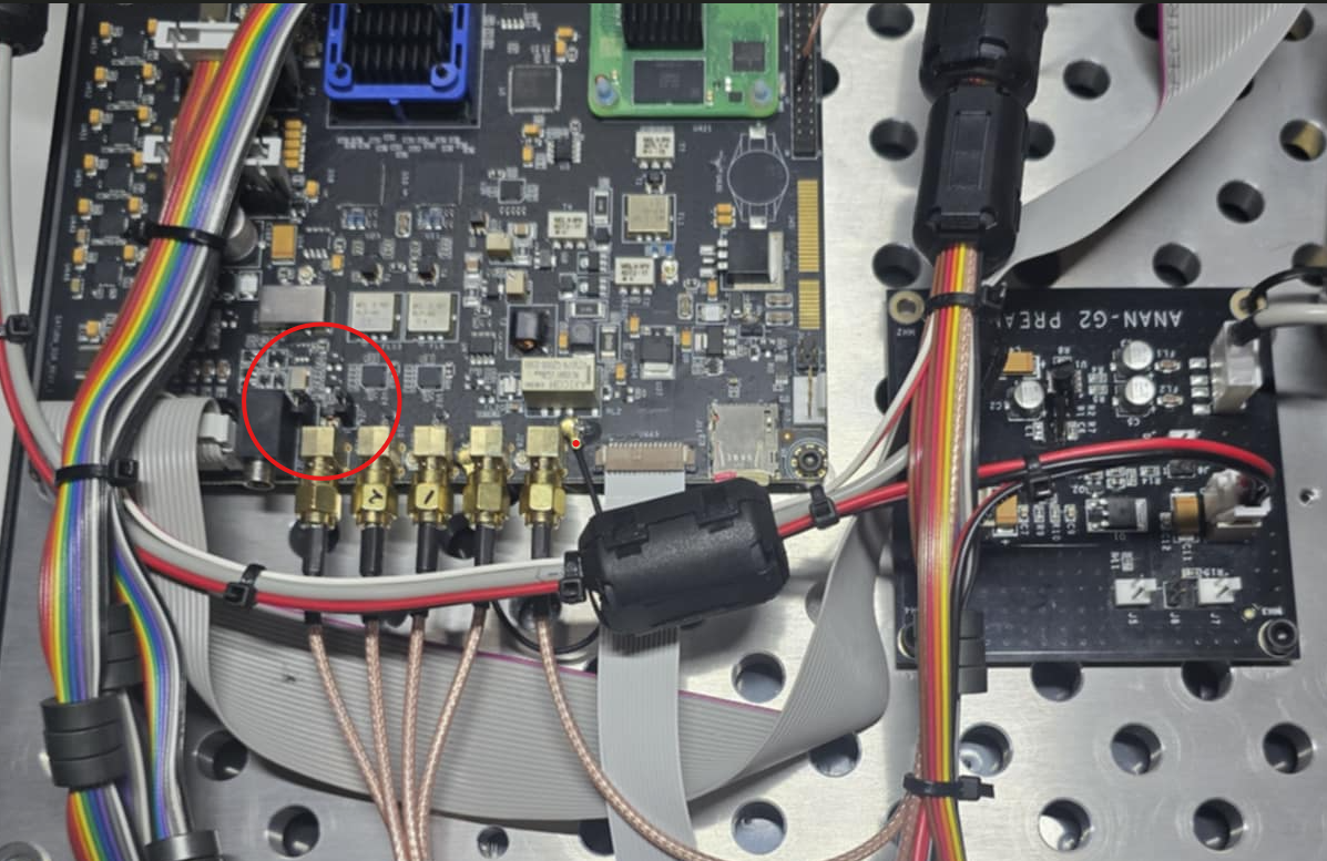

Received my G2 a few weeks ago. The first thing I did after updating my pi as pihpsdr wasn’t installed, was to open it up and clone the SD card. I also was going to remove the jumper. No jumper was installed, interesting.
Vin KD1GA
My G2 Ultra had PiHPSDR installed. But, not setup to Autostart. I looked inside and both of the jumpers mentioned were already installed from the factory. I had to go and change the settings for the Kenwood as it came setup to use the UK keyboards. I switched to the US keyboard setting and I was able to edit things like the Autostart file easier. ( other than pilot error)
I haven't encountered any transmit problems so far.
