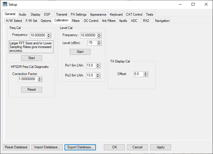

I'm having a hard time determining if there's any way to see in PowerSDR mRX v3.4.9 -- or on my Anan 100D itself -- whether it is correctly receiving input from my connected GPSDO. (Very possibly my eyes aren't sharp enough while looking at the display, or I'm using the wrong search terms in going through the docs.)
Can anyone refresh my memory on this? Or is it the case that there isn't any such display, and I need to note signal frequencies when I connect and disconnect the external reference? Thanks for any possible help.
How to determine that an external reference is active?
Re: How to determine that an external reference is active?
If memory serves you could uses the Freq Cal on the calibration tab and the correction factor should be 1.00000000 if the GPSDO is connected.
Thanks! Found that (under Setup > General), and the correction factor is showing as 1.00000000. I'll assume that's good.

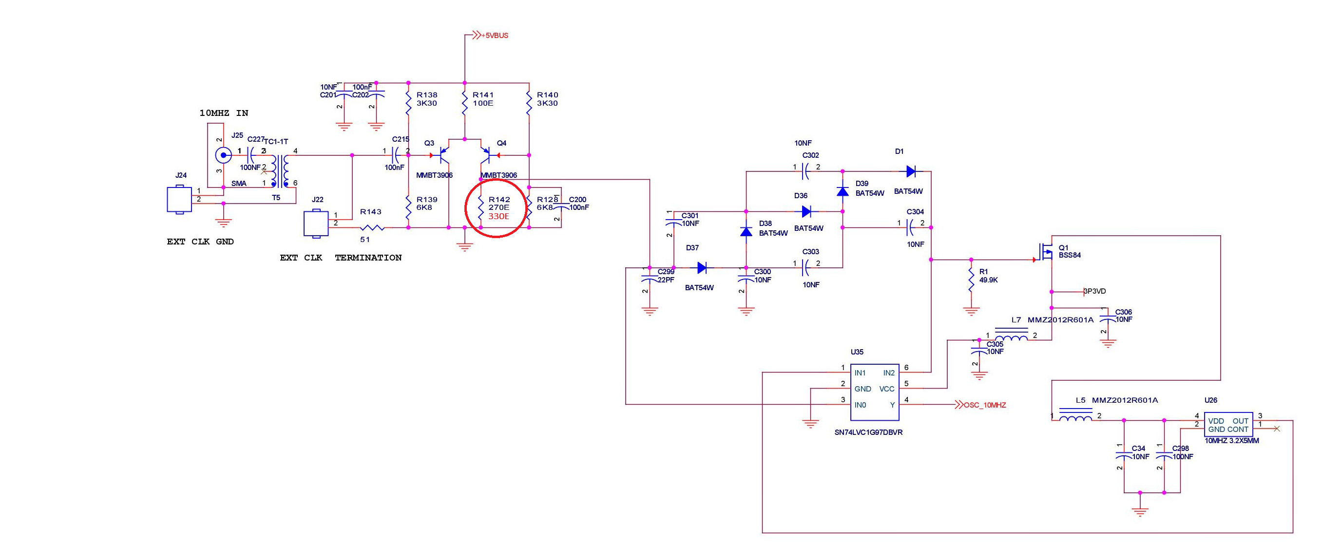

I had a problem with my blue face 7000DLE 10 Mhz ref input not wanting to recognize the +14db sine wave output of my Trimble Thunderbolt.
While it was at Doug's for the repair of the output LPF values, he noticed that it would accept a square wave but not a sine wave.
After a a little experimenting, Doug changed the value of R142, a 270 ohm resistor to a 330 ohms.
That made the circuit work properly.
He said he would notify the factory to implement this change on the Orion MKII boards.
BTW, I added a jumper to J22 to load the input with 50 ohms to bring the +14db down to a safer level.
Don W9BHI
Don W9BHI

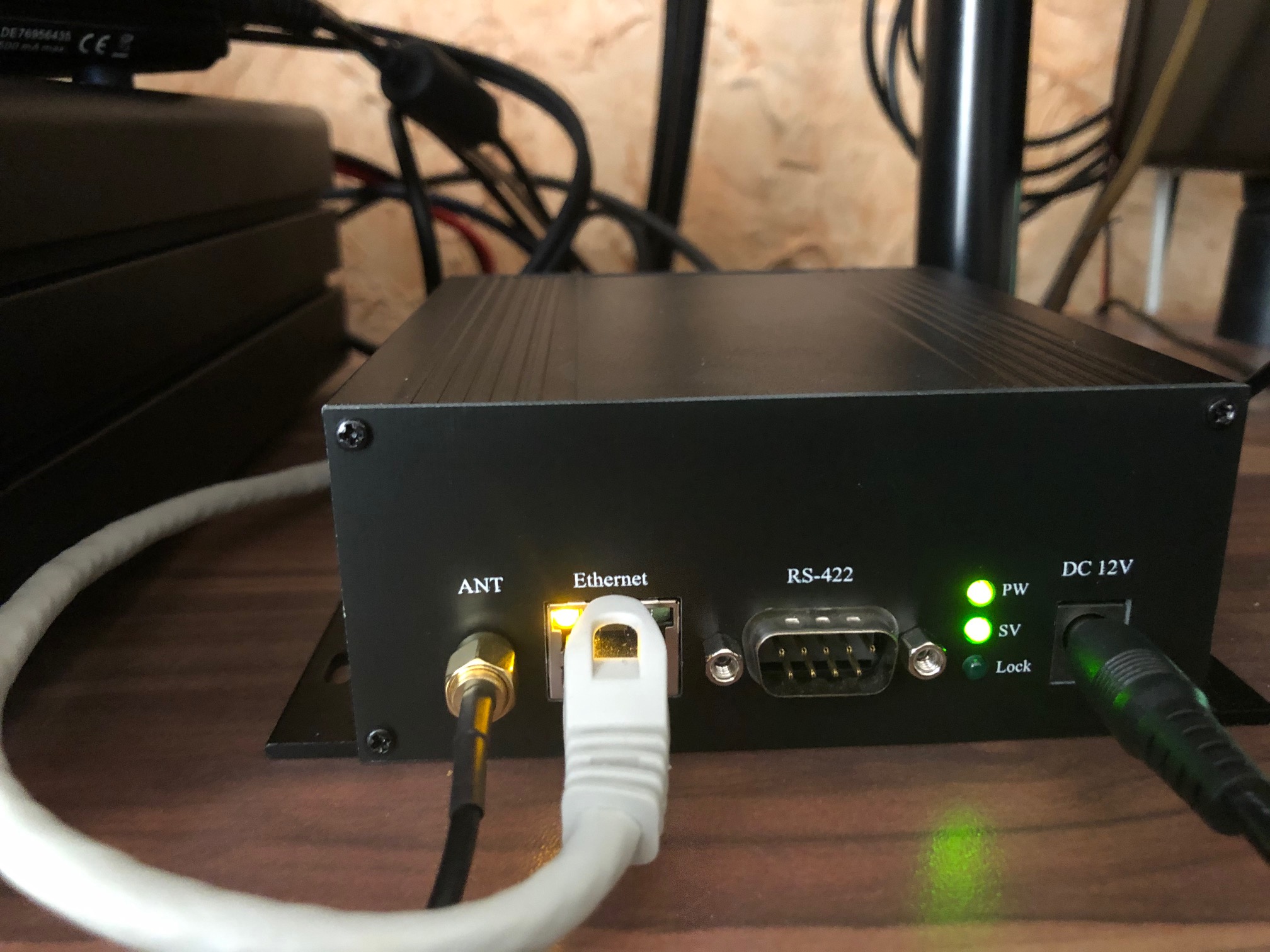

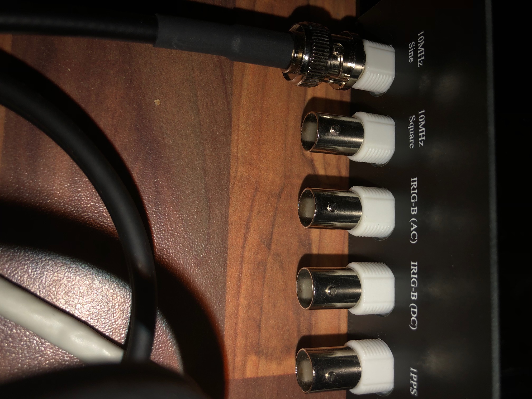

just installed my new GPDSO with NTP-Server
Now I have exact calibration in Thetis and exact time on pc, even if the internet were down.
