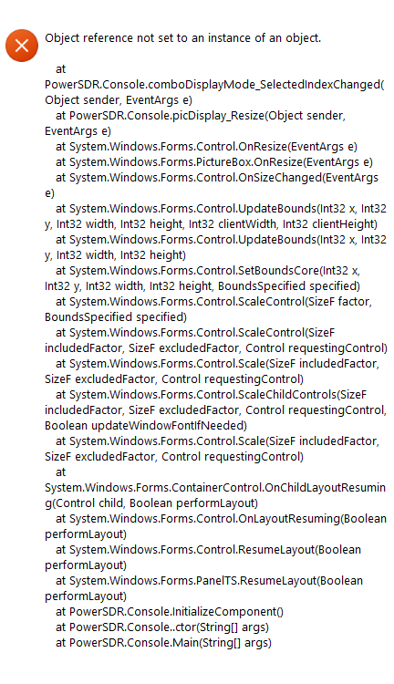

I my be having the same error on versions 3.4.9 and 3.4.8 but 3.4.7 loads fine.
I will check my Display settings
Here is the error I'm getting
Bret
WX7Y
PowerSDR version 3.4.9 and 3.4.8 Error.png (45.48 KiB) Viewed 14702 times

My Display settings was set at 113% and I set it for 100% it finially loaded, wow lots of frustration.
Getting the Computer for the new 7000DLE MK3 when it finially shows up from HRO as reading it won't work yet with version 2 firmware and Thetis.
