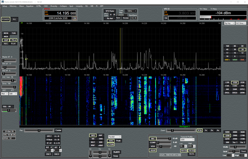

How to get both waterfall and panadapter to display as a spit screen? Choosing from the main window dropdown only will display one or the other.

dieseldawg wrote:How to get both waterfall and panadapter to display as a spit screen? Choosing from the main window dropdown only will display one or the other.
Greg
Select "Panafall".

In Thetis D3 selecting 'panafall' brings up only the panafall, panadapter disappears, In my install at least. Didn't expect this to be a Thetis issue, so I posted here.

Greg, can you do a screen capture to show what mean? Here is my D3:

Scott, I reinstalled D3 and now it is working OK. But berfore, the entire area was waterfall with no Panadapter. Can't get it back now. Wiil post if it happens again.
