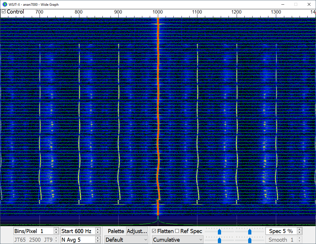

A while ago I posted a topic about "ghost" decodes I was seeing on FT-8 with WSJT-X (see viewtopic.php?f=6&t=3431&p=11398#p11398).
Today, I was finally able to pin down the cause, and it is the rational resampler. Attached is a shot of the WSJT-X waterfall showing an S9ish unmodulated carrier. At the bottom the rational resampler was turned off. A couple of minutes later, I turned the resampler on and you can see first an immediate frequency jump followed by a long period of wander while the resampler settles down. You can also see the strong 100 Hz spurs that appear at the same time. After 10 or more minutes, the resampler seems to stabilize and at that point the spurs go away -- though anecdotally I've noticed that CPU load or temperature changes can cause another period of resampler "hunting" and accompanying ghost decodes. (I turned the resampler off shortly before the end of the run; you can see the small noise burst near the top when that happened.)
I don't know what is causing the 100 Hz spurs, but they are certainly tied to the resampler's action. They are related to the strength of the signals in the passband; with an S5 signal the spurs were noticeable only for the first minute or two after the resampler was turned on; with a stronger signal, they were there as shown in the attachment.
At this point I haven't tried the various resampler options to see if they resolve the problem; it may just be that in my case leaving the resampler off is the best answer, as I don't see glitches. I'm just happy knowing where the ghosts were coming from, and that I can eliminate them!

Seems a reasonable conclusion you've come to ...
I've not bothered with the resampler for a long long time. Just don't mess with it. Seems almost a solution looking for a problem. Since perturbations in CPU action elsewhere cause clicks and jumps in the TX signal - and since these also induce the resampler to 'start anew' it just seemed fruitless. I've had very good success since I've stopped obsessing over it and setting the affinity. Still have jumps occasionally.
I swear one update from Microsoft maybe a few months ago improved that situation - as if they finally recognized that THEY are causing havoc to programs at times by poor core management ... note I mention TX and you're here focusing on RX ... but I believe they're one in the same.
did you try just not using it at all? Apologies if you mention that earlier on. I know I'm comparing apples to different apples somewhat as I am still using 3.4.9 and not Thetis which you are - but I believe the outcomes are the same. I see mention of setting "FORCE" using Thetis so not sure there's been any overall improvement in the action of the resampler.

Just a minor point of clarification: it is the "variable resampler" not the "rational resampler". This capability was first released in PowerSDR 3.4.8:
https://apache-labs.com/community/viewtopic.php?f=6&t=2763&p=5184&hilit=variable+resampler#p5184
In contrast to Gary's experience, I've found that using the resampler substantially improves (decreases) the number and severity of the audio artifacts (glitches, etc.) that I notice. And, if you look at my earlier posts in this topic, I do not observe any significant instability in the resampling rate, i.e. the signals are rock solid in WSJT-X et al.
Obviously if you are getting the performance you want with the resampler disabled then perhaps there is no point in trying to get it to work better. However, I'd suggest trying to pare down your VAC buffer size and VAC buffer latency settings (both RingBuffer and PortAudio) to the minimum that provides you with reliable VAC audio. This may improve resampler performance for you.
The only problem I have experienced with the resampler is that it will periodically go unstable on me, particularly when starting Thetis. To reset the resampler I will uncheck and recheck the "Manual" checkbox on Ringbuffer In setting. Sometimes it takes a few tries to get it stable again. By "stable" I mean that all over and under-flow counters have stopped counting. If you see them counting then your resampler is not stable and you will definitely get poor results under those conditions.
