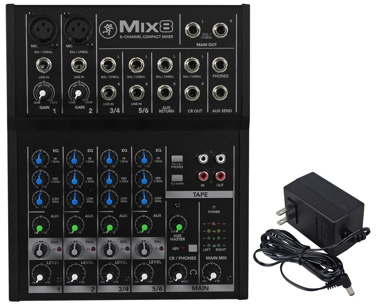

If you've got that many analog devices to mix/switch into the line input, then you've almost certainly got a mixing/switching device as well. In which case, why not simply put the microphone on the mixer as well and route it there? That way you can leave the radio set to line in all of the time.
BTW, for contest voice keying, the most popular solution is a software one, N1MM+. That uses VAC, so no line in required. As for DAWs, that would also generally be a VAC connection, not line. DAWs can also be used for voice keying and record/playback (as well as the built-in record/playback facility).
If you do think the idea of an external mixer has any merit, I would recommend something from Mackie. The Mackie Mix 8 pictured below is only $80 on Amazon.
