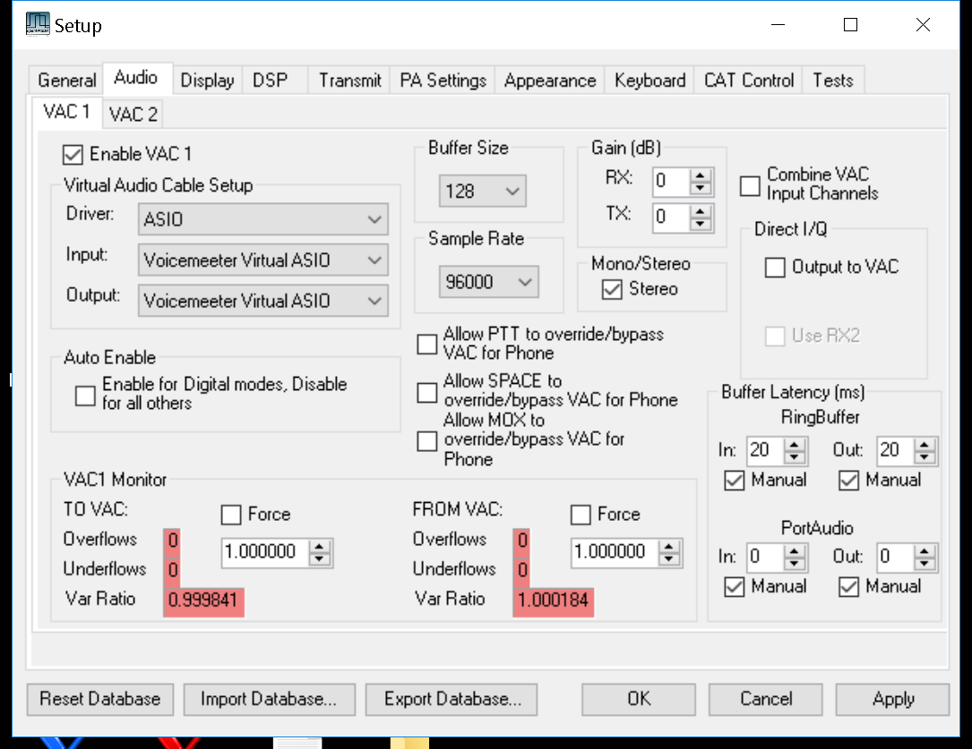

Re: Resampler Adjustment
Here's a screen shot of current audio settings. I noted that at these settings, not only am I getting glitch free audio with no over/under runs, but the Var ratio is as close to "0" as I have ever seen it, whatever that might indicate.
Hi Brent,
Looks like you’re making good progress there now.
The PortAudio latency setting is exactly the same thing as the old buffer latency setting in PowerSDR, only the name has changed. In Thetis we now have separate controls for input and output, whereas In PowerSDR they were ganged. Doug and I were worried that having separate controls would make things too “busy” for the user and cause unnecessary confusion. So we decided to just see how things went during the beta and change it back to the old way if it caused problems for the users.
In any case, the PortAudio latency setting has no relevance whatsoever for ASIO drivers. The ASIO API has no latency setting per se. It’s not clear what PortAudio does with that setting when running ASIO. I’ve asked about that on the PortAudio devel list and never got a meaningful answer. I can’t imagine any reasonable ASIO driver that would benefit from having that set to anything other than zero.
The Ringbuffer setting is new for Thetis. In PowerSDR that was a “one size fits all” setting that was calculated in the background, based on several other settings and some assumptions about how well behaved the thread scheduler was in the user’s computer. In Thetis, the user gets to decide how far he wants to push the envelope with respect to latency and glitch free operation. You did exactly the right thing: start at 120ms and very slowly work your way down a few ms at a time.
The user may profit from an indicator showing the actual ringbuffer size in effect. Users may also profit from indicators showing what settings are in effect when the manual boxes are unchecked. Those sorts of things can certainly be added in future releases if need be.
73, Bryan W4WMT

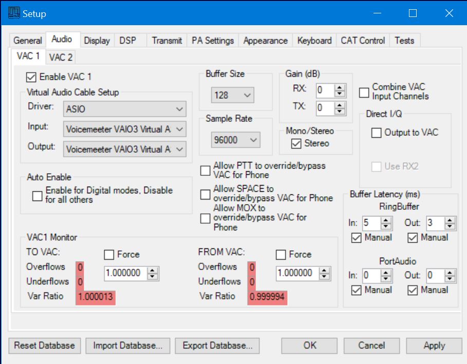

It remains a mystery why so many people are having such trouble. There is clearly something we all don't understand about how buffers should be set. Most serious audio software adjusts buffering in a completely automatic way with no significant latency. Any DAW application is a good example of this. If any developer wants to tackle this I'd suggest looking at the open source DAW app "Ardour" for which the source code is freely available.
My audio setup is quite complex: Thetis, Reaper and Presonus Studio 192 Mobile all are connected to each other via Voicemeeter Potato using ASIO. I don't really need Reaper anymore but I enjoy the control it gives me over routing audio. The Presonus driver is set to a buffer size of 128 and a sample rate of 96KHz, as is everything else. Digi mode app's, when I use them, are also connected via Voicemeeter at 48KHz and Voicemeeter happily does the rate translations. With all Thetis audio processing turned off latency is less than 30mS between audio sink/source and the antenna (not fair to count latency added by Thetis audio processing like NR2 or the leveler, etc.)
Note that the reason I use 96KHz is because I had reached the lowest available VAC buffer size of 128 at 48KHz and things remained stable at 96KHz, hence buffers take half as long to traverse at the higher sample rate. It's not a big difference, but a millisecond here and a millisecond there and pretty soon you are talking about a lot of milliseconds
FWIW here is a screen shot of my VAC settings:
I have two, minor stability issues. Every once in a while Reaper does not start correctly and sound is messed up. I simply restart Reaper and it will remain stable for days at a time. And I get periodic instability from the resampler, which I correct by cycling one of the "manual" checkboxes in order to reset it.
P.S. Jeff: do you seek merely sidetone, or a true representation of your audio output? In either case you aren't going to get it from MON. IMHO, MON, as implemented, is useless except as a quick way to check that your VAC TX audio is not broken.
First, thank you for everything you do in support of OpenHPSDR and the Apache equipment, I hang on your every post.
My experience with Monitor appears to be very personal, and likely different from yours I expect. I find it very helpful, as it does seem to fairly represent my TX audio before it's converted to RF, and I like that. It renders my bandwidth and EQ faithfully, at least in my headphones. And as long as I can keep the latency ahead of my brain, I would rather listen to "Monitor" than a simple sidetone like Flex does.
Your VAC settings are IDENTICAL to mine, including the 96K/128 UMC, but my ringbuffers appear to be more stable at 20ms, with just a minor latency impact.
Jeff NJ2US
Jeff NJ2US

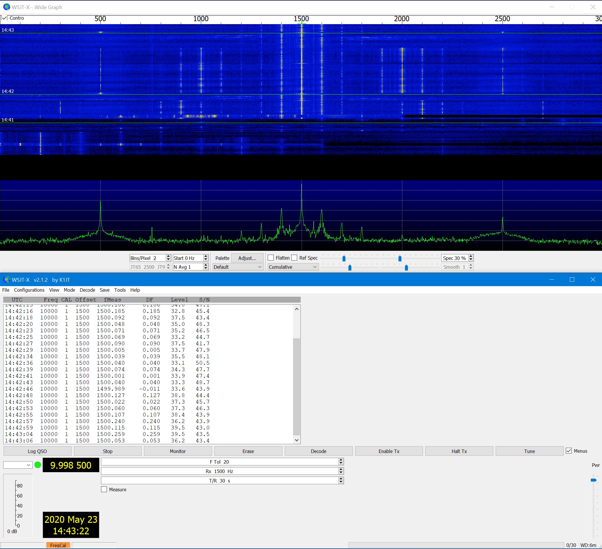

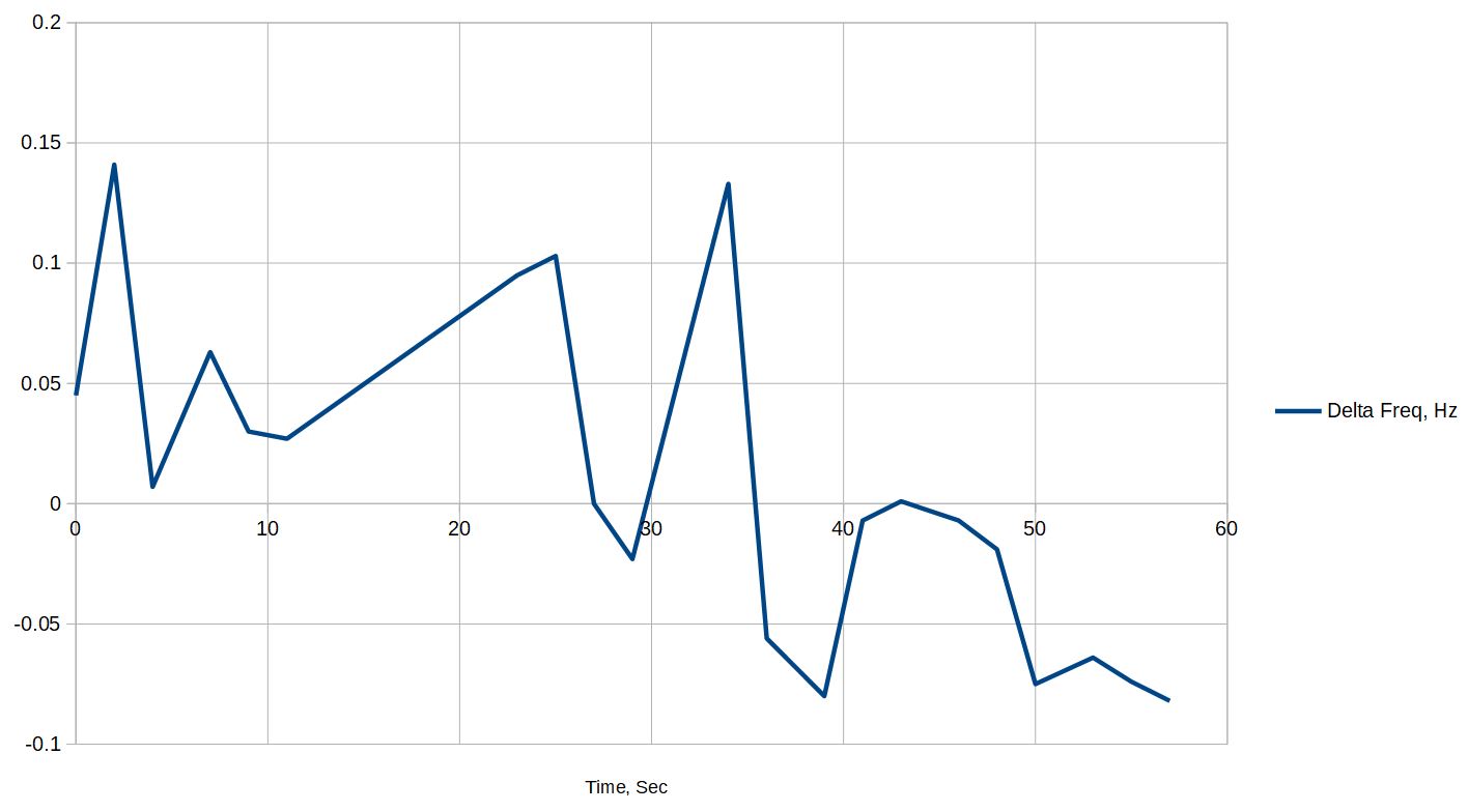

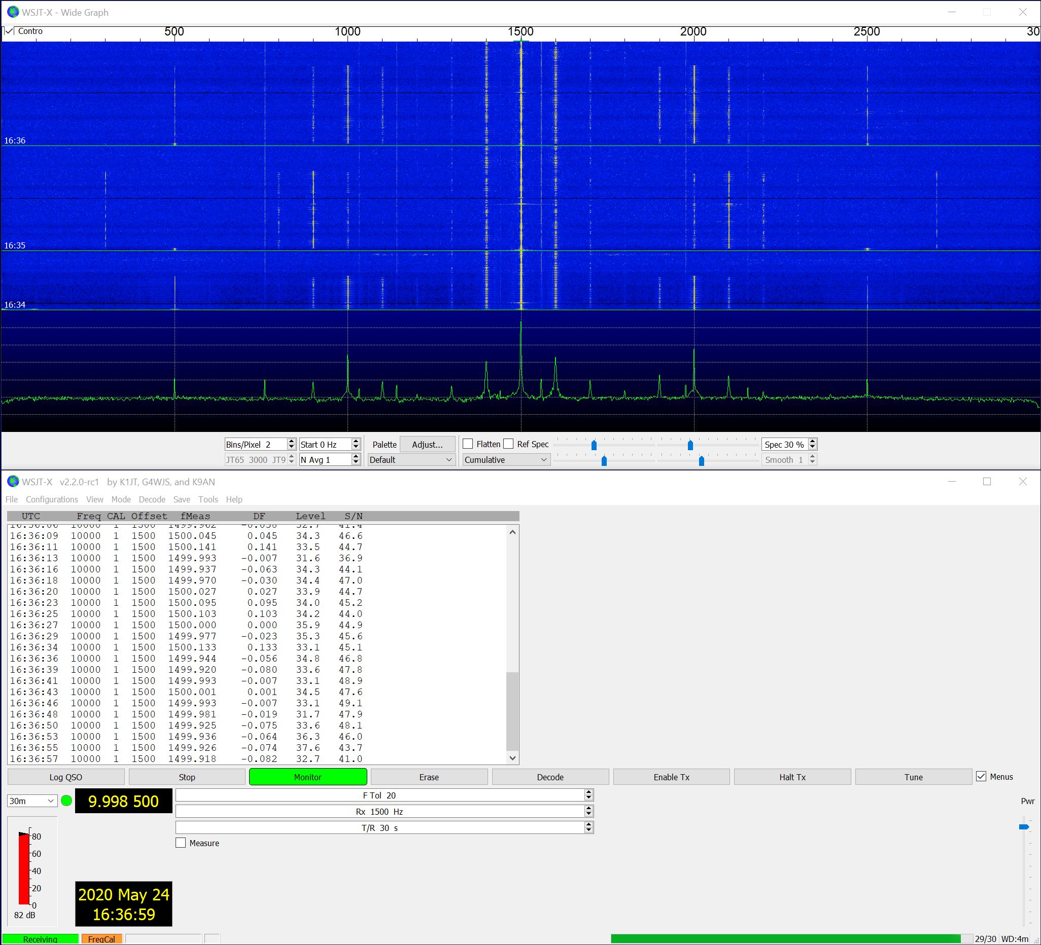

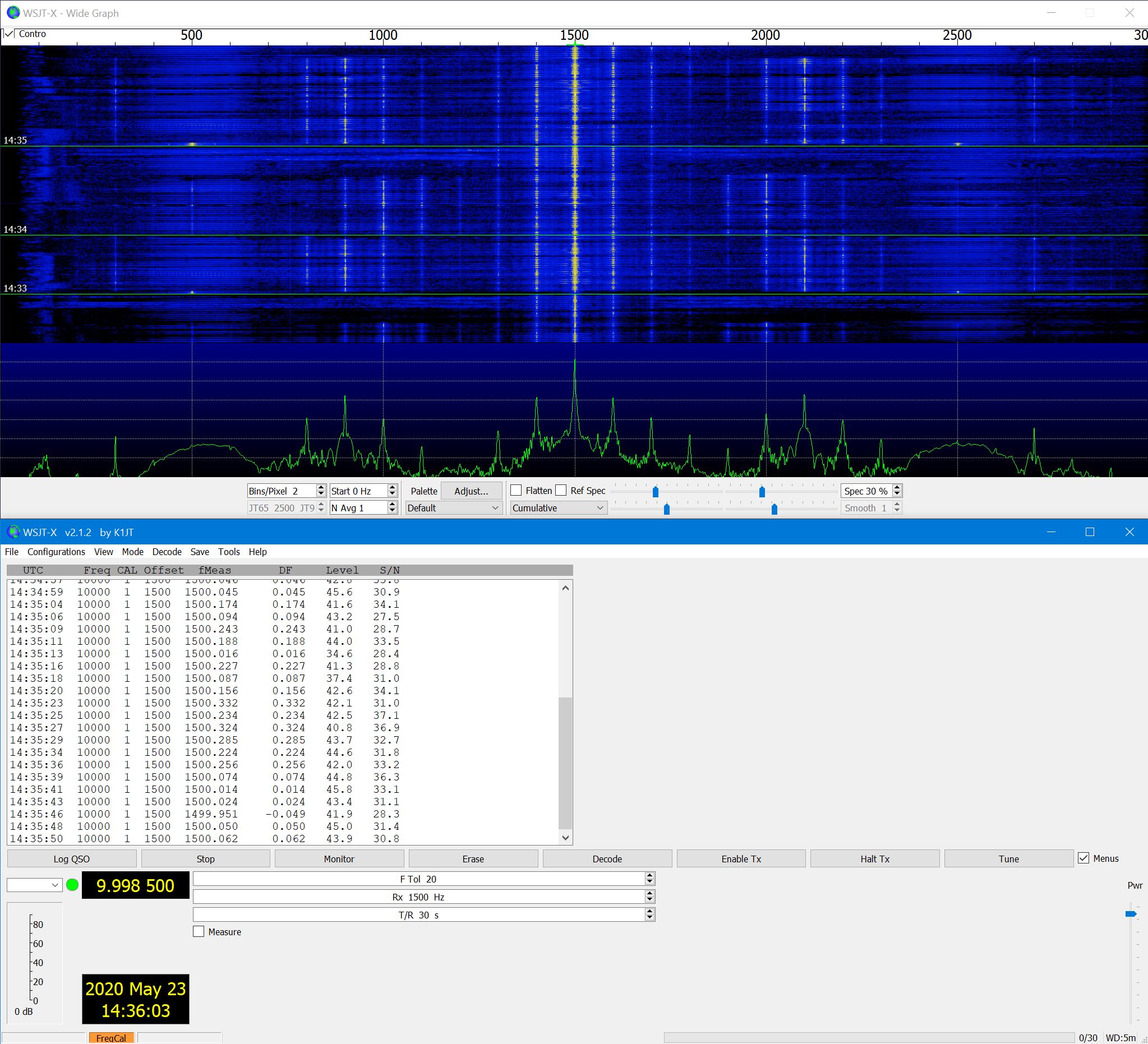

I've never been able to duplicate this problem. This is what I get with the resampler fully active in Thetis (and the same in PowerSDR):
Fast AGC, Linear Phase Filter, optimized ATT, I'm getting plenty of -24dB decodes (can you do better than -24?)

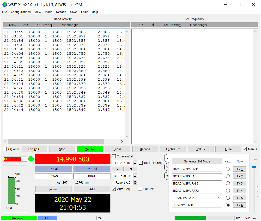

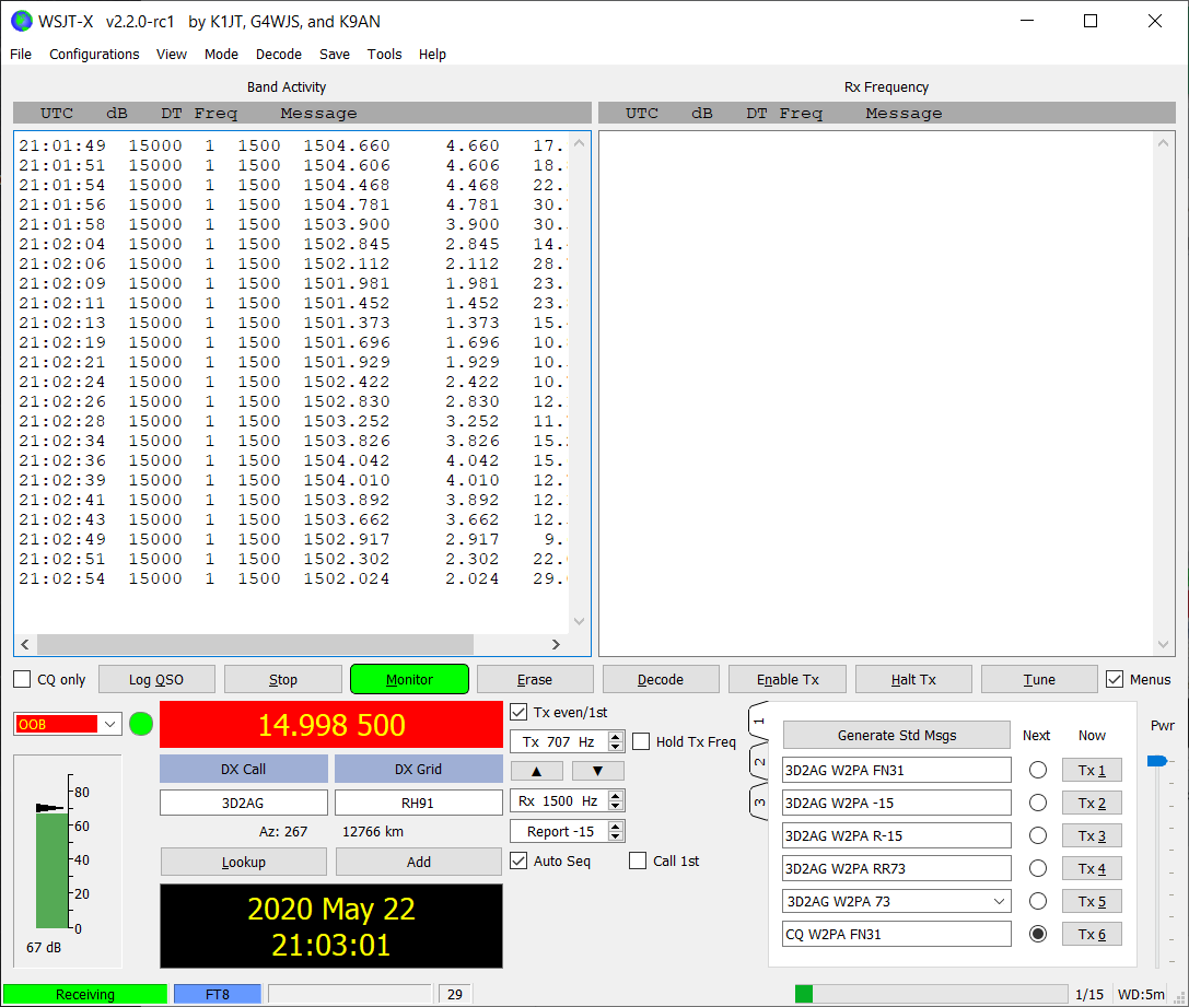

Hi Helmut,
Am I reading your waterfall display correctly? It’s sweeping back and forth approximately 25 Hz?
I don’t have FT8 running on my 7000DLEMKI, but I know it’s not drifting 25Hz, I would hear that instantly in SSB.
Does the sweeping eventually slow down and stop? The reason I ask is because the loop filter used in the adaptive variable resampler is huge and can take over 10 minutes to settle down (at some sampling rates).
Still though, drift excursions in the realm of 25 Hz is very hard to explain.
73, Bryan W4WMT
73, Bryan W4WMT
Helmut,
What happens if you uncheck all "Manual" checkboxes and adjust VAC buffer size to the minimum that will work properly?
Also, do you listen to the actual audio coming out of VAC to determine if it sounds OK, by ear? This is easy to do with Voicemeeter. Make sure you have a valid audio output device defined as A1 (speakers attached to your PC) and turn on the A1 route on whichever virtual channel you are using for Thetis (or PowerSDR). This can be VERY helpful in adjusting VAC settings rather than doing it by looking at the waterfall in WSJT-X.

Yesterday I got the idea to use WSJT-X’s FreqCal mode to do the frequency calibration on my 200D. WSJT’s FreqCal process is complex and goes through a variety of standard frequency stations to make a curve of needed offset vs. frequency. I wanted to just perform a simple cal at one frequency, so I deleted all the cal frequencies in its list except 15.000 MHz (WSJT-X: Settings > Frequencies > mode=FreqCal). Then I was able to run the frequency calibration continuously and observe the effect of adjusting in Thetis (General > Calibration > Freq Cal).
I was going to start tweaking the Thetis cal setting, but first I noticed something strange. The frequency error amount was continuously varying, by itself, up and down about +/- 2 Hz. The variation period also varied, but it was about 30 seconds on average. (2 Hz of variation is too small for me to identify clearly in the WSJT-X wide graph, even on the WWV carrier, but it’s easy to measure in the WSJT FreqCal mode.)
The WSJT-X measurement uses VAC, so one of my first thoughts led me to the VAC resampler in Thetis. It was turned on and seemed to be operating normally. On a lark, I disabled the resampler by checking both Force checkboxes. The frequency variation immediately became about +/- 0.2 Hz – a 10x improvement in frequency stability. I repeated this several times and confirmed the checkboxes were having this effect every time.
I have operated with both Force checkboxes checked for several hours on FT8 since making this discovery about freq. stability. There is so much randomness associated with FT8 operating (band conditions, number of station in the band segments), that I am hesitant to state this report: My success rate with making FT8 QSOs is greatly improved.
(By the way, I monitored for under- and underflows with the Force checkboxes checked. The Var Ratio numbers stayed very close to 1; i.e., >0.99 and < 1.01. Under and overflow numbers stayed at 0. No audible glitches on RX or TX.)
I Googled to try to learn what the frequency stability requirement is for FT modes. The first useful link I found was http://www.w0wtn.org/downloads/n0dl/Introduction%20to%20Ham%20Radio%20Digital%20Mode%20FT8.pdf which contains "To decode an FT8 signal we need to determine its frequency within ~1 Hz...", written by K1JT. Later I found http://laarc.weebly.com/uploads/7/3/2/9/73292865/ft8syncv8.pdf, which says "FT8 requires that transmitting stations and receiver be synchronized to better than 20 ms in time and 1 Hz in frequency. Such precision is generally not possible with amateur radio equipment using external reference locks, so the protocol must supply its own synchronization signal. The different WSJT-X modes accomplish this in a variety of ways, depending on the design requirements. FT8 uses a 7x7 Costas Array."
Hmm… so FT8 should be able to self-correct some frequency errors. Perhaps the +/- 2 Hz wobbulation caused by the resampler disrupts the FT decoder’s ability to perform its internal synchronization.
73, John

Not seeing this problem here. Running Thetis 2.7.0 (a3). I used WWV on 10MHz around 1030 local time in DIGU mode as the calibration signal. Resampler on or off, I saw some wobbulation (I love that term
) on the order of +/- 0.2Hz, and during any 15 second epoch (commensurate with FT8 transmission length) it was typically but not always much less than that.
I need to do this experiment over again with a signal generator so that I can remove ionospheric variability from the measurement.
If you are having trouble with the resampler and wish to use it try changing your VAC buffer size and/or ringbuffer settings.
Pay no attention to the WWV sidebands in the plots below, they changed like crazy depending on what was being modulated by WWV at the time. Only the carrier counts. Band conditions also changed quite a bit over the 20 minutes I played with this.
Resampler ON:
Resampler OFF:
Resampler ON:
Resampler OFF:

Posting my results, using latest versions of SW and FW on ANAN-8000DLE. One is re-samper-on ("Force" unchecked) and one is re-sampler off ("Force" checked). In a one-minute time period at 15 MHz (WWV), I get 0.297 Hz variation checked, 3.4 Hz unchecked - a factor of 11.4 difference in "wobbulation".
(BTW, notice on the right, I'd just earlier worked 3D2AG on 17m with re-sampling off. I'd been unable to get a reply with re-sampling on. Off took 2 calls.)

I just did another test with 2.2.0RC1. No difference. It was a bit better, but I think that's because the ionosphere for this trial was less active.
I also plotted the frequency deltas versus time. No real pattern, which again suggested random, ionospheric induced propagation effects.
