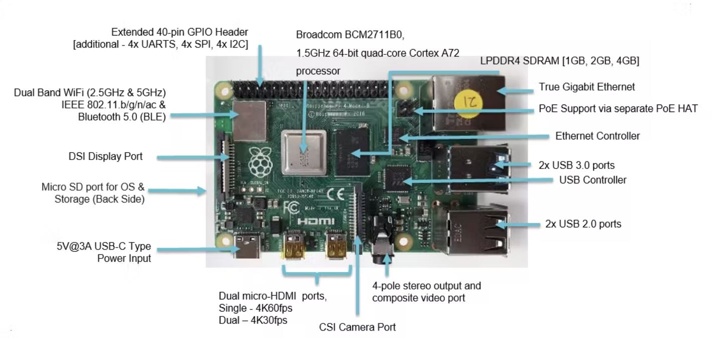

Om my V2 Controller there are four connectors on the top panel, one audio connector, one small C shell connector, I call it a mini-hdmi and two others, even smaller connectors, of the same type. As I cannot seem to post a picture, it is difficult to describe, but maybe it is a slightly different version on a Raspberry pi B3+ board. Either way, I don't know fully what they do, except for HDMI.
It sounds like it's using a Pi 4:
Unfortunately I can't help you with the rest of it as I have no Controller V2 here to experiment with.
