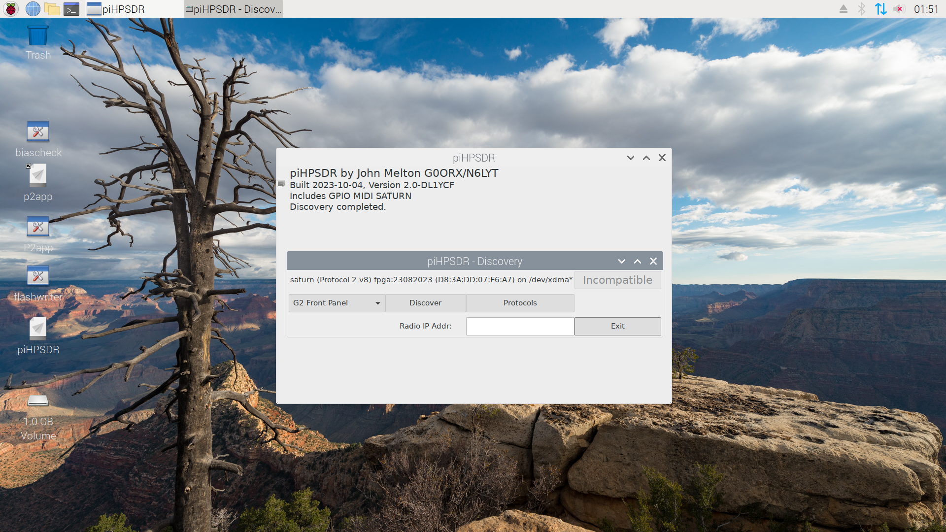

The pihpsdr app isn't working after the last update! Upgraded many times before with no issues, now I get something that says something is incompatible.

- 2023-10-05-015153_1920x1080_scrot.png (2.63 MiB) Viewed 11777 times

There has been a lot of work going on this past week or so fixing bugs
and improving operations.
There will be an announcement soon of the work being done and upgrade
instructions.
For now please try upgrading again, I pushed a change to allow your current
firmware to work with pihpsdr.
-Rick / N1GP

Rick,
OK, I upgraded, and pihpsdr is working again!
