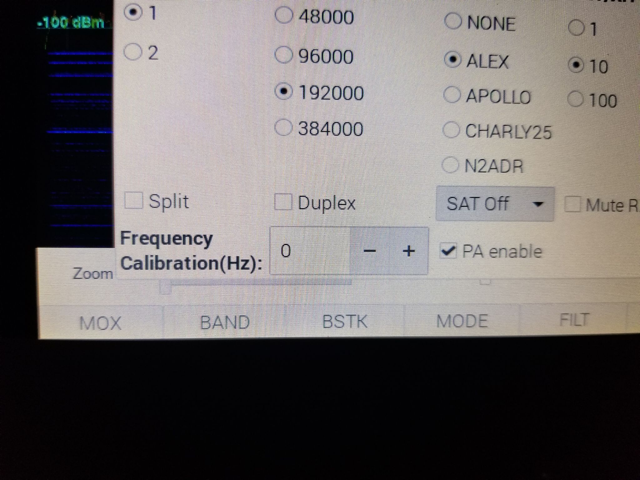

Just a Follow up
I answered My own question accidently
Swapping to a Pi 4b from a 3b was not as plug and play as it should have been, suffice to say I had to start from scratch OS wise
so also loaded the newest PiHpSDR
And there it is...Frequency calibration right there in the Radio setup menu.
I might add this is Version 2.0.8-rc1

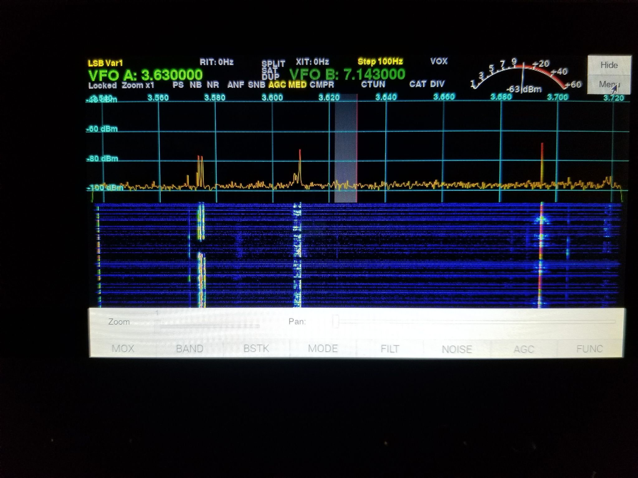

Oh My God what a difference and some very nice updates.
If you see this John (G0ORX) and the rest involved, Thank You so much for a neat piece of software
I`ll use this a bit more now.
Rick (N9HLL)
Sorry for the lousy pics I just snapped them off the controller with a phone..
