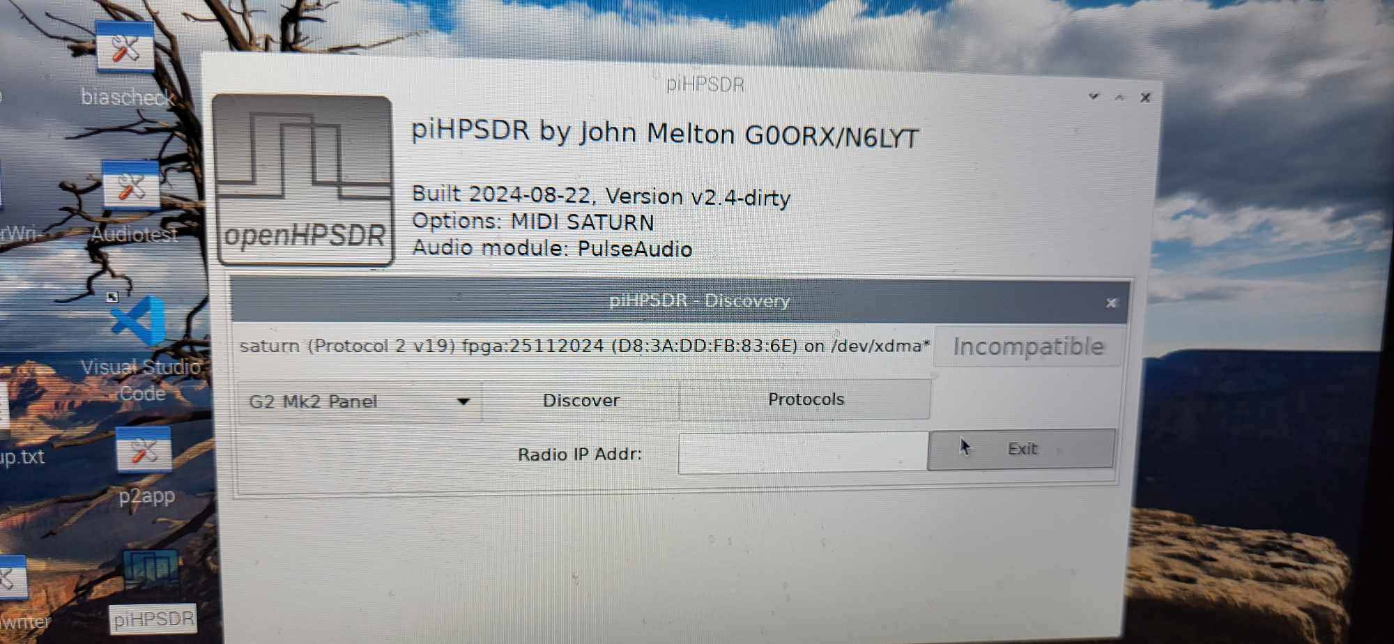

Even if i use my G2 ULTRA with Thetis I just find out that PiHPSDR can't be start anymore after i have update PiApp Firmware from V10 into V19.

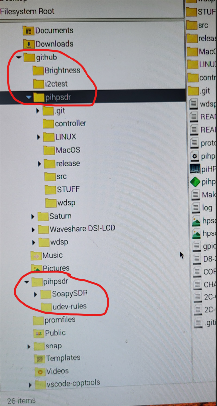

On my G2 Ultra i can find PiHPSDR under the following path or route :
home/pi/github/pihpsdr
and the other :
/home/pi/pihpsdr
So go figure why that don't work and what i can do . The procedure i have try several time like describled don't work for some reasons and bring
alway incompatible PiHPSDR with my new lastest firmware .
The question is how to fixe that ?
See picture
73's Michel VE2XK

I ran into the same issue, so here is the (simple) process to make it work:
1. Update the firmware to the latest version (19)
2. Shut down the radio - completely. This means pushing the power button for 5 sec after Linux has shut down.
3. Restart the G2 Ultra
4. Now get the PiHPSDR manual from Christop's repository
5. Update PiHPSDR as per the manual. The script pretty much takes care of everything, but it takes a while to complete.
Don't worry about the two PiHPSDR directories. The install script will only use one of the directories and it will place an icon on the desktop. Double clicking on the icom selects the right directory and you should see PiHPSDR starting up.

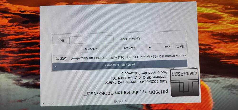

Hello guys,
I just want to let you know that I finally solved the PiHPSDR update problem with the help of Christoph and his new script.
This problem have bring a big discussion because the script specified in any manual was apparently not adequate to update PiHPSDR to the latest new version for the G2 ULTRA.
First problem fixed . Finaly .
73's Michel VE2XK
