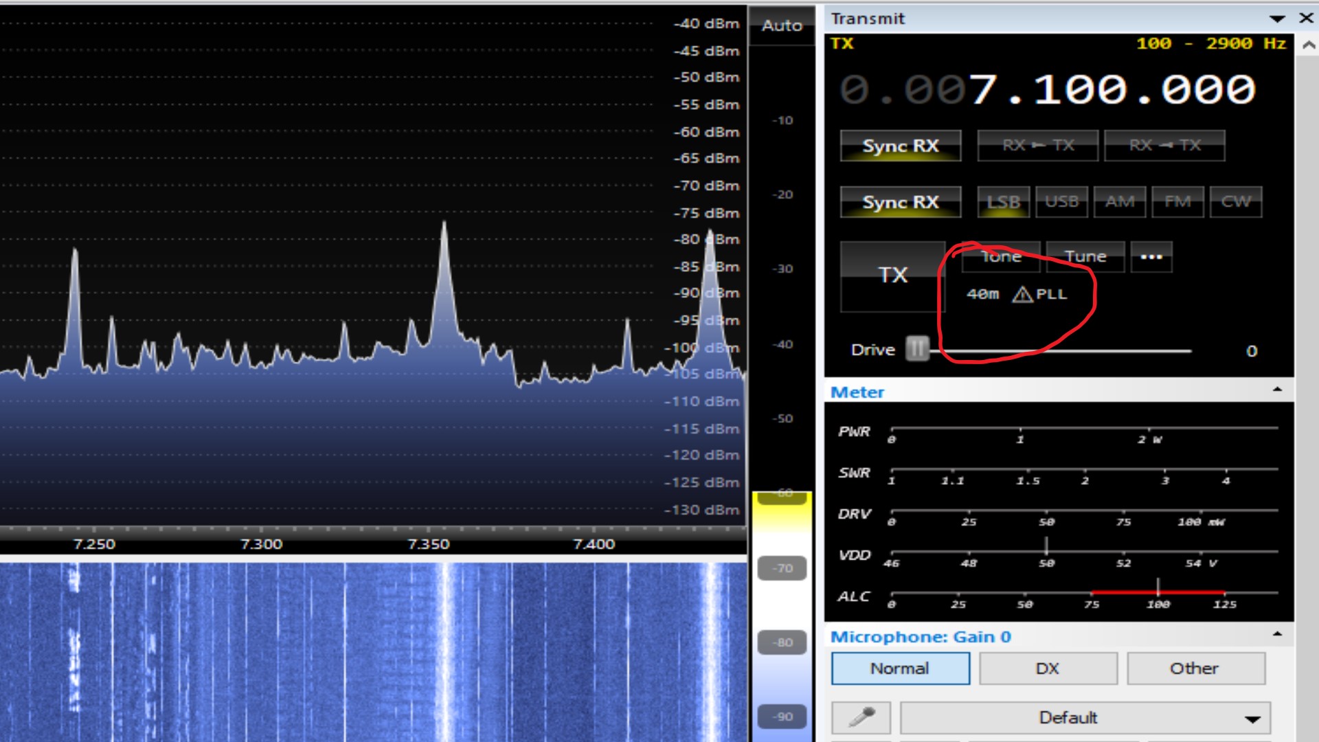

Here is the screenshot of the Transmit side. The Triangle is marked.

I took a quick look at 3.0.5 and also 3.0.6 and found that my 200D would no longer transmit with those versions. I jumped back to 3.0.4 and all was well again. I did not go through all the menu settings other than the Radio Configuration menu, which looked fine, so I don't know what's going on. All I can say is that 3.0.5 and 3.0.6 don't transmit with my 200D but 3.0.4 does. I did not notice the PLL message you circled but if I have a chance today I'll jump versions again and take a look.

Simon released another version on 2/26/2019 (v3.0.6 build 1431) which I just installed. It transmits fine, so perhaps there was something that got fixed as the 3.0.5 versions and the 2/25/2019 build of 3.0.6 would not work for me. I've only been running the latest update for a few minutes but as far as I can tell, the 2/26/2019 release is running great for me.
Note that I do see the triangle/exclamation point - PLL message in the Transmit window of this version but I haven't figured out what it means.
