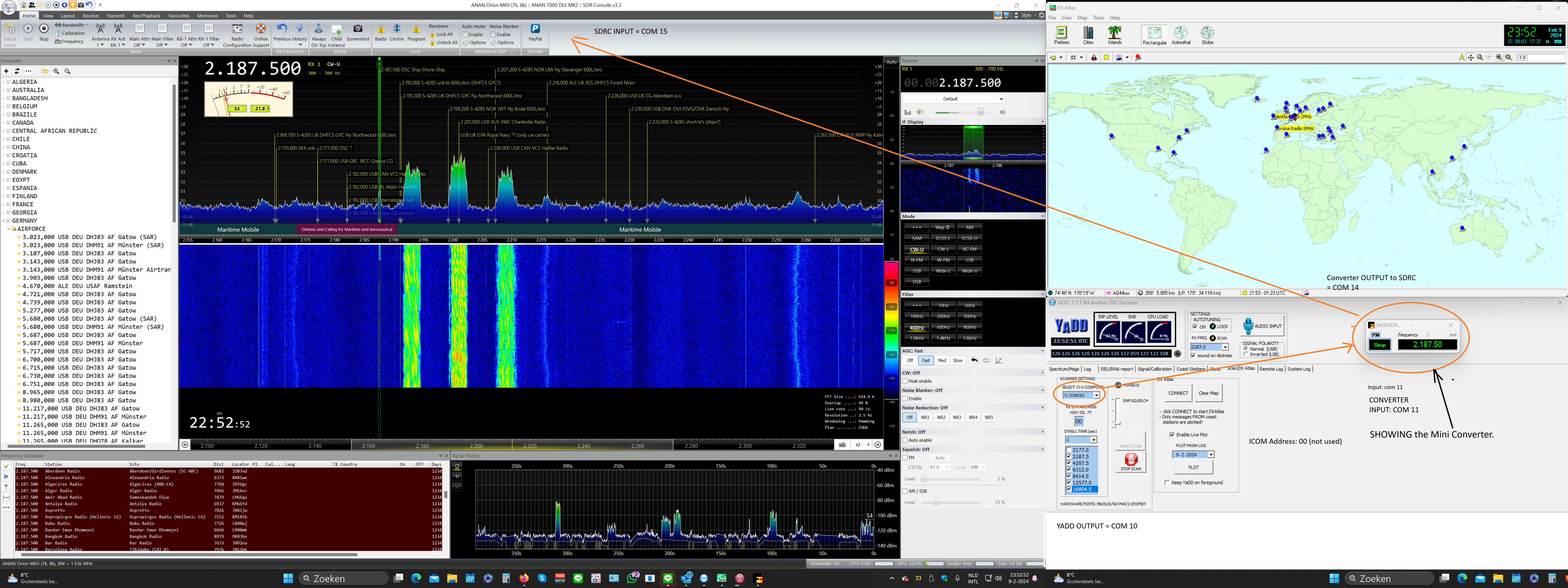

Btw, as an extra, Raimund made a very simple and stripped Mini Converter that needs only a little desktop space.
See attached picture. It's with SDRC but it's only to show the VSP connections.
For now this Mini is only mend for use between Icom --> Kenwood protocols but Raimund is busy updating it for the Yeasu protocol too.
The programs don't need/use OmniRig and the preferred VSC is Com0Com (we did a lot of testing, com0com works flawless)
All you need are 2 VSC pairs, one between YADD <--> Converter and one between Converter <-> SDRC/Thetis
The full Converter has a lot more options, there is help in the program: stop the converter and press the H's in the UI or Troubleshooting.
YADD to Converter to SDRC connection.png (3.64 MiB) Viewed 34037 times
