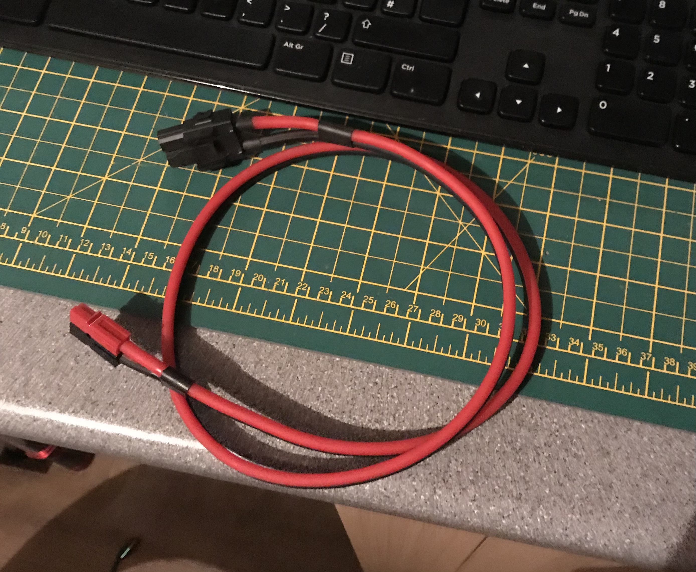

New BNC to PL259 lead made up and all is well. Lesson one learnt.

Like another poster on the forum I noticed that the DC Lead fuse holder was warm. I have never liked the DC lead it is too rigid, has sharp zip ties and is generally of poor quality. So today I made a new one using a flexible silicon rubber cable, omitting the fuse holder (the lead is fused at my Powerpole powerstrip).
Bingo full Power on all bands when using Powersdr mrx, I tried the earliest and latest firmware versions I had.

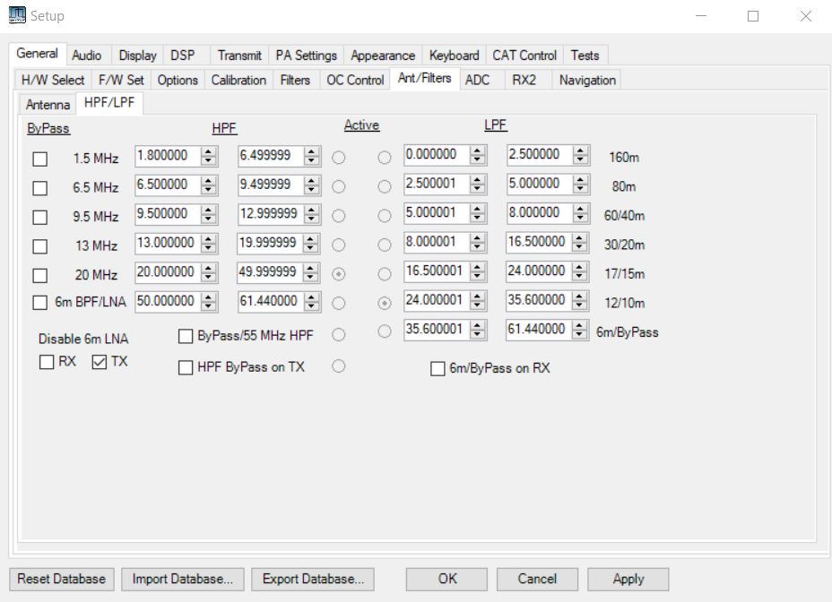

Can you post a screen shot of what Setup > General > Ant/Filters > BPF shows when on 12M?

w-u-2-o wrote:Can you post a screen shot of what Setup > General > Ant/Filters > BPF shows when on 12M?
Screenshot attached as requested.
One thing I noted this morning when playing further:
Even though the Band filter ranges are identical between PSDR & Thetis in my install it does appear that PSDR pairs 12metres with 15metres whereas Thetis pairs 12metres with 10metres.
Or should I say when changing from 15metres to 12metres in PSDR there is no relay click heard whereas when changing from 12metres to 10 metres in PSDR a Click is heard. The opposite applies in Thetis.
Note: When I reset the database in PSDR the Band filter ranges differ from my norm (which matches Thetis) but full power is achieved on every band in PSDR regardless of what the switch points are set at (Custom or Default).
The more I look into this the more confused I become
Cheers, Peter..... G1FXE

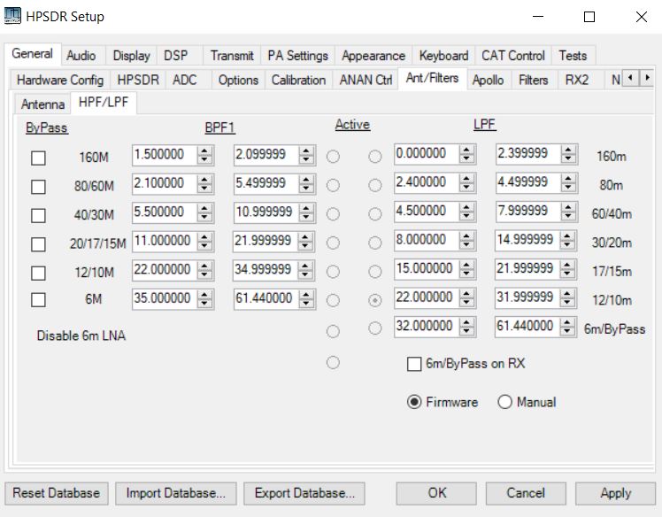

One thing to look at in PowerSDR: you'll note the two settings, "Firmware" and "Manual". In Firmware mode code in the firmware will look at the tuned TX frequency and make its own decision about what LPF to select. In "Manual" mode it uses the table on the setup page to make those decisions. In Thetis it only has "Manual" mode.
You might play with PowerSDR and see if you can get it to mimic Thetis. That might offer a clue.

Scott, yes I managed to get PSDR to mimic the issue with 12metres in Thetis. Selecting Manual on the LPF tab results in the same 'low' power.
The default (with fresh database) in PDSR is that 'Firmware' is selected in which it appears that 12Metres is switched with 15metres resulting in full power on 12metres.
Particularly strange considering I get full power on 10metres. I would have thought an issue resulting in low power on 12 would result in the same on 10 (when in manual) ?
Below is a screenshot of the PSDR default database LPF tab. Frequency ranges are slightly different than Thetis but still don't account for the issue in Manual.
Rgds, Peter.....G1FXE
- psdr default.JPG (75.71 KiB) Viewed 55476 times

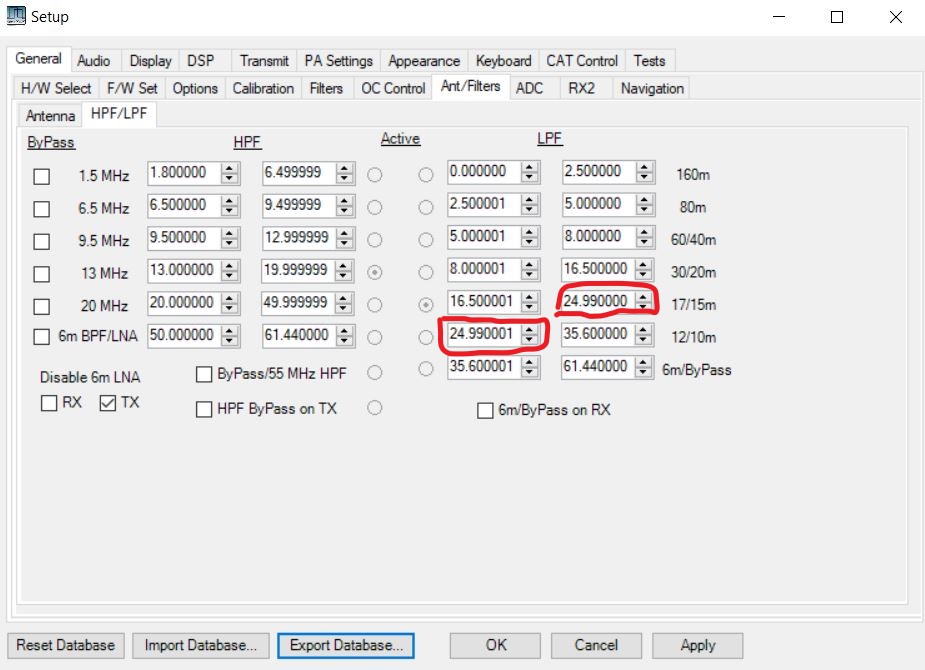

Just a crazy idea: swap the frequency ranges assigned to the 17/15 and 12/10 filters. See what happens.

Unsurprisingly when the upper edge of the 17m/15m range is adjusted to include 12m full power is achieved on 12metres.
Nice to see that when you adjust one band filter upper range the lower edge of the next band adjusts to compensate. IE. I changed 17m/15m upper limit and the 15m/12m lower limit 'changed itself'.
I suppose the big questions is, is this a fault with the manual selection of LPF's (or the range assignments) in PSDR & Thetis, a firmware bug or a hardware issue with the Anan 100d or a combination of the last 2.
My guess is we'll never know. For curiosity sake I might see if I can find the release notes for the historic firmware release to see if Band/LPF assignments are mentioned.
Thanks for indulging me in this head scratcher.
Peter.....G1FXE
- Thetis.JPG (102.87 KiB) Viewed 55408 times
