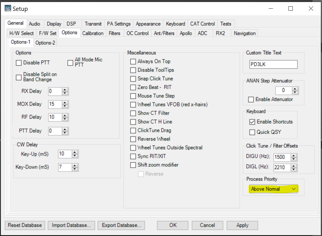

Hello Ron, does your sollution act better (or different) then the Thetis build-in prio option? (see pict) regards, Leon
- Prio.PNG (179.81 KiB) Viewed 69987 times

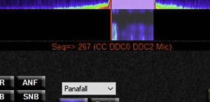

I just started getting this SEQ error msg and is causing dropouts on transmit.
Anyone have thoughts on a reason or fix would be much appreciated.
Thx
Carl
NX5T
Thx
Carl
NX5T
- SEQ error.JPG (58.71 KiB) Viewed 67736 times
