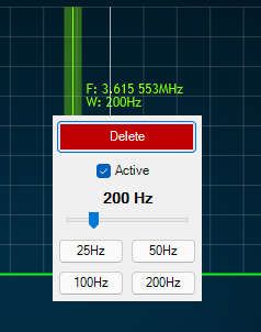

Ctrl right click to add 200Hz
Ctrl shift right click to add 100Hz
Middle mouse to enable/disable a notch
Shift middle to remove
Or +MNF button to add in passband
Drag the edges of a notch if you have enough zoom (although the edges don't highlight right now)
Drag the notch around if you need it moved
You can also right click on a notch to bring up a popup,

Also, hovering the mouse over an existing notch enables the mouse wheel to vary the notch's width.
