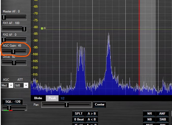

I am new in this Thetis world ;-)
but when I turn over the band I have the AGC Gain at arround 75...if there is a strong station I have to manully turn down to 25 or my speaker explode....
isent there a way to set this leve automatick ???
using Thetis 2.10.3.5
73" oz1ct Ben

Postby w3ub » Fri Dec 29, 2023 1:47 pm
Right click that button.

Postby OZ1CT-Ben » Fri Dec 29, 2023 2:46 pm
w3ub wrote:Right click that button.
Doug
if I Right clik on the ...it go to 102 and hell start up in the speaker :-(
the I clik Right on the "AGC Gain" and a the "Setup/DSP/AGC/ALC" menu was displayed.... I Apply it and OK.....
now the RX is working as a dream :-)
TNX fer help
