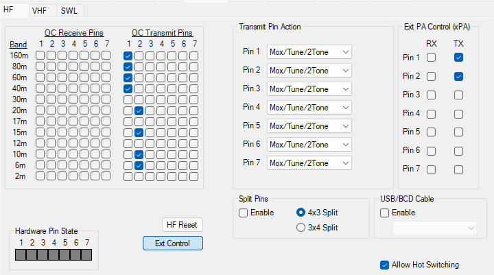

Within Setup/General/OC/HF Control there are possibilities to use the PINs of the OC 9 Pin Connector on the back.
Am I right that with this configuration when I "ptt" 160-40m I will have OC out 1 triggered and for 20/15/10/6m I will have OC 2 triggered?
With this I could VFO A (TX) (using bands 10-20m) trigger PTT on Port A of PGXL and VFO B (TX) trigger PTT on Port B of PGXL.
With Flex ANT1 TX always triggers Port A PGXL and ANT2 TX always triggers Port B PGXL which is more convenient since I do not have to define bands (if the above works) to TX ports.
If there is a possibility to poll via CAT which VFO has "TX active" I could just switch the "PTT Out" of the Anan to the respective port with node red triggering a relayboard. Therefor I would have more flexibility.
This would also account for the "-60dBc output signal" ports at the PGXL since the feedback has to come from the transmitting port. I thought of just coupling it with -3db wilkinson power divider so that I only have one feedback line to the Anan => thoughts?

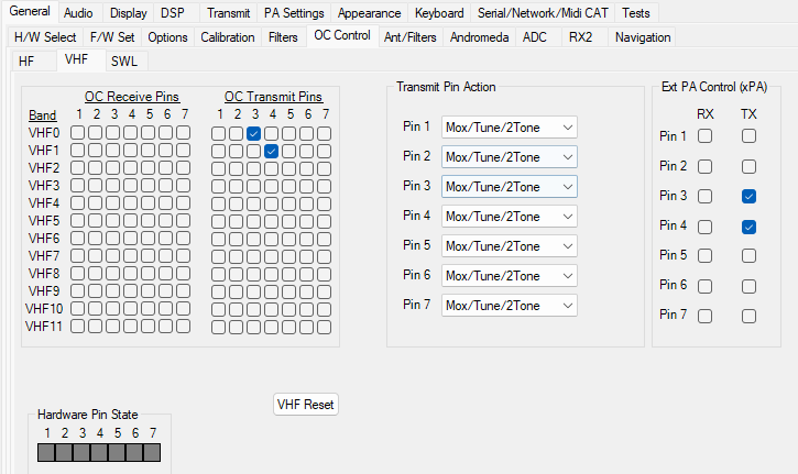

Withhin Thetis I configured XVTR and assigned buttons 0/1 (VHF/UHF). I see that Setup/General/OC/VHF I do have a matrix as well. Are the "Bands" linked to the XVTR setup? So that when in VHF/UHF mode I can trigger specific OC Pins to have PTT on my transverters or will it be defined by the input frequency (28MHz)?
