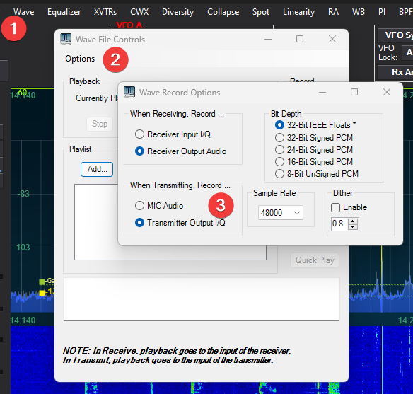

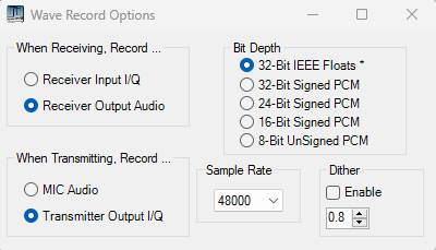

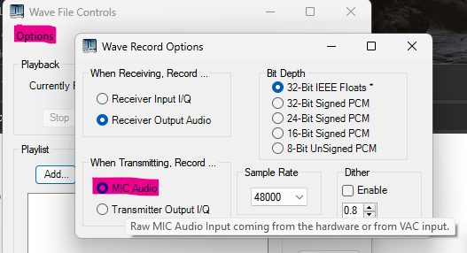

Cant seem to find the record options control ? What tab is it located on please ?
Re: Transmit Record ability lost
Tony EI7BMB wrote:Cant seem to find the record options control ? What tab is it located on please ?
