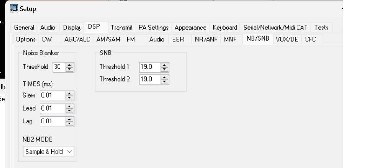

Re: Thetis NB 1+2 not working
Postby Tony EI7BMB » Thu Nov 21, 2024 7:56 pm
What NB Threshold value are you using ?
attachment=0]Untitled.jpg[/attachment]
mhertkorn
Posts: 10
Joined: Tue Jul 11, 2023 9:20 am
Postby mhertkorn » Thu Nov 21, 2024 9:02 pm
The same on your screenshot.
Postby Tony EI7BMB » Fri Nov 22, 2024 8:31 am
Perhaps try a lower value to see if it has any affect.
