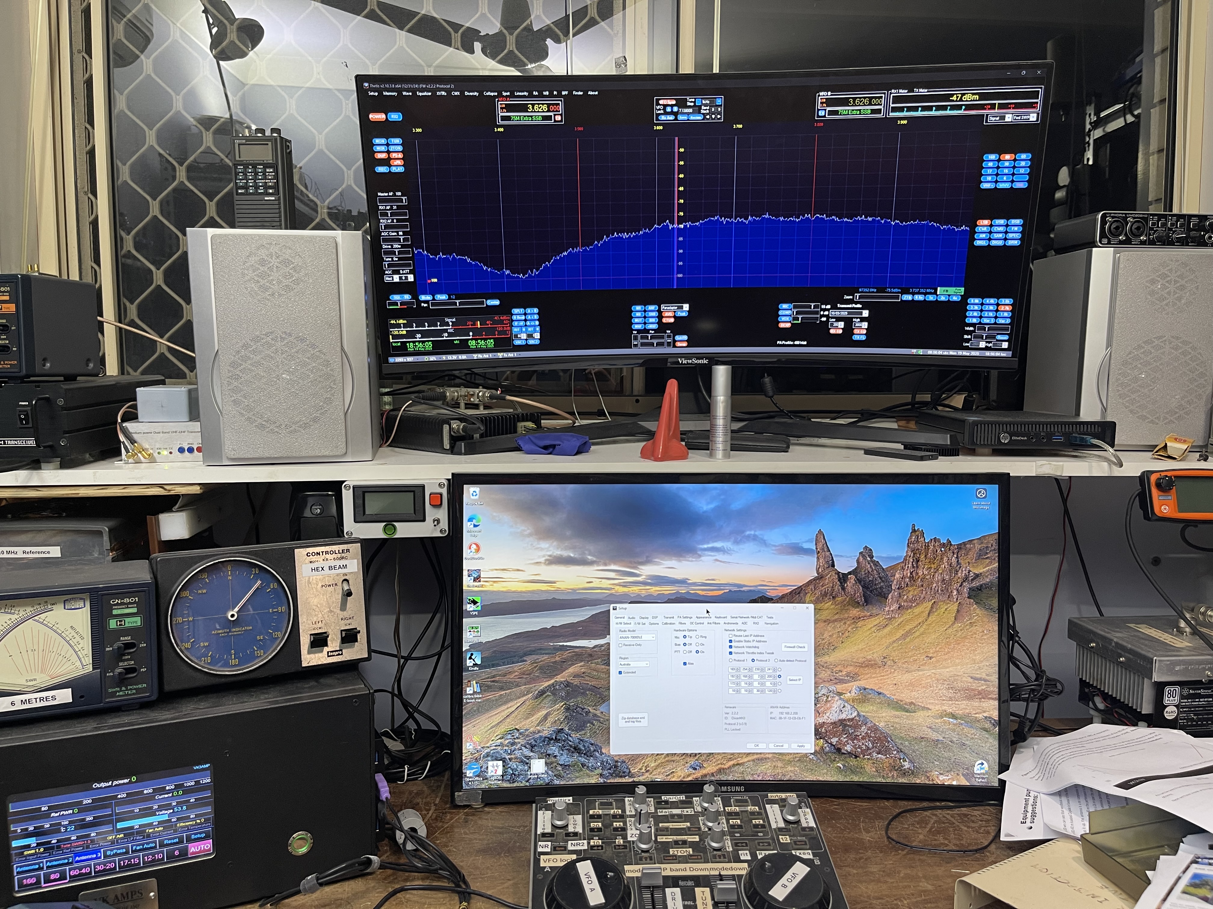

What I’m doing is to have my big wide screen driven only by the ‘radio’ PC and Thetis. A second smaller screen is connected to both Thetis and my ‘shack’ computer using a HDMI switch box with the default to the ‘radio’ PC. I have set it up so that my mouse can travel off the RHS of the big screen and on to the LHS of the second screen. I have further used a usb switch box to switch the mouse and the keyboard between the two computers as required with the switch on default to the ‘radio’ computer.
When I turn on the ‘shack’ computer it takes over the second screen and I can then use that to do ‘housekeeping’ and other ham radio programs including HRD.

That's pretty complicated. Why not run everything on the radio PC and simply add the second screen permanently to that PC? HRD does not require very much CPU at all, it should not affect Thetis in any way. You can easily try it to prove that's the case.
Also, with that arrangement of screens, why not have the mouse move across the bottom and top edges of the two screens?
Re: setup refusing to open window
Thanks Scott I didn't realise that I could move the second screen under the first one and thus enable the mouse to go straight up and down between screens...thanks ! That shows how familiar I am with window 10/11.
