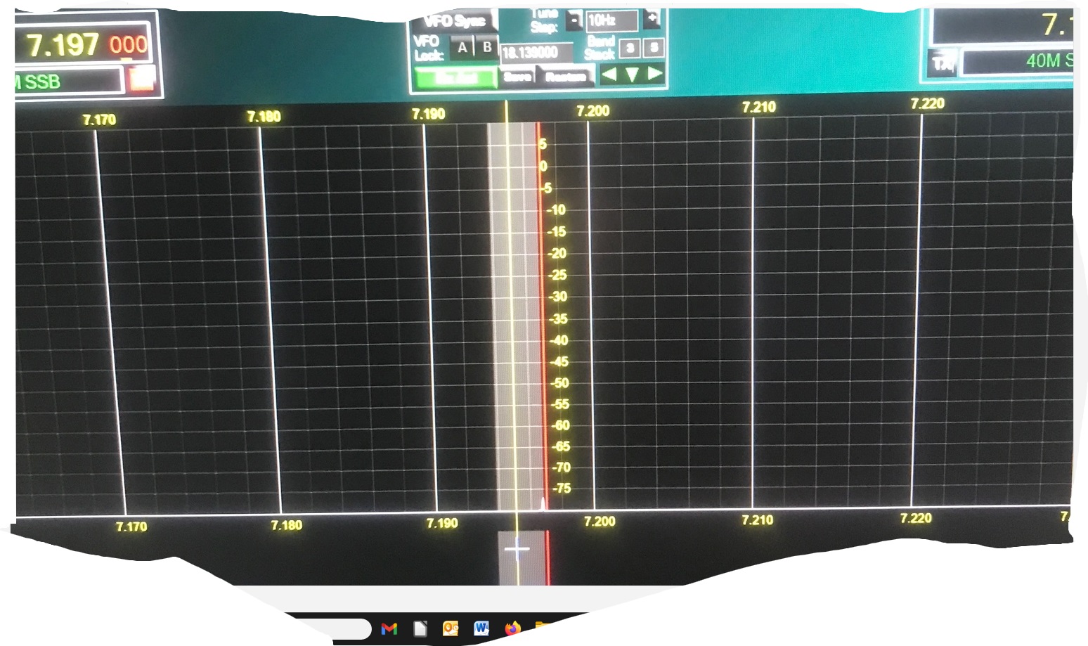

Being a relative new operator to thetis only 2 years I am trying to establish how to toggle on the numbers beside the cursor when in TX mode to enable me to see what my IMD levels are, please see attached jpeg from a friends screenshot.
Any assistance greatly appreciated. I am using Thetis 2.10.3.6X64 dev_2
my anan is a 7000 MK11 DLE
Thanks for reading, Brian

I'm not really clear on what you're asking, because your friend's screenshot doesn't have any numbers beside the cursor.

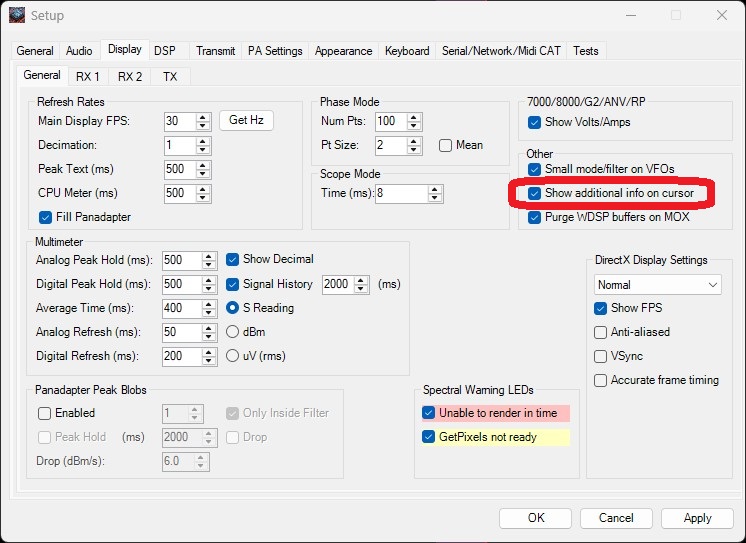

Regardless, here's where to toggle the numbers I believe you're asking about.

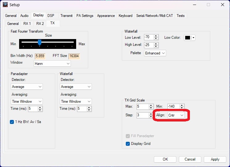

Hi Mark, thanks for reply, the No's I am referring to start at top 5 and finish at bottom -75 to the right hand side of vertical cursor in tx mode
tried toggling on the show additional and no did not change anything.

Postby K1LSB » Thu May 29, 2025 10:38 am
Here ya go.

Postby vk2je » Thu May 29, 2025 11:35 pm
Thank you so much problem solved.
