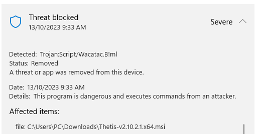

Unfortunately, I can't download 2.10.2.1.
Windows defender has detected Thetis 2.10.2.1 as a virus.
Screenshot 2023-10-13 093637.png (17.15 KiB) Viewed 39365 times
73, Phil - VK1HX

Re: Thetis 2.10.2 Final Now Available
Postby vk1hx » Thu Oct 12, 2023 10:50 pm
Getting the virus detection on another PC running Windows 10. The main PC is running Windows 11 PRO also getting the virus detection.
73, Phil - VK1HX

Postby ramdor » Thu Oct 12, 2023 11:01 pm
I have removed it from the release, completed a full virus check on my system, nothing. Ran virus total on the msi, nothing. Re-uploaded. Perhaps a glitch in the matrix. Either uploading or downloading caused some sort error that resulted in a false positive. Very odd.
virus total scan on the msi
https://www.virustotal.com/gui/file/cee ... fe32c50ec/
The trouble is, these days you get some odd byte order in a legit file and boom, it becomes flagged as a virus, a false positive. Price we have to pay I guess for non-signed installer.

ramdor wrote:I have removed it from the release, completed a full virus check on my system, nothing. Ran virus total on the msi, nothing. Re-uploaded. Perhaps a glitch in the matrix. Either uploading or downloading caused some sort error that resulted in a false positive. Very odd.
Very good, yeah I can't explain it either. I'll try the download again. Cheers.
73, Phil - VK1HX

Postby vk1hx » Thu Oct 12, 2023 11:13 pm
Just redownloaded the update. Clear of Widows Defender virus detection.
All good, thanks for updating. Now to test.
