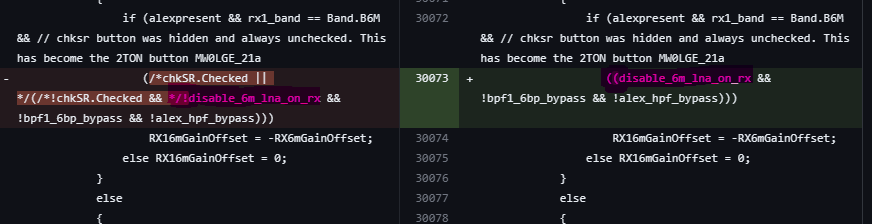

But unfortunately I have a problem with the 6m band.
After installing the final release, RX on 6m band is about 20db lower.
Going back to pre-release 5 cured the problem.

Postby Tony EI7BMB » Sun Dec 24, 2023 8:41 am
I am seeing the same here on 6m

UPDATE: fix to 6m lna. Same version number but titlebar will show 'u1'. Please test.
The spaceship would now be heading the wrong direction as a damn pesky ! was removed in the code clean.

U1 looks good here Richie , even have an E's opening on 6 to test with :-)
Tony EI7BMB wrote:I am seeing the same here on 6m

Tony EI7BMB wrote:U1 looks good here Richie , even have an E's opening on 6 to test with :-)
Thanks for the quick test. Yeah there were thousands of lines of code junked in the project. I should have probably run a pre-release-6 :oops:
