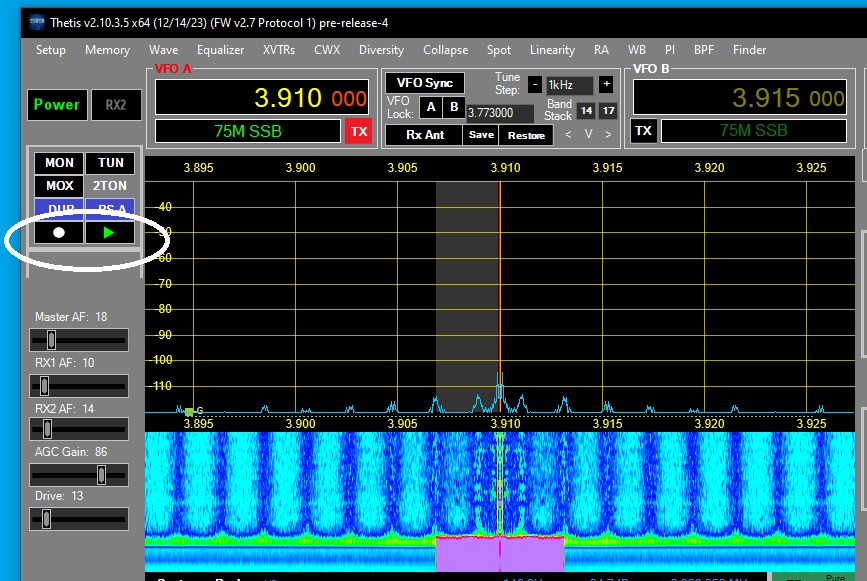

What am I missing? I used to be able to record and playback my own transmissions using the record and playback on console, not bringing up the WAVE function.
It still works to record and playback received signals, but on my own, only get some very low level garbling and odd pictures on waterfall. Latest Thetis and using audio in/out as shown. This was very convenient to get quick check on my audio into dummy load.
Using other means, I know my signal is good and looks fine in display when transmitting, just not getting captured correctly for playback.
Self Recording.jpg (196.02 KiB) Viewed 12010 times

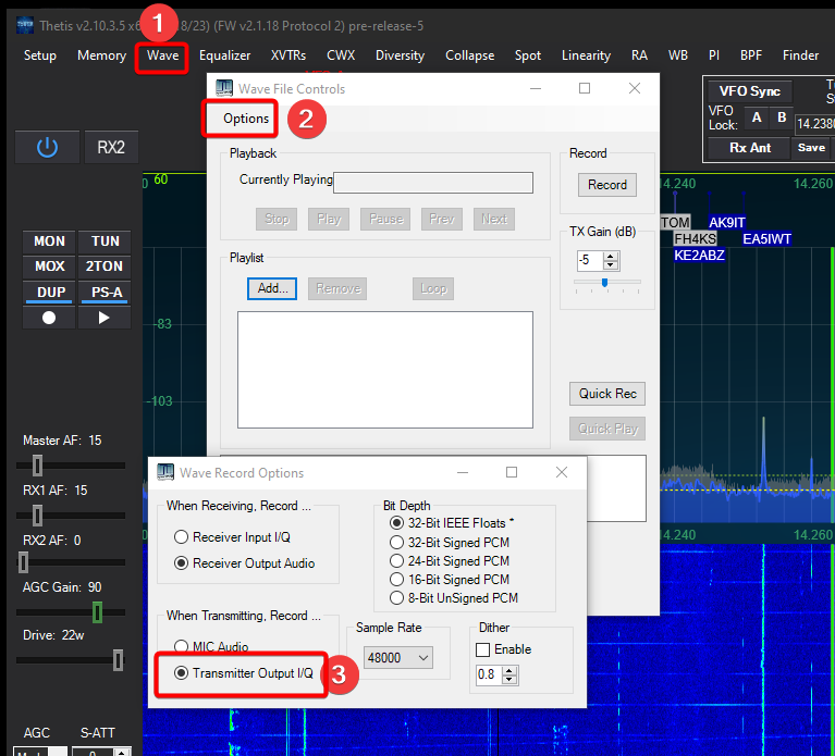

I am getting the same gibberish as W4BF is reporting. I can hear my audio in the background, but garbled.
I am running P2 with the latest u1.
7000 mkll Thetis v2.8.11 21k3
P2_v2.0b
Re: Receiver Recording
Postby oe3ide » Tue Dec 26, 2023 5:24 pm
LarryW wrote:I am getting the same gibberish as W4BF is reporting. I can hear my audio in the background, but garbled.

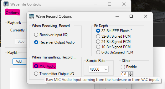

Do you have this set?

Postby w4bf » Wed Dec 27, 2023 11:16 am
That fixed it ! Thank you.
LarryW
Posts: 68
Joined: Thu Apr 09, 2020 11:19 pm
Location: Garden Valley Idaho
Postby LarryW » Wed Dec 27, 2023 7:35 pm
That also fixed it for me too---Thanks Ernest!

NO, This does not fix the issue. This records the I/Q quadrature output, NOT THE TRANSMITTED AUDIO. This is insufficient and incorrect as a representation of the TX AUDIO.
Posts: 1581
Postby ramdor » Sat Dec 30, 2023 6:59 pm
rdwing wrote:NO, This does not fix the issue. This records the I/Q quadrature output, NOT THE TRANSMITTED AUDIO. This is insufficient and incorrect as a representation of the TX AUDIO.
I made some changes and have built a work in progress build. Please try https://github.com/ramdor/Thetis/releas ... 10.3.6-dev
