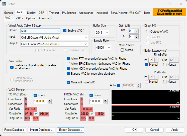

I had to reinstall my Thetis as I had done something and had no idea what I had done, so it was easier to perform a reinstall.
I have an issue where WSJT-x appears to send a carrier in Thetis but after an hour or so I check on pskreporter and I have not transmitted at all.
I have some screenshots but for the likes of me I am unable to see what is happening.
I did use the Measuring and adjusting guide at viewtopic.php?f=13&t=3574 before posting.. :)
I am hoping someone is able to help me, Thank You.

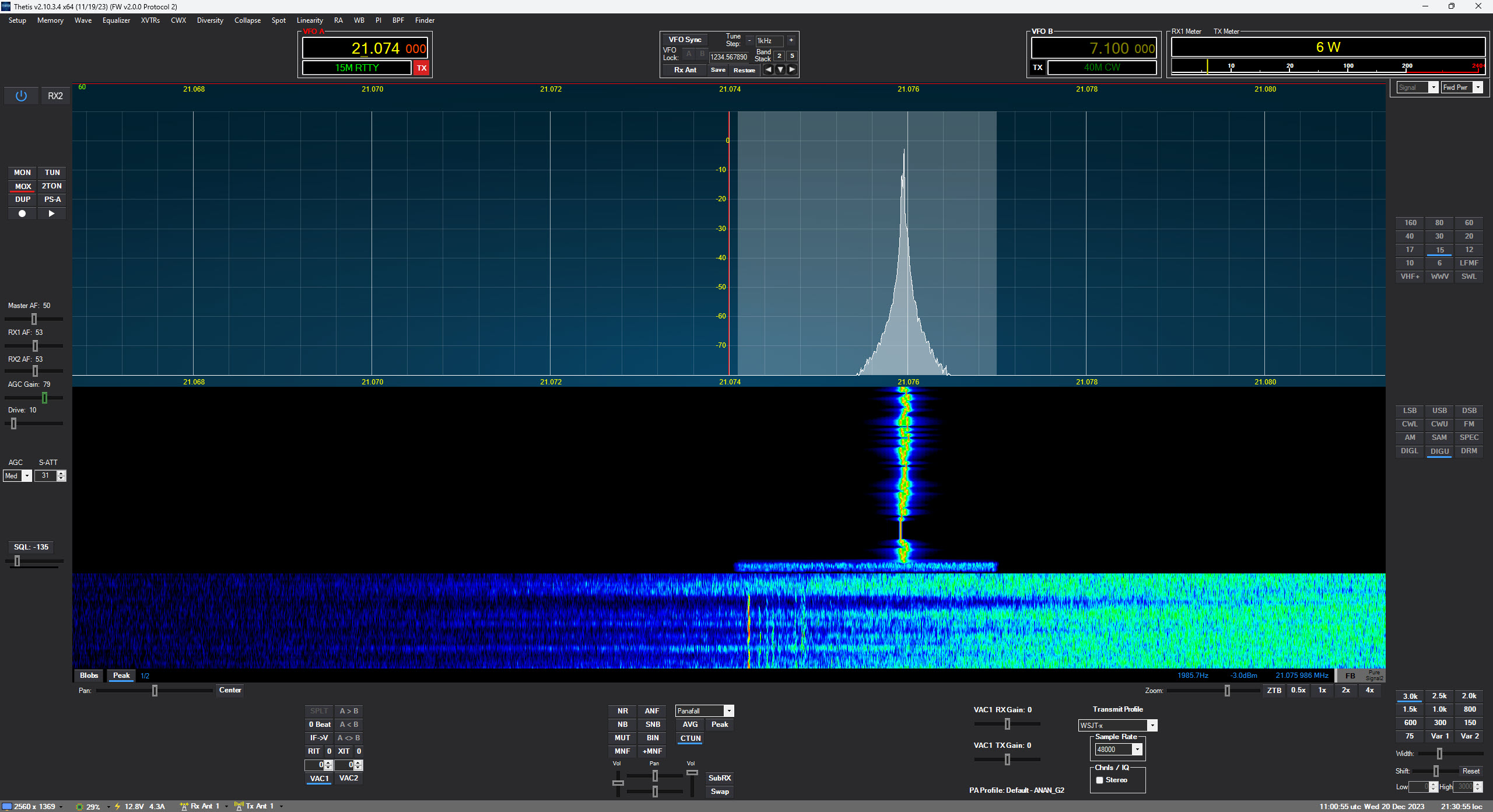

Weird carrier from WSJT-x
Wsjt-x modulation.jpg (694.43 KiB) Viewed 7343 times
Thetis Audio Settings

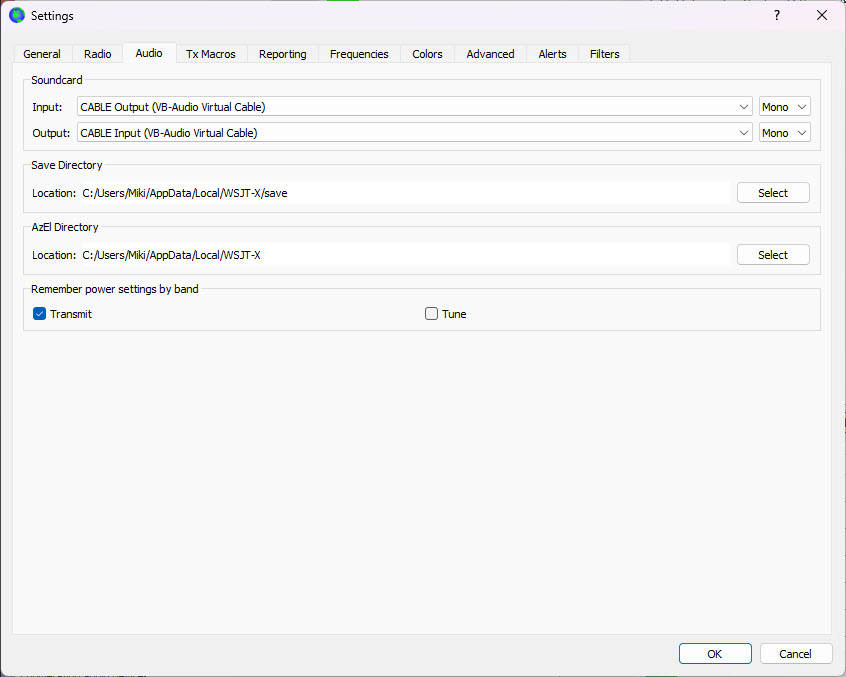

WSJT-x Audio Settings

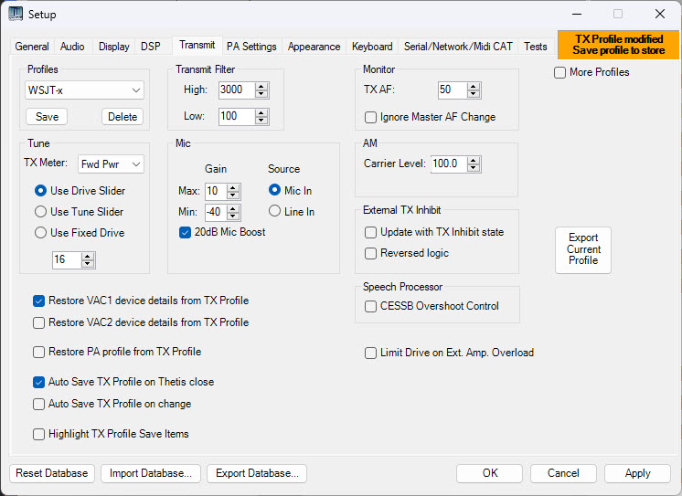

Thetis Transmit Settings
WSJT-x COM Ports

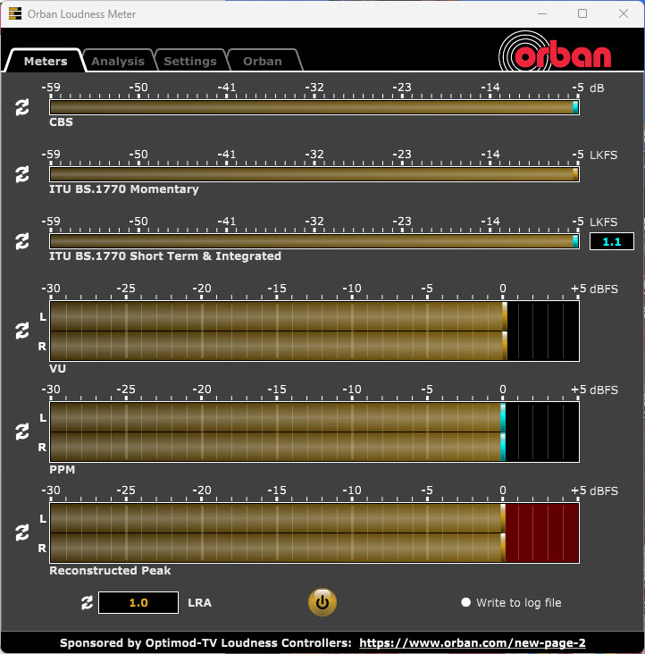

Orban

As you can see in the first pic, its a weird signal, if you call it that...

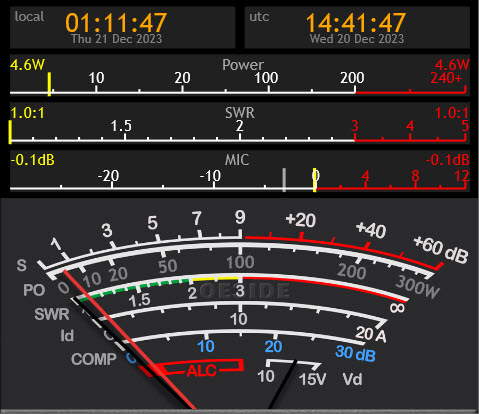

audio levels into thetis ok? what is the mic meter saying when it txs?
Miki
Posts: 7
Joined: Fri Dec 01, 2023 3:47 pm
Location: Adelaide, Australia
Re: Thetis not transmitting with WSJT-x
Postby Miki » Wed Dec 20, 2023 2:43 pm
mic meter at -0.1dB
Screenshot attached..
Posts: 1581
Postby ramdor » Wed Dec 20, 2023 2:55 pm
that looks fine. Perhaps switch on DUP and see what the TX is like. Also use MON to 'hear' if it sounds ok. Only other thing is perhaps for some reason it is off frequency and outside the rx width of other stations?

It sounds like there are 2 tones, I have recorded it so you can blow your ear drums :lol: :lol: :lol: :lol:
DUP is on and MON does not do anything.

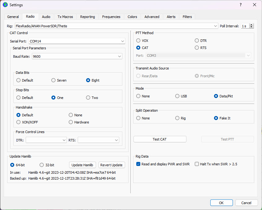

Please post screen shots of WSJT-X both receiving and transmitting.

Postby Mike_N1JEZ » Wed Dec 20, 2023 4:21 pm
It sounds to me like there are two signals in there very closely spaced...

In File/Settings/Advanced make sure you do NOT have Tone Spacing X2 or X4 checked.
Posts: 1581
Postby ramdor » Wed Dec 20, 2023 4:44 pm
w9mdb wrote:In File/Settings/Advanced make sure you do NOT have Tone Spacing X2 or X4 checked.
yeah that is probably it Mike ! the audio does seem to be 100+hz of bandwidth

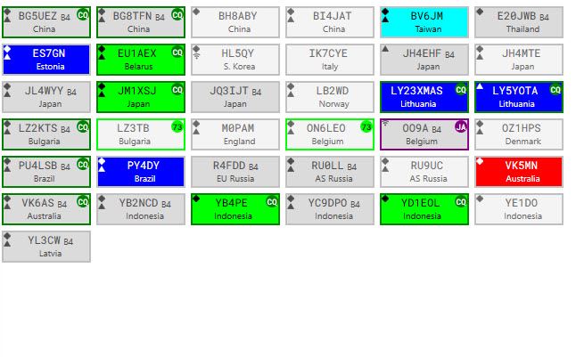

Once I have done that, I can hear it through my speakers, I can even see my self in JTAlert,
It seems to be looping somewhere..
