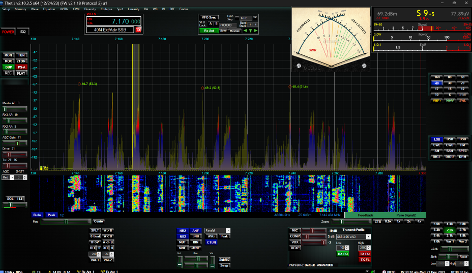

Postby rbduck » Wed Dec 27, 2023 3:49 pm
I have something that has just recently started. When I open Thetis, the terminator between the Panadapter and Waterfall is located about 25% off the bottom of the GUI. I've tried what I thought was the obvious solution to the issue. I've also went back and listened to the past few of Richie's videos. What do I have to do to save to move the position upward to the middle of the GUI? I know how to move it. I just need to know how to save it.....

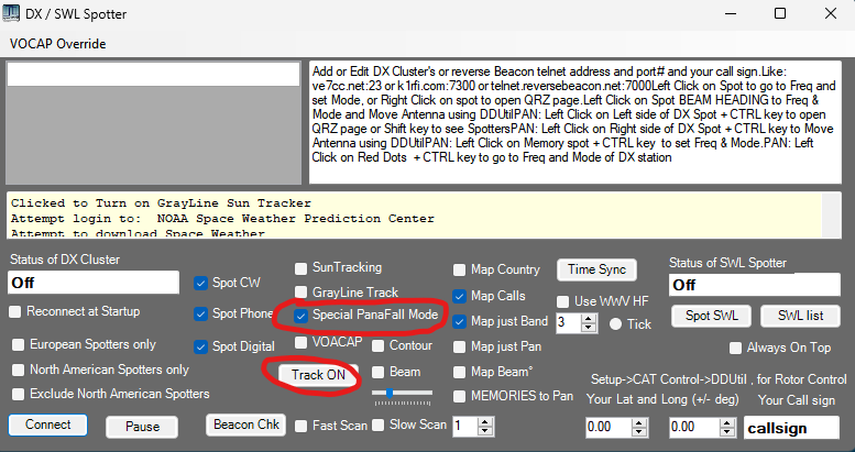

Check that that special panafall mode is unchecked, in the spot form. It will move like that and override the position if checked and Track is ON.

ramdor wrote:Check that that special panafall mode is unchecked, in the spot form. It will move like that and override the position if checked and Track is ON.
That was absolutely the information I needed to correct my setup. The "Special Panafall mode" box was enabled. Thanks Richie for the fast reply and also thanks for the cmASIO video. That cleared a few things up for me as well.
