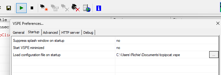

vspe will re-connect/auto-connect no problem as long as it is running and has the correct config. Thetis needs to be configured to start the tcpip cat server obviously. You can save out the vspe config, then use it in the startup config, shown below.

qst

Thank you very much for the next video. I had an older version of VSPE that worked unstable. Today I installed the latest version and TCPIP in VSPE. After starting Thetis, it connects and works properly.
