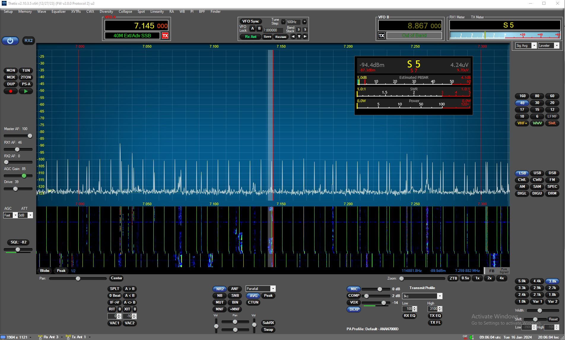

Started Thetis v2.10.3.5 this afternoon - appeared to load normally, but when I hit the 'power' button in Thetis, it took much longer to hear the relay click and the panadapter to start, and then I saw this on 40m:
Posting here, because starting up with a blank database, everything seems normal. I poked around thinking a filter setting may have got screwed up, but couldn't resolve it with my original database file. Prefer not to start over from my last backup - any suggestions where I could be looking?

If you select a different empty Rx antenna port is it still there? That will tell you if it's in the rig or in the antenna.
And what does the wideband display look like?
Unplug MIC
8KHz interference is not real common but others have seen it from different equipment.
https://gearspace.com/board/so-much-gea ... crazy.html
If this was in the audio space IPhone has a nice app called Audio Spectrum Analyzer by Vlad Polyansky -- does cost $30 for one time charge but does a really nice 20Khz wide spectrum display that you can point with your mic around the house to identify audio interference.
This appears to not be an audio interference though as it is 8kHz intervals but sits at 20Hz on the LSB side.
I assume if you change frequencies the noise frequencies do not change. So hopefully the wideband display is informative.

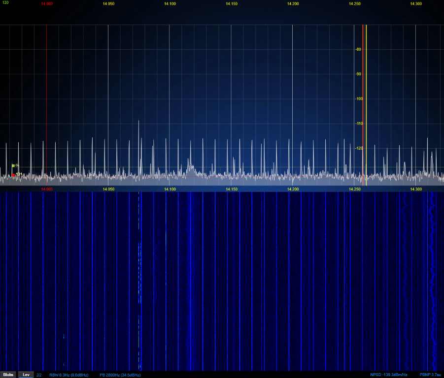

What about every 10 kHz? A few months ago I've started getting similar interference, not from my house so it will be tough to track it down.
Screenshot 2024-01-16 205844 (Medium).png (635.11 KiB) Viewed 6821 times
Viewed on another radio you can get a better picture.

Is that with the antenna disconnected?
rdwing
Posts: 105
Re: Suddenly slow to power-on and 'apparent' RFI
Postby rdwing » Wed Jan 17, 2024 7:03 am
No, only with the antenna connected.
w9mdb
Posts: 465
Postby w9mdb » Wed Jan 17, 2024 2:32 pm
So no noise with antenna disconnected?
In that case time to suspect a power supply somewhere -- you have 8KHz intervals going on which sounds like a switching frequency.
You should be able to find it with an AM radio tuned off-station.
Maybe a solar invertor recently installed in the neighborhood?
