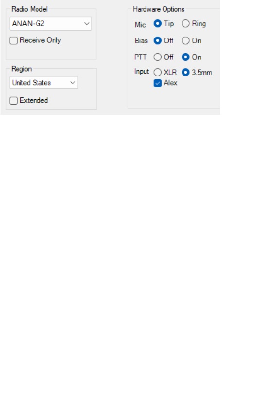

I have received a new G2. Everything works fine except the following:
PTT works fine in PIHPSDR and SDR Console. However PTT does not work in Thetis. Mox will key up transmitter but PTT does not. Are there any settings that I might be missing in Thetis.
In General settings I have PTT enabled. See attached

Postby oe3ide » Tue May 07, 2024 10:33 am
What do you have here?
73 de Ernst
P.S. You can use the menu "Finder" and enter PTT...so you will find all settings related to PTT.

You haven't said how your mic is wired. As drawn, the PTT will be on the "ring" connector but should work.
You can test mic connections including PTT using the audiotest application - see the manual for details.

Postby KC9RF » Wed May 08, 2024 3:14 am
Ernst
That was it.
Disable PTT was on. I looked at many settings but missed that one.
Appreciate the help.
