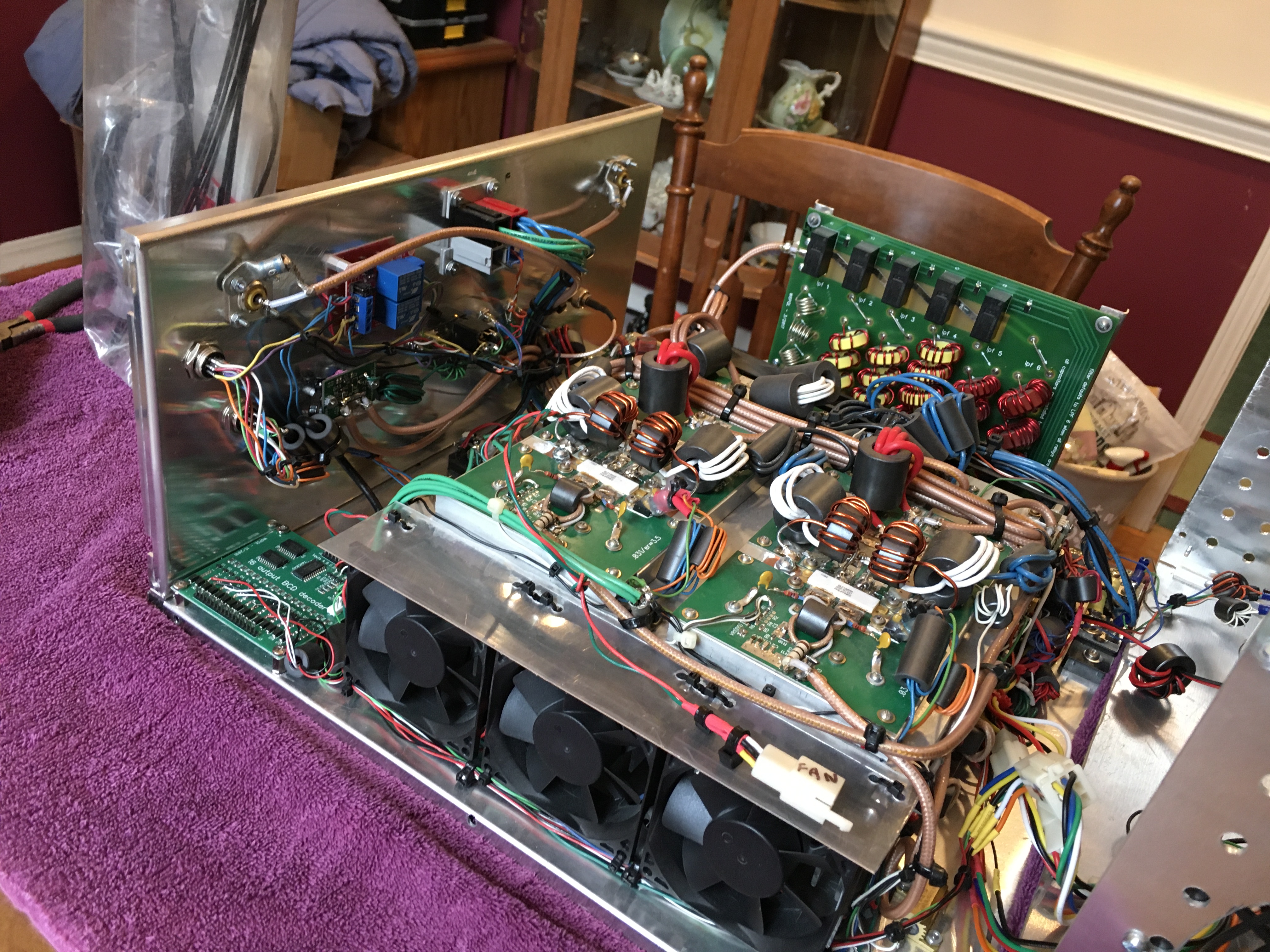

I know this is different from the usb - relay setup but another option is using the OC outputs with a bcd board. I use one supplied by W6PQL, works very well with the Anan. Hope you get it worked out. I added the photo of the board (lower left side), in my amp.
73’s

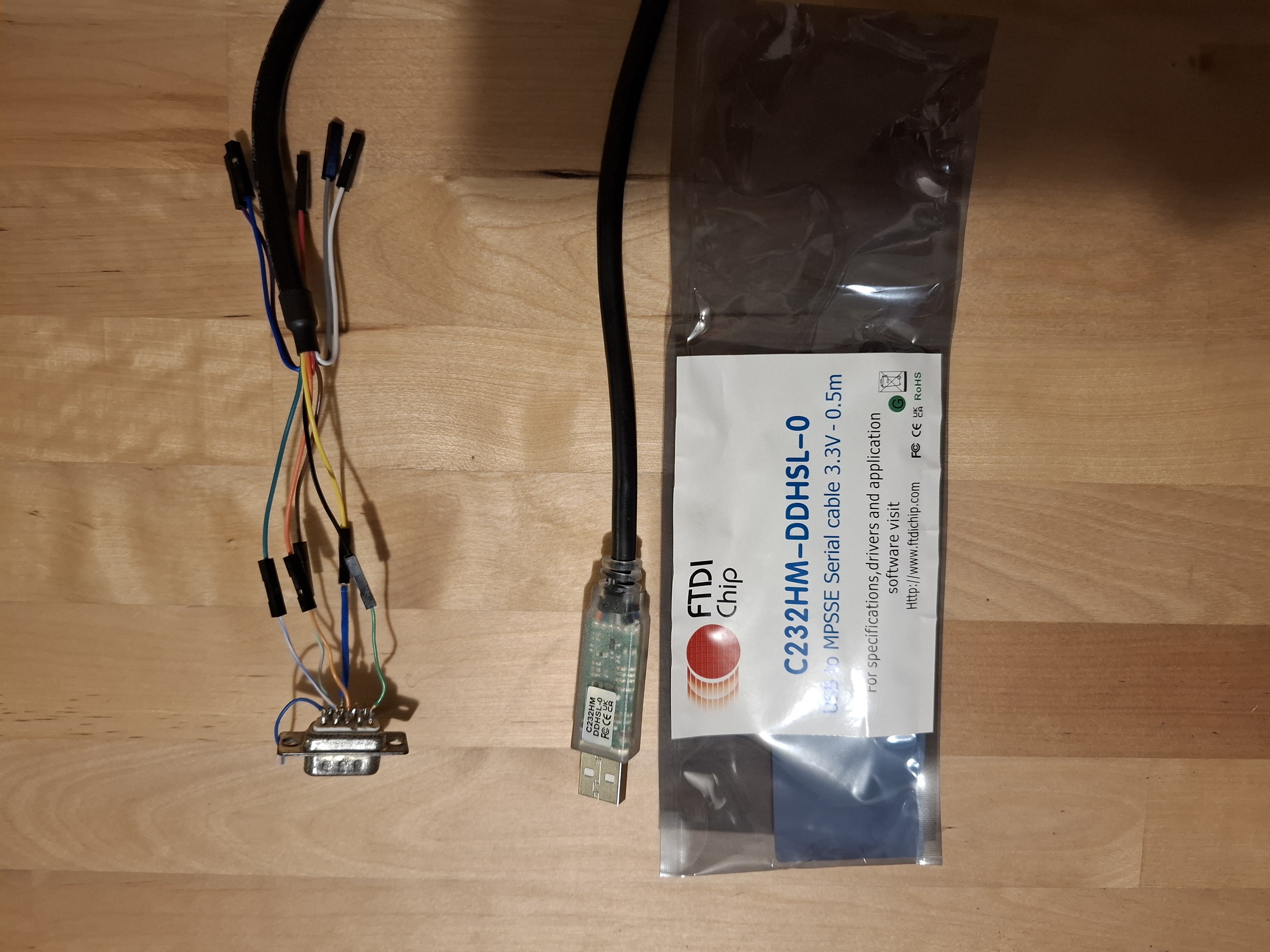

Reporting back that I can control the VK-AMP by checking the USB/BCD cable option. PC USB to Amp DB9 for band control.
This provides an alternative to making a OC cable ANAN to Amp for band control.
I used this FTDI cable
FTDI-DB9 cable.jpg (3.44 MiB) Viewed 2893 times
