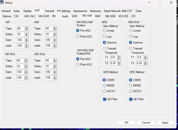

Hi
NR2 seems to have stopped working. I have a feeling I may
have changed one of these settings.
Can somebody please share there’ settings or point out which
setting should be adjusted.

There is nothing wrong with those settings. However, the "trained" mode of NR2, new in this latest version, is far superior to the Gamma mode. Nevertheless, the Gamma mode should be easily noticeable when NR2 is enabled.
You do have NR2 enabled on the main UI, right? ;)

Thanks, yes :) Well I restarted Thetis and it is working again. Odd. And you are right, the trained mode is better but unsure about that on weak signals.

For weak signals you have to set properly T1 and T2 thresholds. With default values in SSB the voice is cut.

Thanks. So is it a case of listening to a signal whilst adjusting? Or do you have any figures I can start with for G2 ?

I don't have a G2 but FWIW here are my settings.
