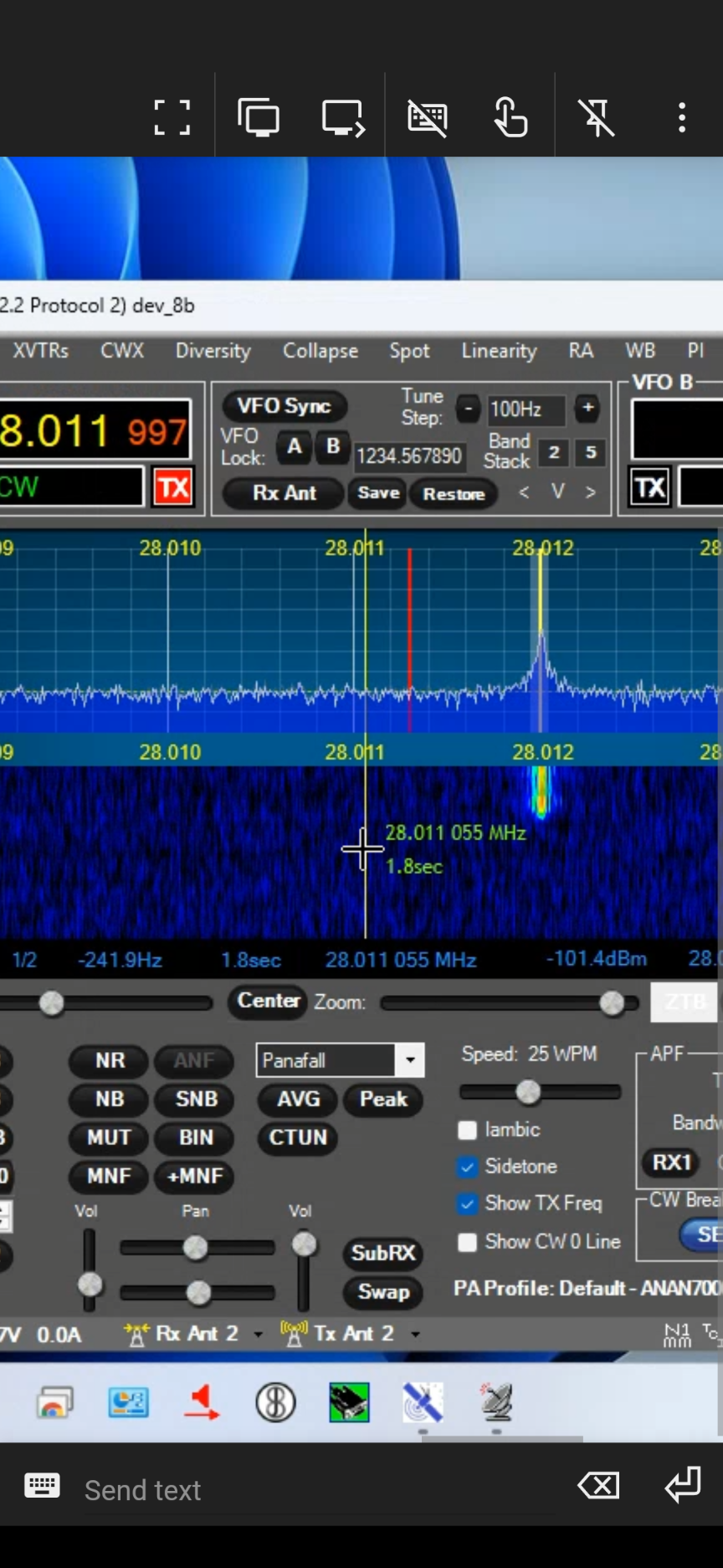

During the big CW contest, using N1MM and the multitude of function keys, there were a few times where I would select a function key intended for N1MM but my Thetis screen was highlighted so pushing the function key would do "something" to Thetis. At one point, it displayed the frequency when the mouse was hovered over the display. I, for the life of me, have no idea how that got turned on and then again, it got turned off. I've attached a picture to show what I'm describing. I actually like seeing the frequency like that when I hover over the waterfall because if I'm working a hot DX and want to split, I like to see just where I am on the spectrum, frequency wise.
Can anyone point me to where this gets turned on or off?

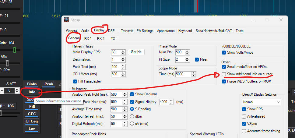

Right click the "Blobs" button and enable "Info".
It's kind of subtle, unfortunately :(
Screenshot 2025-01-09 064247.png (87.8 KiB) Viewed 4012 times
